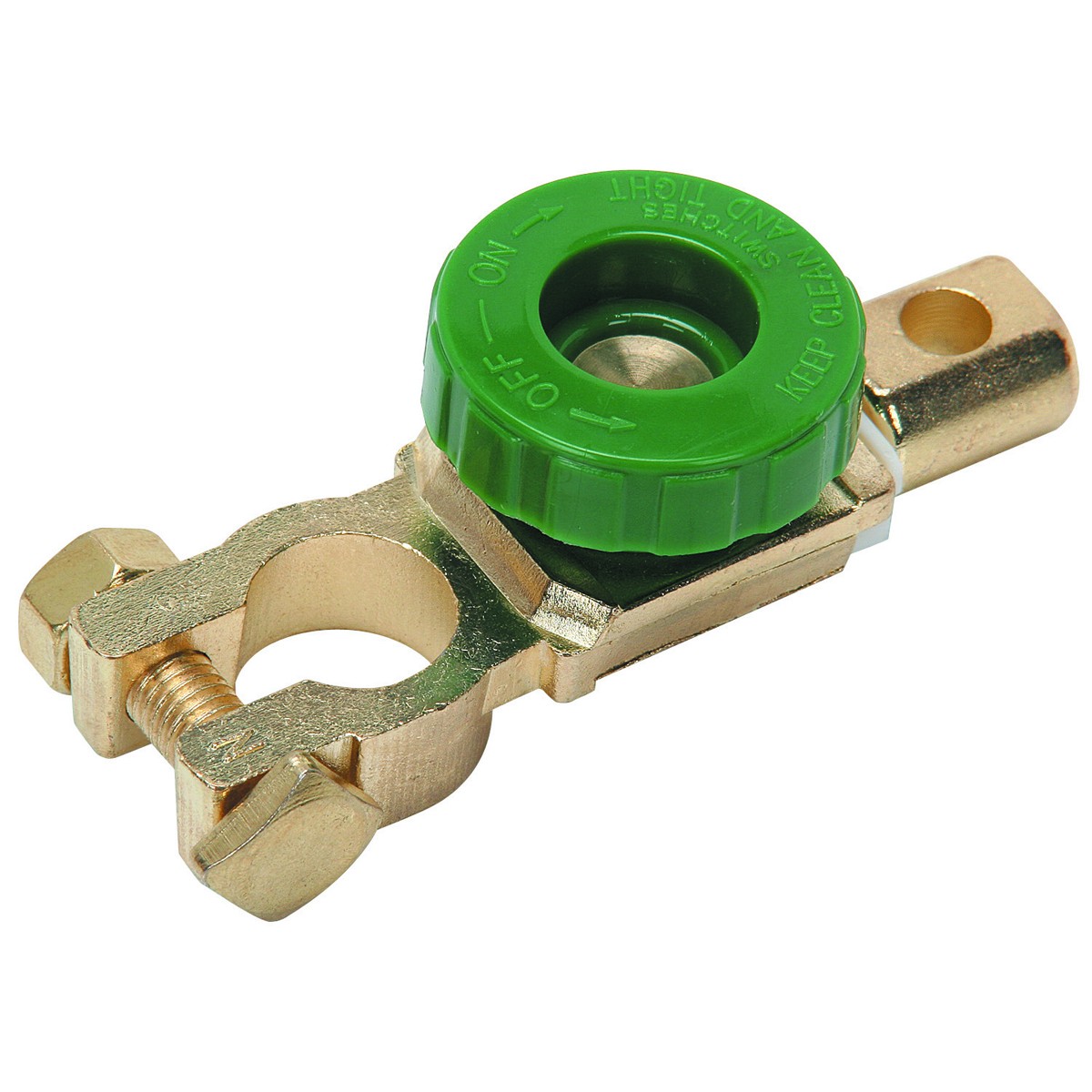

 My son used one on his 81 RX7 after the fire, caused by a shorted map light hot wire. It's use at that time was to prevent another fire while it was sitting after repairs. After a few months of both fretting and confidence building, we took it off. It worked very well. I did notice that if it wasn't screwed down very tight there was a loss of voltage. As far as theft prevention, it's cheap and effective. Just take the green knob off. It can be defeated with a jumper cable though.
 To correct the memory loss in his stereo, we disconnected the radio power wire from the harness and ran a fused wire with a ring connector from the battery terminal to the radio hot wire. Pretty basic and quite ugly until it was secured and hidden with flexible loom covers. A new battery cable with an extra wire would have been a better option.

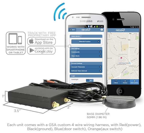

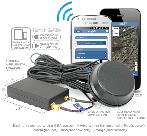

Hi Guys,
I am one of the principals of www.geoskyalert.com we provide exactly what you are looking for with some additional benefits, this is a partial list:
1) We provide an anti-theft recovery GPS tracking solution that runs on an App on your Apple or Android device that will allow you to look at where your vehicle is at any time
2) We monitor your battery, so if your battery drops below 10V for more than 10 seconds you will get notification via text or email
3) Our equipment features an internal backup battery that is rechargeable so even if power is disconnected from your vehicle you can still track it.
4) We provide history of where your vehicle has been so for teen drivers you can monitor where they have been
5) We also provide directions from where you are to your vehicle.
6) Our system has two additional trigger wires that can be tied into any electrical switch or a relay for direct notifications to your mobile device
7) We use Google Maps with street view and other features of google maps to quickly locate where your vehicle is
8) we update the location of your vehicle in real time.
9) Our solution works internationally, we do not see borders and will roam to most carriers. We have equipment in Europe and South America.
We have been in business for 4 years doing Fleet tracking but built our own solution when we have friends losing their cars and trailers and so we built a solution.
We offer 3 different solutions depending on what type of vehicle they are being installed into.  Car, Motorcycle or Trailer.

we feel that the faster you have notification of someone attempting to steal or access your car the less likelihood that your car will be damaged. LoJack supports this claim indicating that if your vehicle is recovered within an hour of your car being stolen there is a less than 10% chance of there being damage to your car.
as for cost, we are very affordable, even more so when you look at the discount your insurance company will give you for having GPS tracking installed on your car.
