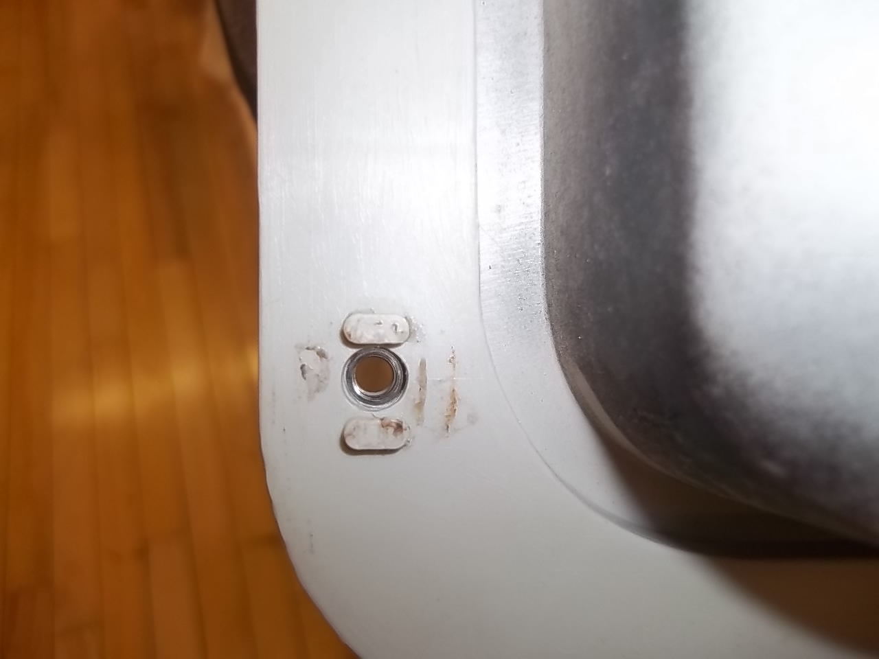

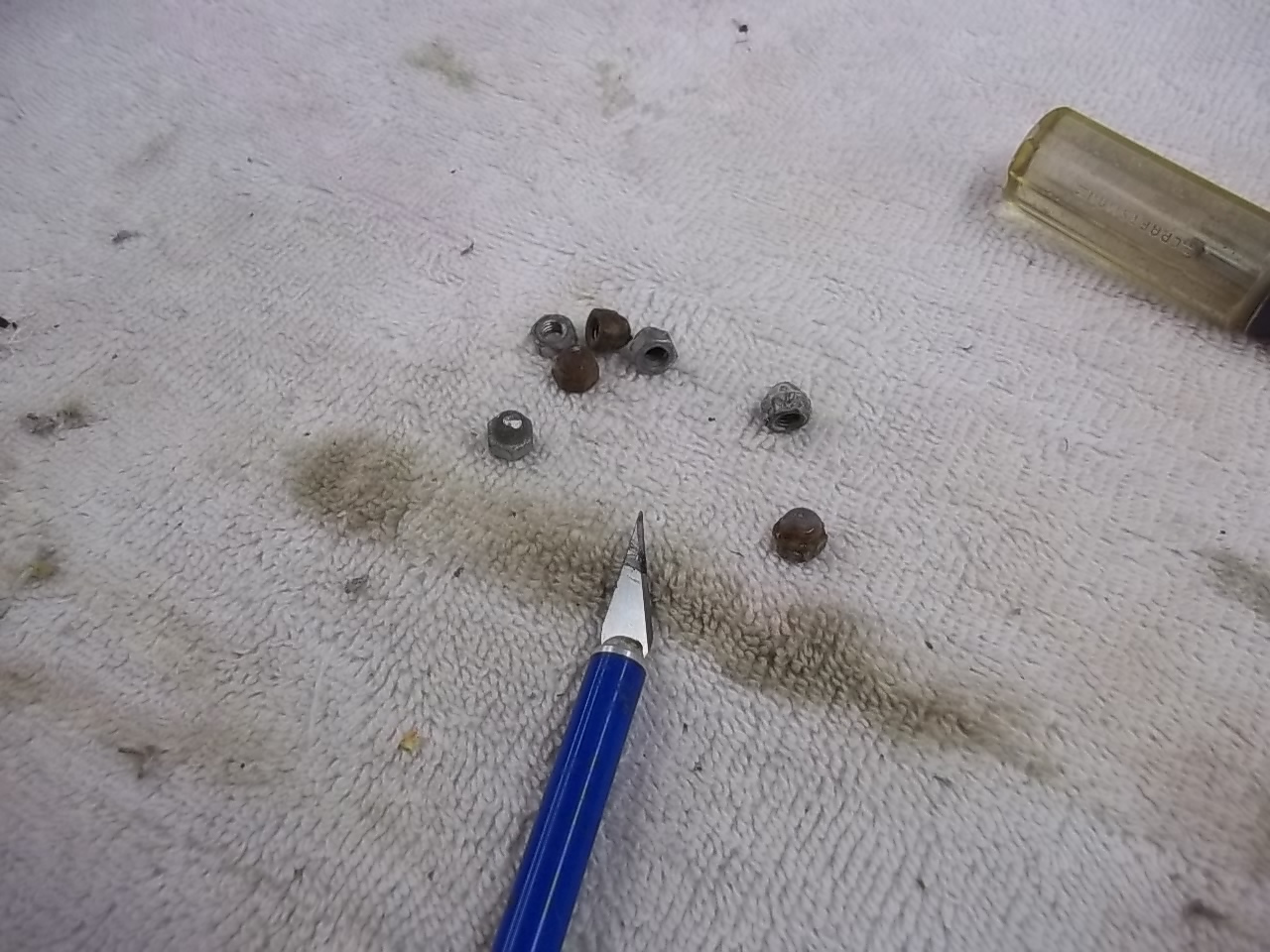

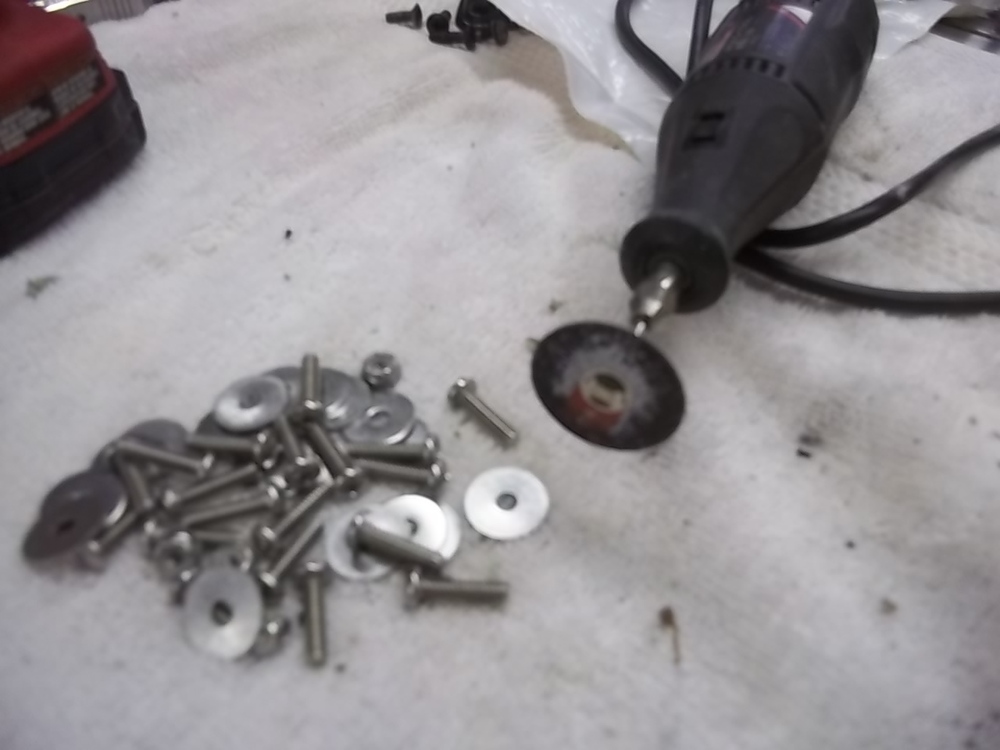

so i finally got the new seals for the tail lights and  found new bolts and washers. the problem was the acorn nuts in the housings were rusted, and a few were even missing. so here is my repair.
new 3/16" stainless screws, fender-washers (3/4" OD) and ny-lock nuts. and a dremel with a cut off wheel
and the other tool. i bought 1 extra nut to do the dirty work

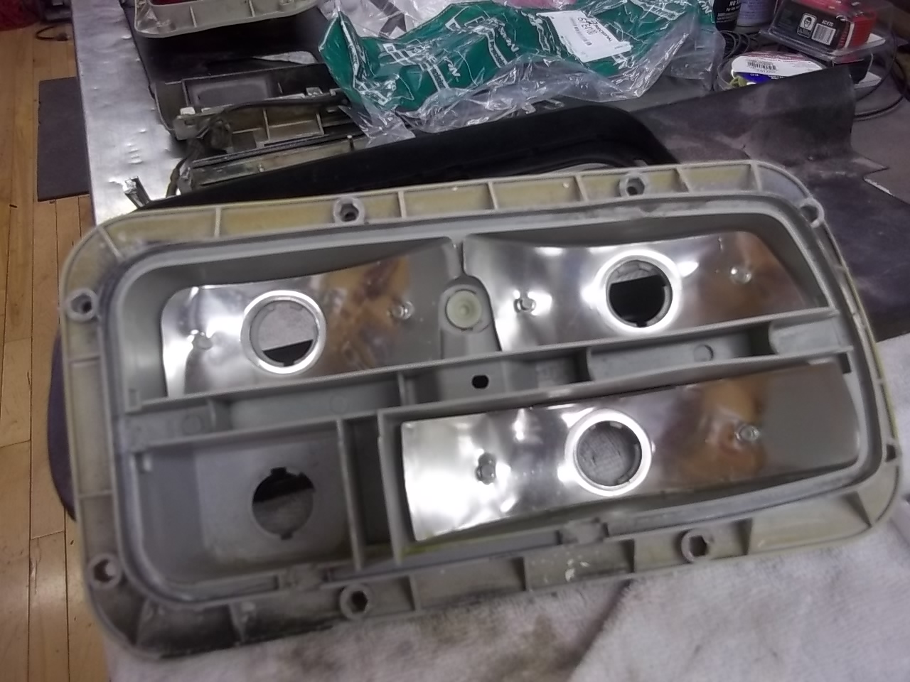

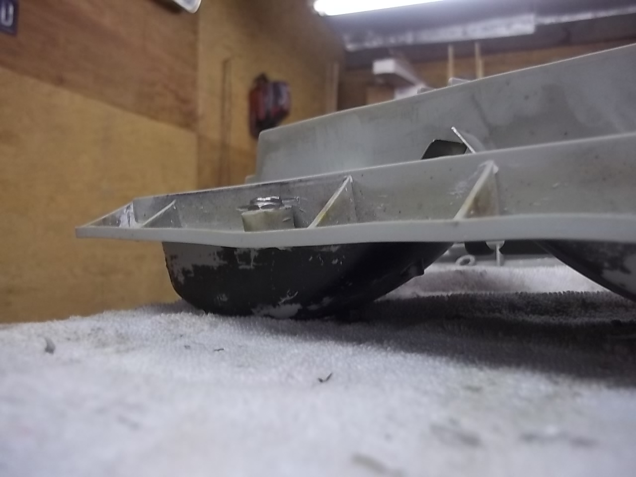

here is the housing after cutting the plastic to get the old acorn nuts out

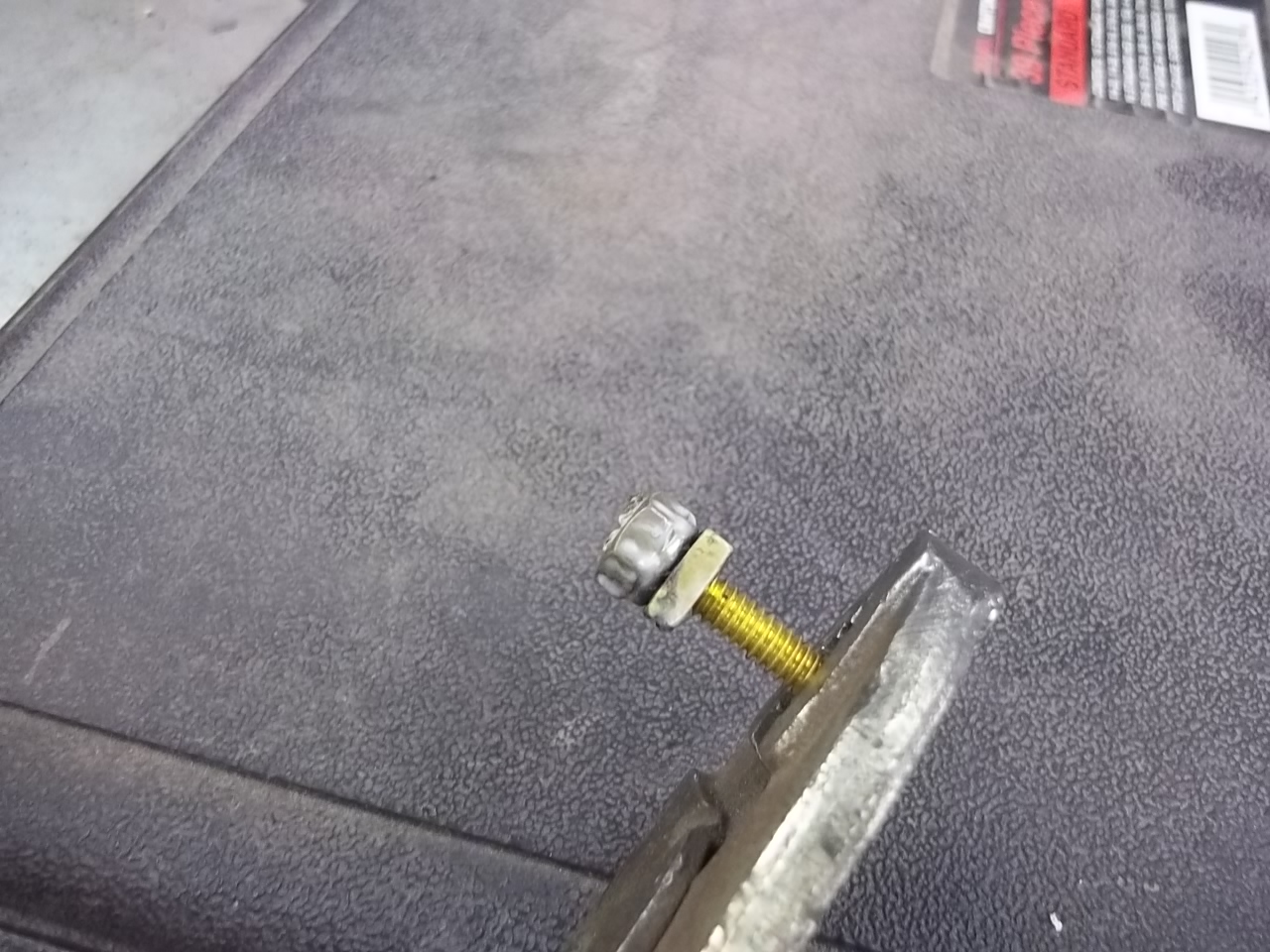

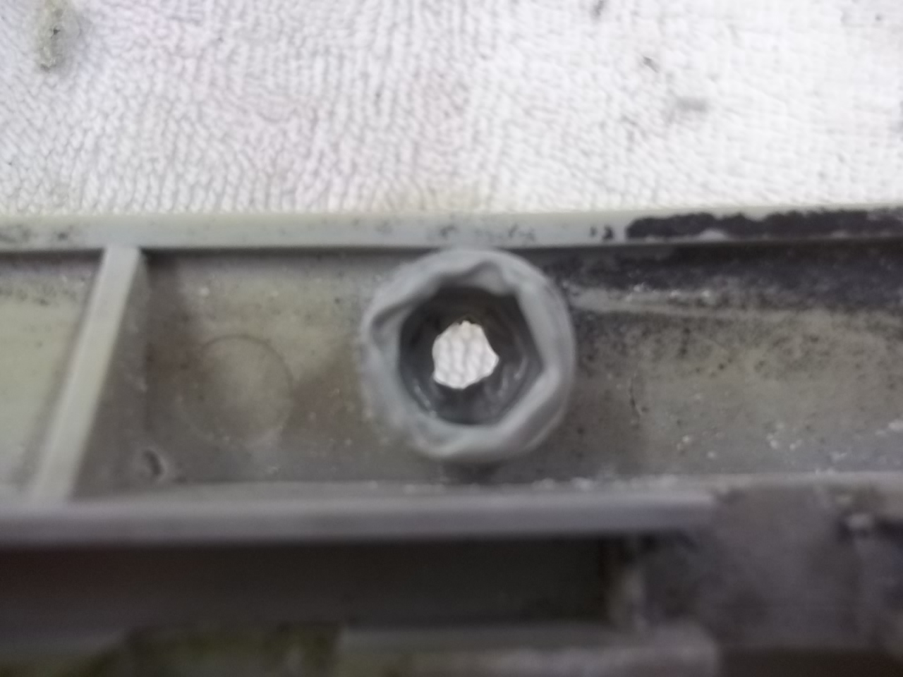

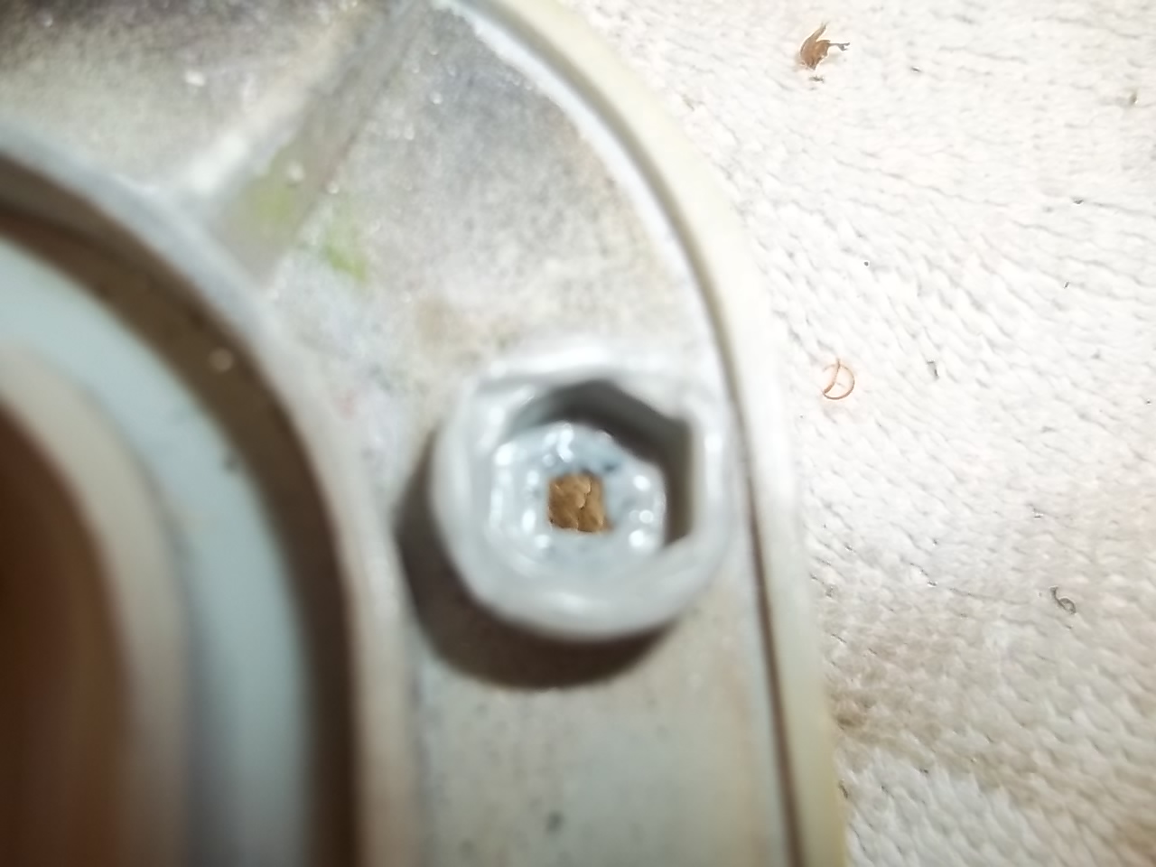

now for the dirty part. find a 3/16 screw and another nut to lock everything together, clamp it in a pair of vice-grips as shown above, and heat that nut up until it just starts to glow red. if it isnt hot enough, you will make a mess. now press that hot nut into the plastic. this is why you want it hot. it should take just a second for it to melt, and when you pull the nut out the top of the hole will kind of fold in. this is what will hold the new nuts in place.
after molding the new hole

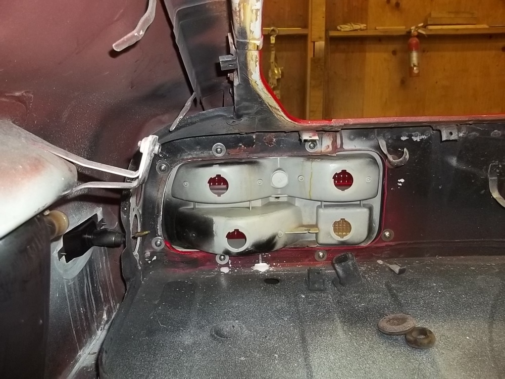

and the tail lights in the car.
