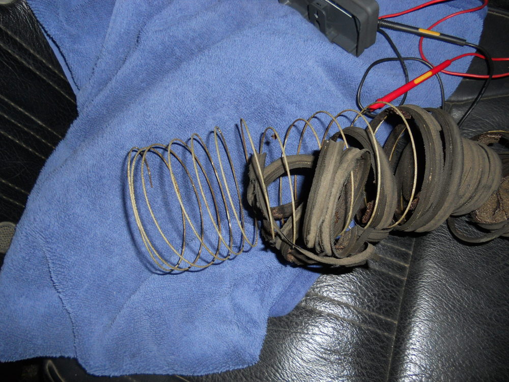

Both happened. I found a bad connection, The BLUE connector near the fuse box was pretty melted and the Green Blue wire in that connector was making poor connection. It supplied power upstream under no load but dropped to 0v upstream when the switch was closed.
The initial cause of this overheating appears to be a collection of things to include, too many exposed bullet connectors tucked under the carpet, some of them finding ground, one of which had found its way to another connector that is spliced with the hazzard light harness (hence the right arrow) AND get this, the wire frame from a disintegrated AC duct was making contact with the dash skeleton while one end had found its way into a free floating bullet connector which I think used to go to a glove box light...DSCN4009[1].JPGDSCN4008[1].JPG

Nasty.  And this all was happening while you owned and drove it?  They used to work, and were slowly failing?  The old PO trap.  Scary.  Makes me want to go do some preventive examination on my car.
