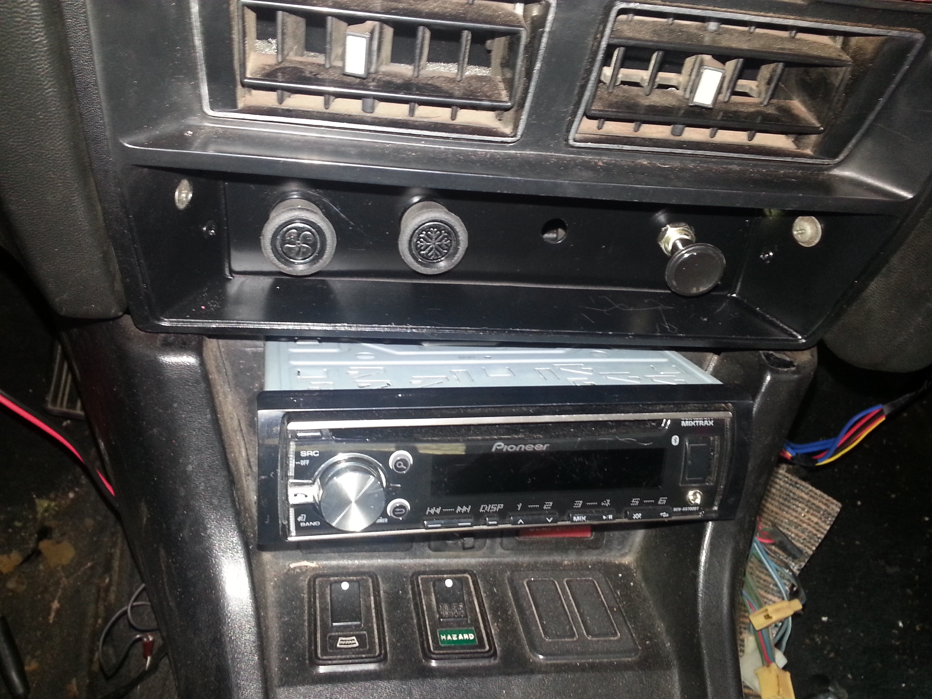

 Sam got the unit in but the radio sticks out about 2" Also on the first trial run home the AC blew cold but started warming up until it was useless. I don't know the miles, duration or ambient temperature but I don't think it took very long to stop cooling. Also, just for the record, I don't know much about AC, so if I sound ignorant, I am.

The unit is in but the modifications to allow it to be there are more than I want to deal with.   The slide control unit has to be taken out as the AC came with different controls totally.  A plate has to be installed to allow for the new controls to be used.   Then there is the radio.  The unit under the dash is so large that the radio no longer fits, it sticks out close to 2 1/2 inches.  All this just destroys the integrity of the dash control area.   That is more than I want to deal with.  Thanks...

Aaacck.  No more prizes for RedBird with that thing in there.
