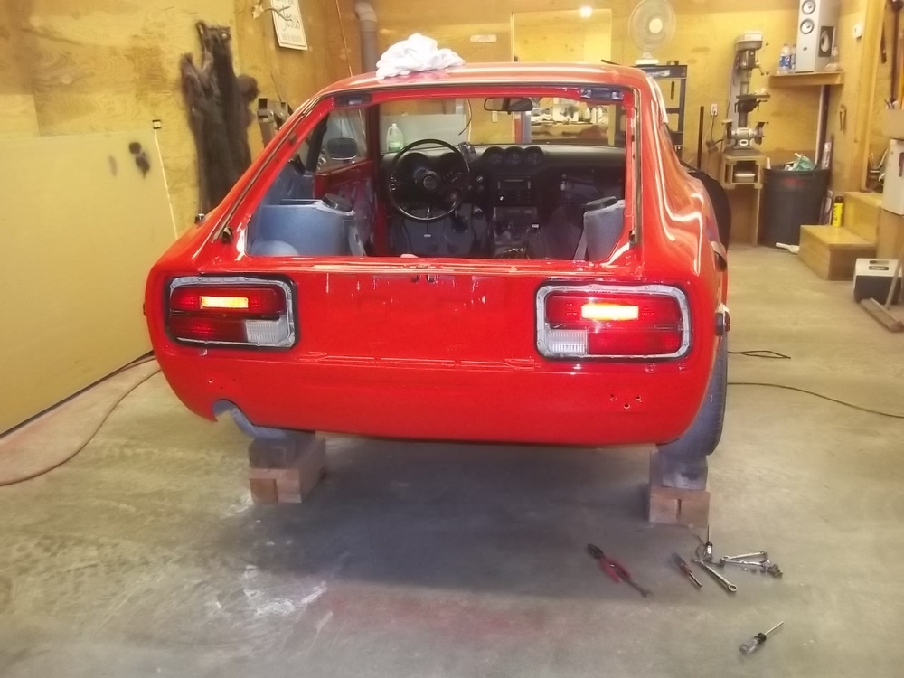

is there only one seal on the tail lights, the tail light to body? when i put the finisher trim on there is a gap between it and the tail light and you can see in there. it looks like there may be something missing. or, was the the housing just painted black? mine is a lite grey color that you see in the pic below even with the trim on.

There was a very thin trim ring in between the panels and the light assemblies originally.  The OE part numbers were 79902-E4100 and 79903-E4100 but they are no longer available.  You can always fabricate something if it really bothers you but that's how it came from the factory.
