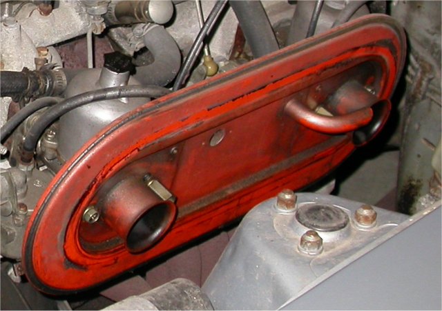

To change the subject a little, if I wanted to replace the stock air cleaner with the K&N or Ramflo, what do you do with the two hoses to the carbs as well the one to the valve cover and engine block ect? No sure I want to go this route but it may it seems as if it would improve the air flow. Any advice would be appreciated.

You can change the filter element but do NOT change the "back plate" that bolts to the carbs. It includes the "air horns", the metal tubes that the air passes through on the way into the carbs.
The air horns are essential to the efficient operation of SU type carbs. The backplate may be removed if separate airhorns are acquired and mounted. But then how do you mount the new air filter?

Note, an air box is also a key in appropriate performance of SU type carbs. Air tends to pass by the airhorns during highway speeds, not "making the turn" into the airhorns.
Just be sure that the lever on the air box is set open for summer, and you will get plenty of air to the carbs for a stock engine. If you have significant performance work inside the engine where it needs to "breath" a lot more air, then work the CAI deal by doing some engineering as previously stated.

install a K & N filter in the stock air cleaner box and the engine will perform better . The individual K & N cone shaped filters look real good but dont perform as well with out the stacks that are on the stick cleaner. As was stated before unless you are running a big cam and a stroker , you would then be running tripples, you have the set up that will work the best right now. You might look to SM needles for the 280 engine , they deliver more fuel at higher RPMs and run great at normal street Rs. just a different taper. :classic: NOTE !! New information is that the SM needles are not advisable on a Z application . They are so rich they will cause the oil in the cylinders to be washed away and premature engine failier will result. I tried them on avice from supposidly a person of knowledge. I have since found other wise. Gary

I ended up doing what you suggested by getting a K&N filter for the stock housing. Its a little expensive but im told its a life time filter. They show you how to clean it for re-use. I like this setup better then modifting what I have.
