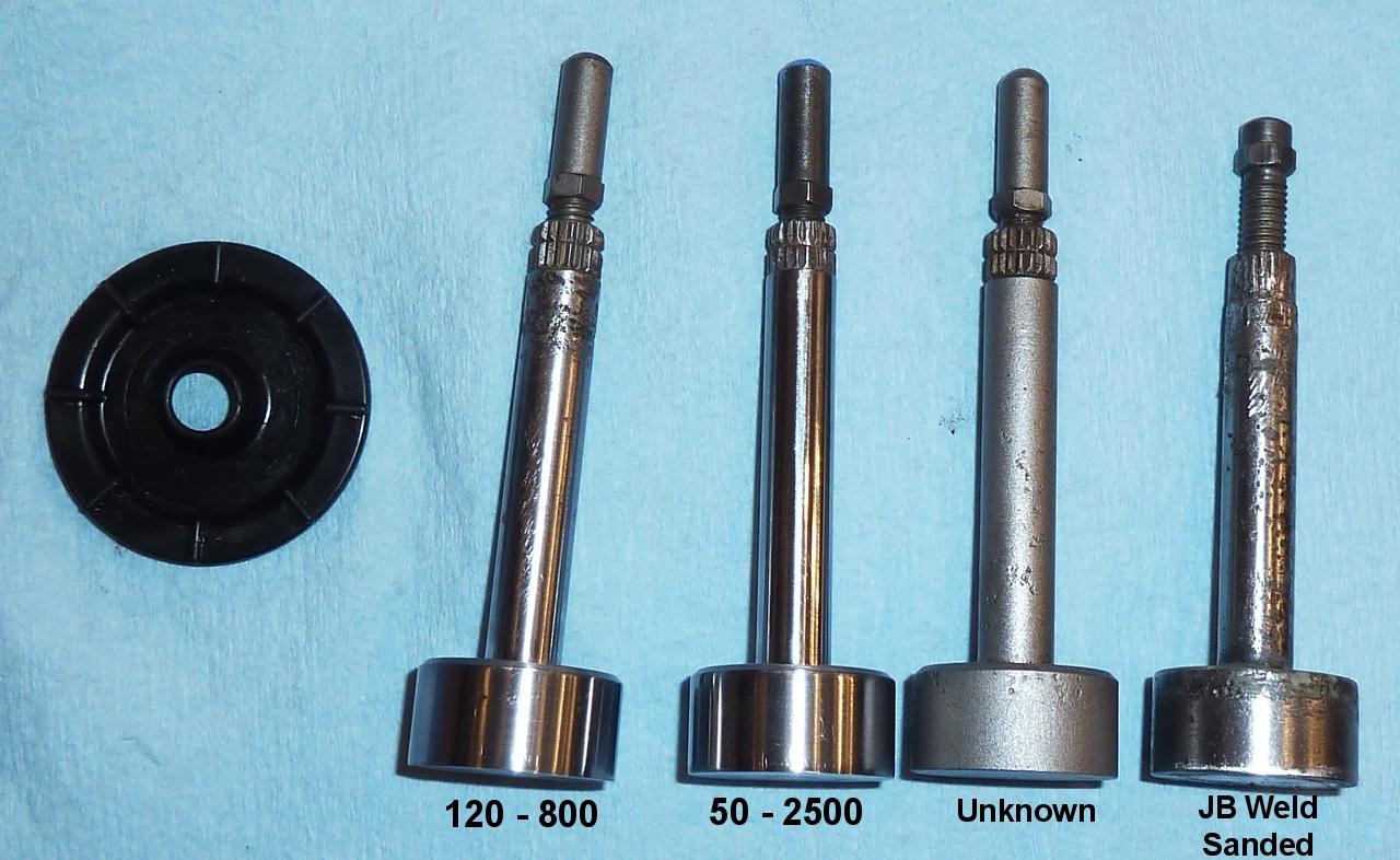

I  just received a Cardone rebuilt booster like you and it had the same slathered silicon grease on the pitted push rod.
I first experimented with a spare one (pittted) and chucked it in my drill press and gently sanded it from 120 grit all the way up to 800. I did not try to sand out the deep pits and they still show badly.
I then spun the more pitted one (that came with the booster) but I hogged it at 50 grit until  the pits were removed. I then finished it all the way up to 2500. It turned out very nice and worked very well at holding a vacuum even with the narrower shaft.
Also in the collection below is an old one from a 240z that I tried to plug the pits with JB Weld then hand sanded. It worked just so-so.
I'm not sure about the matt coloured one. I think someone may have zinc plated it.
The rebuilt booster's seal works well with the hogged  push rod.
Edited by 240260280
Nice work! Certainly can't be worse than the original pitted finish!
From my brief foray into that realm, I found that front vacuum seal had significant compliance and held pretty snug against the shaft. You should be able to tell how much metal you removed by comparing your sanded one to the originals.
The JB weld rod looks nasty. Like someone grabbed it with pliers at some point. And the one you have labeled "unknown"? I don't think that's zinc plating. I think someone sand blasted it. That one may clean up nice with the sandpaper treatment.
Well if yours is like mine, (and based on your description of slathered silicone grease, I bet it is) then you absolutely need to degrease first.
And even so, I wouldn't be surprised if you don't get some fish-eye like I did. With that much silicone floating around, I think it's inevitable.
Did you split the clamshell open, or are you just working on the parts you can get to from the outside?
Just working on the outside.  It held 15" vacuum for 15min so that is good for me.
I just used the Duplicolor degreaser and some high-build primer followed with a satin black. It looks ok.
Luckily the pits are not so bad on the shell.
I also Zinc plated the push rod to reduce future rust.
