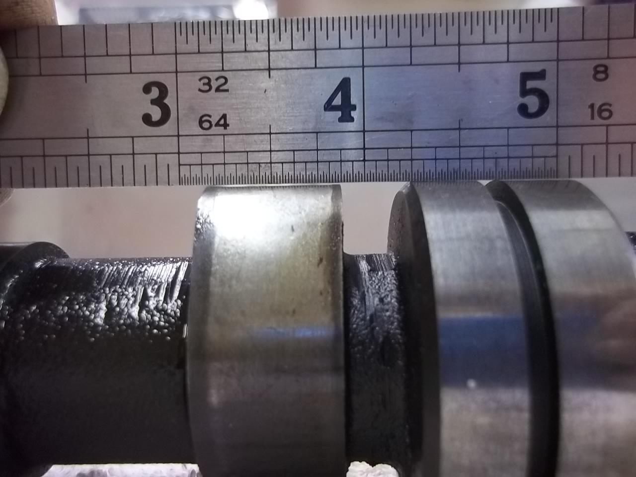

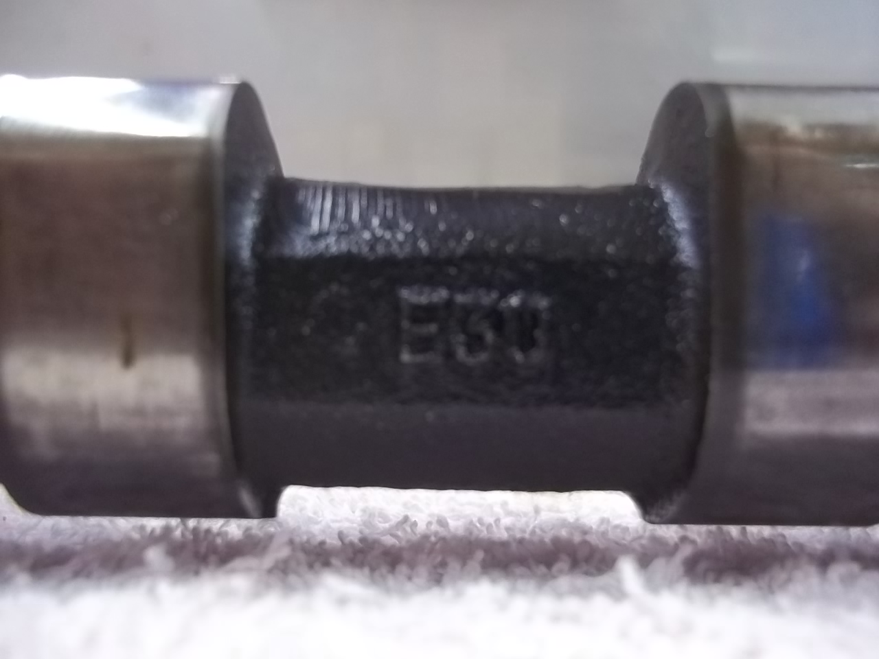

ok, maybe this is biting me in the face and i just dont see the answer. how can i fit a higher lift cam in the towers if the cam lobes are higher than the the journals? this cam measures out at .433 lift at the valve. i want to go closer to .500  the lobes right now are almost even with the journals.

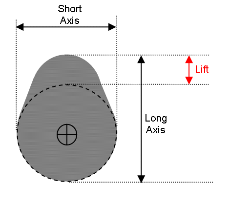

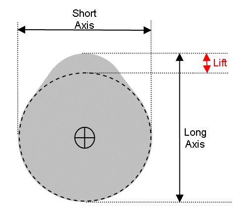

The cam lift is the difference between the long axis and short axis of the lobe profile.  Negligible metal is removed from the nose (top) of the lobe when re-ground.

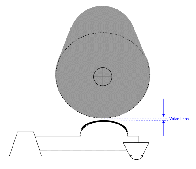

Below are some drawings I made many years ago. They should make it a bit clearer.
The geometry requires the lash pad to make up for the amount ground.
And the cam journals are staggered in such a way that they go through the cam bearings at the same time so as to leave room once they are through to slightly move the cam to avoid hitting and scratching the cam bearing. Removing and installing a cam is the most potentially dangerous time there as it is SO easy to scratch the bearing surfaces, very hard cam metal, very soft bearing metal.
Good job Blue......nice illustrations!
