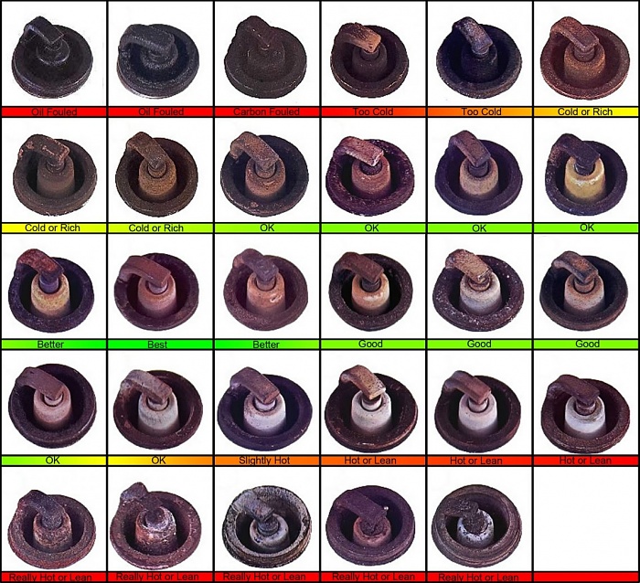

21 hours ago, Palmettobug said:
I just replaced the spark plugs yesterday. The first three appeared to be white. The second three appeared more blackish.
Your carbs' fuel metering is not balanced, The front carb is not giving enough fuel. I will assume needles are mounted correctly in the SU pistons and that the SU pistons are not binding and there are no intake leaks:
1. Check to make sure the jet nozzles move up and down freely and that the choke is not causing either to be up or down (for tuning I always disconnect the choke wires at the carbs and push the jets all the way up "just to make sure").
2. Adjust the jet level on the bottom of the front carb lower (to give more fuel) then drive for a bit then check the plug #2 and compare to the plug #4's colour.  Keep adjusting the front jet level until both are the same.
This should fix your plug colour.
From experience, your loss of power is either inadequate fuel delivery (debris in tank, weak fuel pump, low fuel bowl levels) or a failing/maladjusted points distributor or failing condenser).
Just a couple of notes from experience:
1. Buy a non-contact infrared thermometer. Take the temperature at the thermostat housing when you think the gauge is reading high. The stock thermostat should open at 160 degrees.
2. Make sure you don't have any loose bolts on your exhaust manifold. I had a couple work loose under the rear carburetor. One of the symptoms was crappy running when the car had been sitting in traffic because the exhaust leak was right under the rear carburetor and would heat up the intake on cylinders 5 & 6.
