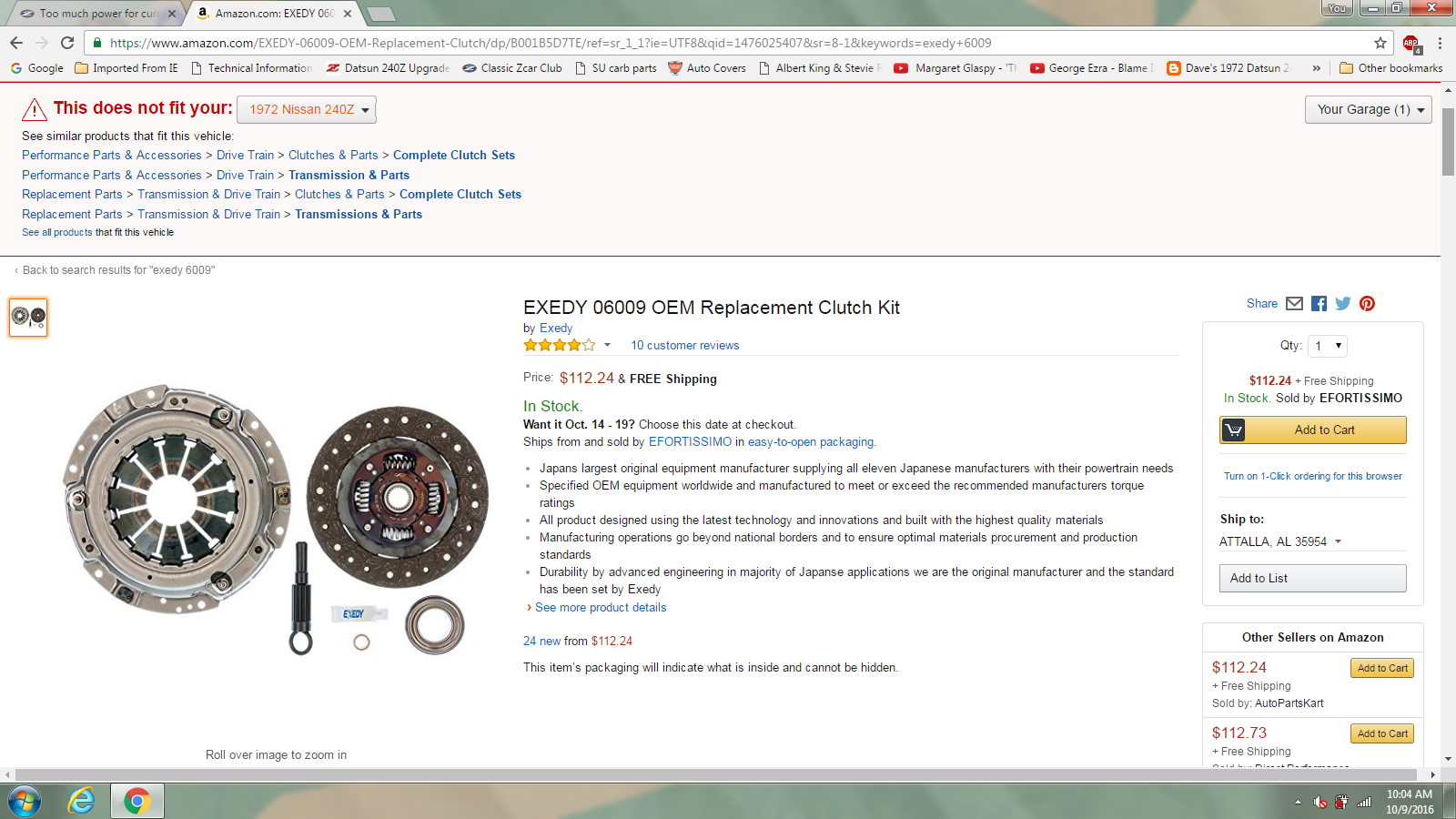

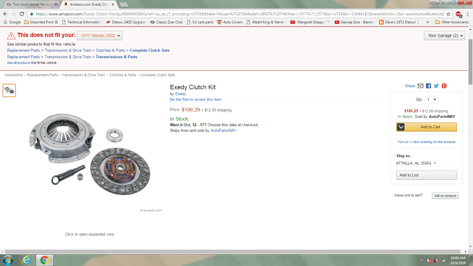

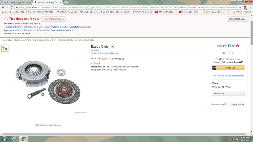

So the OP can buy the $112 Exedy clutch kit #6009 for a 280 and use on his 240 4 speed instead of the $186 one for 240s?  When I check fitment on amazon.com it says they won't work on a 240.  I would go with your advice before amazon.com's but am wondering why the discrepancies in the two?  Not a huge savings but cheaper nonetheless.
Cliff....IMO, everyone tries to make this more complicated than need be. No matter the tranny (240Z or 280Z or Zx, 4 or 5 speed, A or B ) they are all the same dimension. The important fact is that the geometry of the clutch arm is correct. Simply stated if you use the shorter 280 Z or ZX clutch, you need to use a 280 collar (taller)to get the proper distance from the flywheel to collar fingers that ZH mentions. Since the 240Z's clutch pressure plate is taller, you need a (shorter) collar to get the same distance......simple as that. You don't need to worry about measuring anything.....280 clutch used with 280 collar works.....240 clutch with 240 collar works....simple as that....in any of the above mentioned trannies (2+2 not included). I have had success with the taller 240 clutches and use them in all my cars since I don't want to mix and match. I've never installed a 280 clutch, so can't comment on which is better.....love my 240's though. Cooper didn't know where the slave cylinder was, so I think we should keep it as simple as possible. He needs to buy either a 240 or 280 clutch with a matching collar. He can measure the collar that comes out and buy the corresponding clutch if he wants to save $12.00 for the collar....his choice. And as far as a flywheel goes, I think he should stick with a refinished stock flywheel IMHO since remember not only he couldn't find the slave cylinder, but still hasn't even adjusted it yet to find out if that fixes his problem!  BTW....Throw out bearings are the same for either clutch you use. Also, he should order from MSA IMO....they can match his order with the correct collar whichever route he goes.....and regarding your question above....yes either Amazon clutch will work in the 240Z tranny with the correct corresponding collar......short is 280 ......tall (more expensive) is 240.

I agree with you on keeping it simple for Cooper but there's obviously something different about the clutches from '70-'74 and '75-'83.  I'm just curious as to what it is because I'm with you on them being the same but the suppliers seem to feel different.  From MSA;

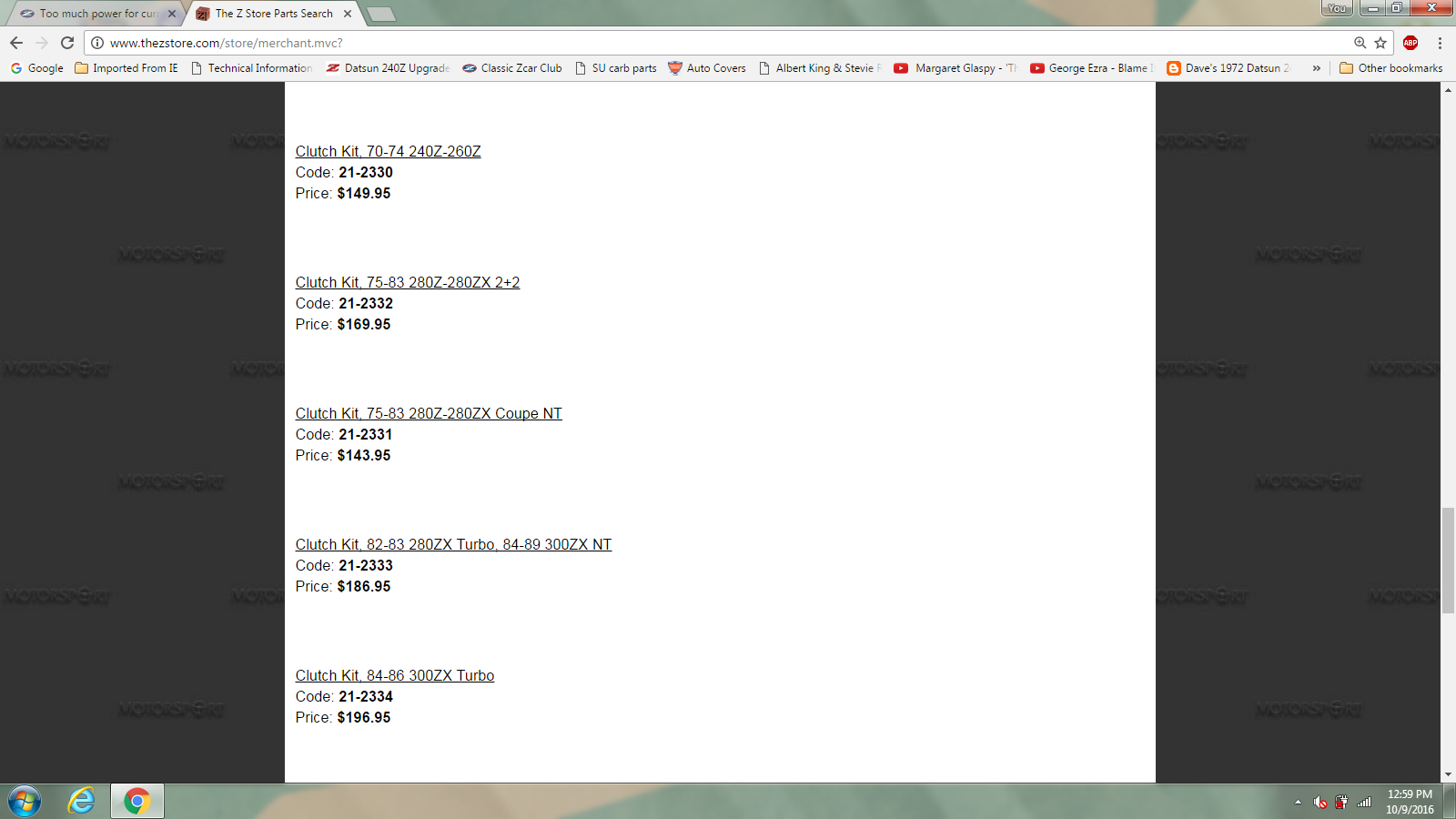

Right....code 21-2330 is 70-74 240Z and 260Z......use 21-2121 collar for 70-74 240Z and 260Z. Code 21-2331 is for 75-83 280 Z or ZX non turbo.....use 21-2122 collar for 75-78 coupe  79-83 non turbo.....as Zcars mentioned above these will give you approximately 92 mm from friction surface to collar fingers. 280 or 280ZX use 280 collar.....240 Z and 260Z use 240Z collar as stated in a great big paragraph above. 2+2 and turbo's are different combo.:beer:

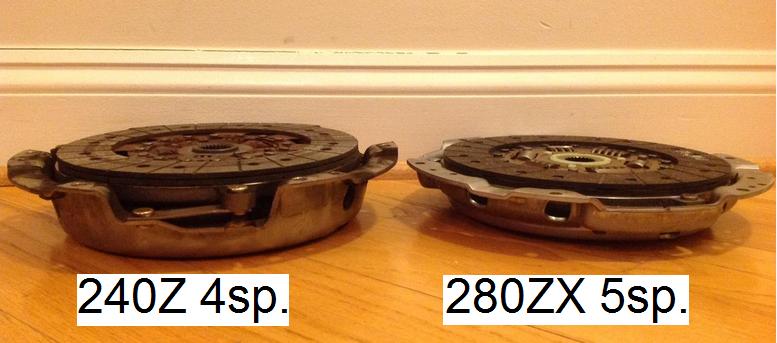

Here's the two clutches.....the 280 requires the taller collar to equal approximately 92mm. There is a difference, but if you match collar to clutch, either will work in the 70 to 83 trannies (turbo and 2+2 excluded).
