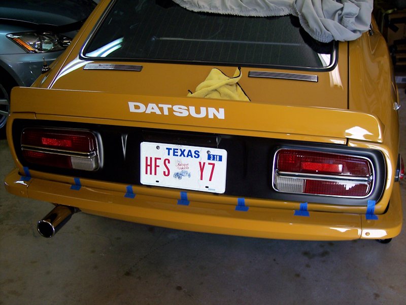

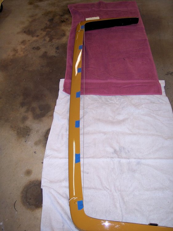

I tried fitting the new bumper to my car and determined the curve of the center piece was not a good match for the back of the car.  Note that the car is accident-free and all of the body is exactly as delivered from the factory.  Essentially, the arc on the bumper is less than the arc on the body (and the OE bumper).  When attached to the stock mounts, the center of the bumper was pressing hard on the body.
I attempted to warp the bumper section to increase the arc with little success.  I did manage to introduce some very slight waves in the center of the bumper’s top surface – not obvious but there if you look hard for them.  While the unit may not be perfect for a concours car, it should be OK for any other.
