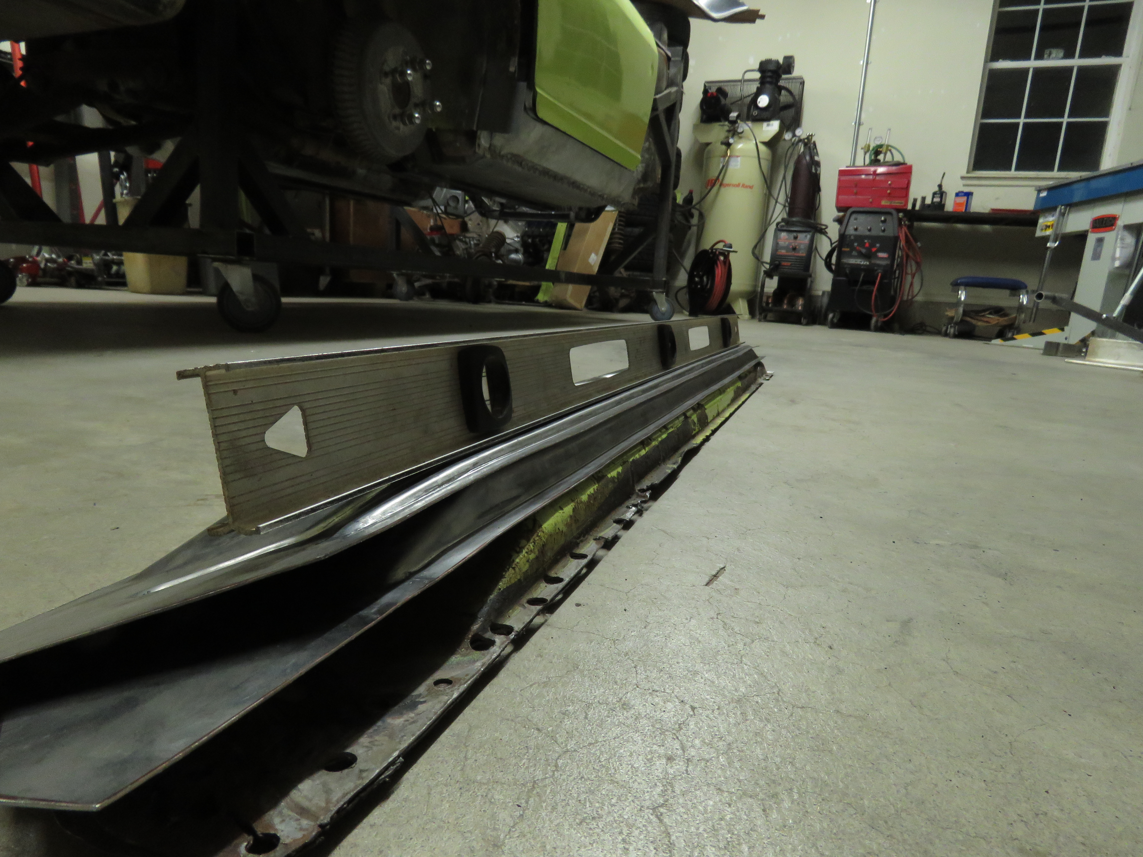

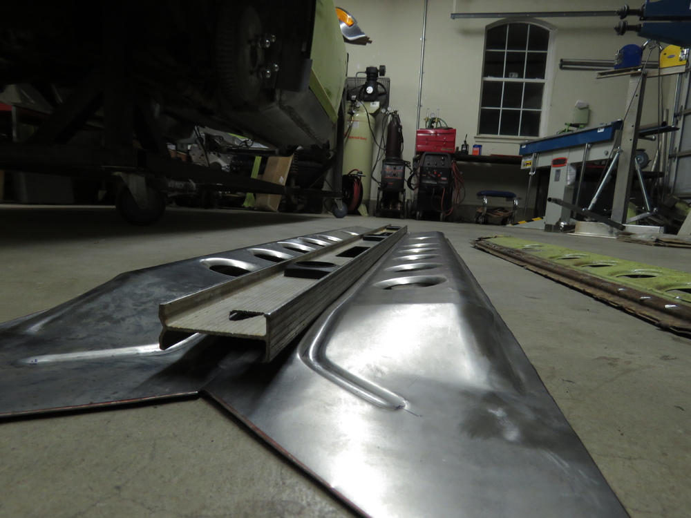

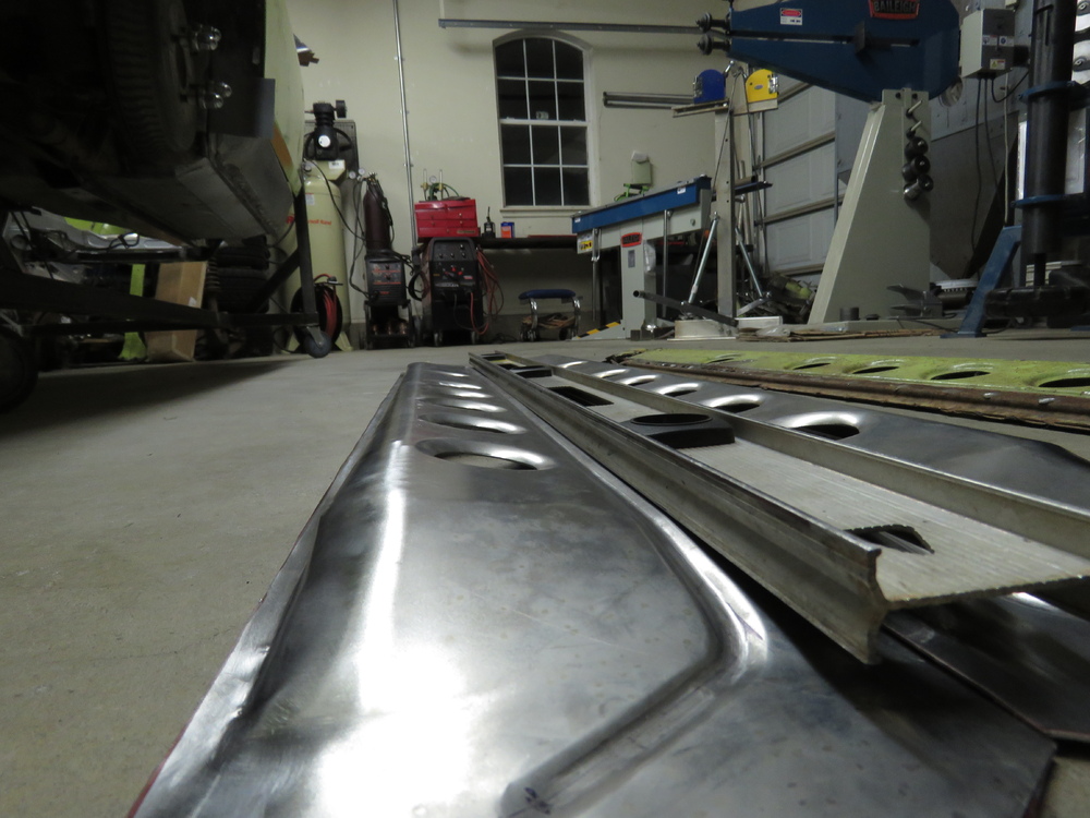

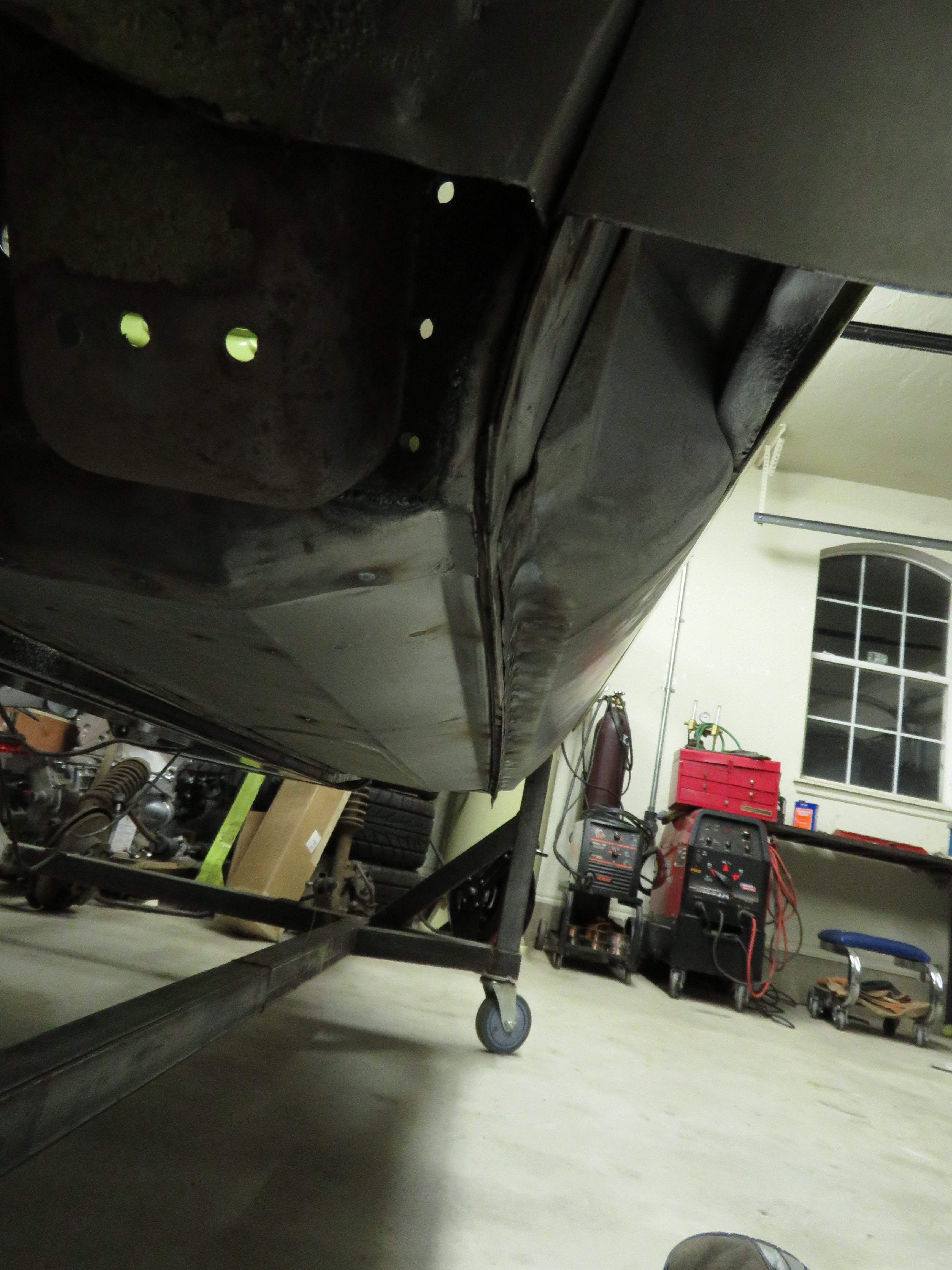

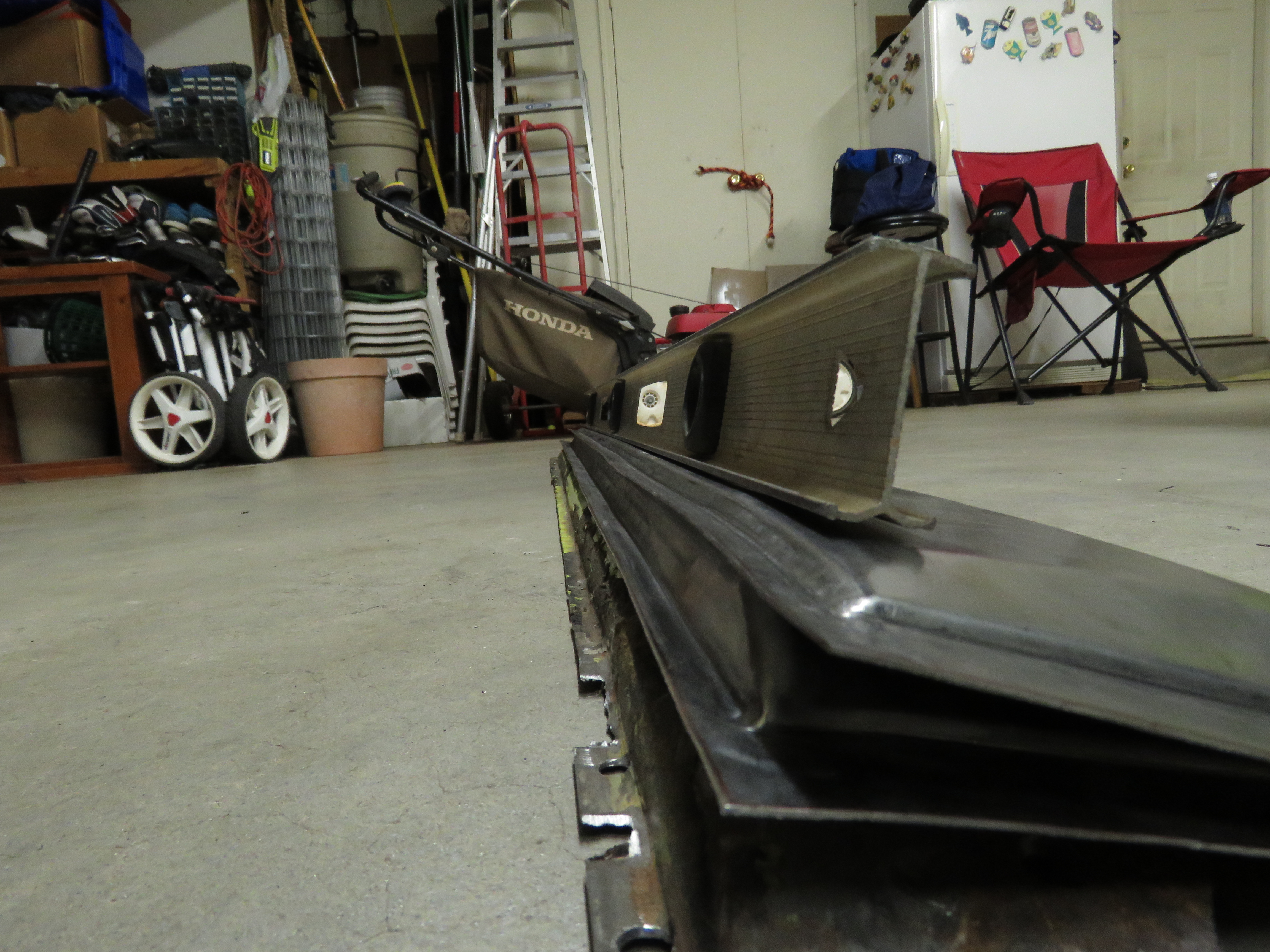

Haha, I have my fair share of UH OH's such as the one pictured below.
The first set of Interior rocker panels I made which were for my car, you can see in the picture below that the bottom of it has a bow.  Though it has a bow in it, Everything still aligned up, the only fitment issue I had was with my floor pans, had to put a curve in it at the flange end that gets welded to the rocker panel in this area. Oh well I guess, part of learning.

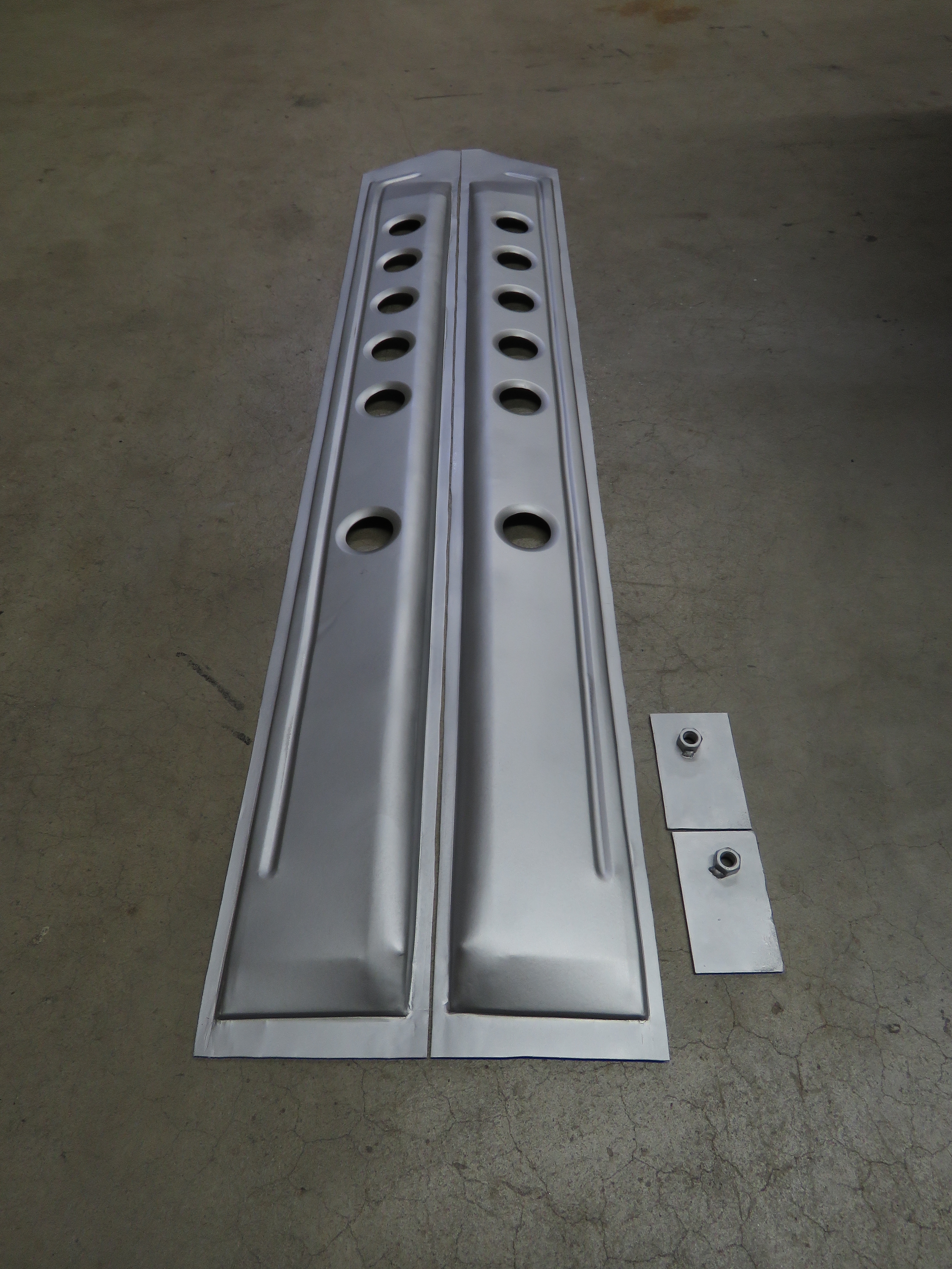

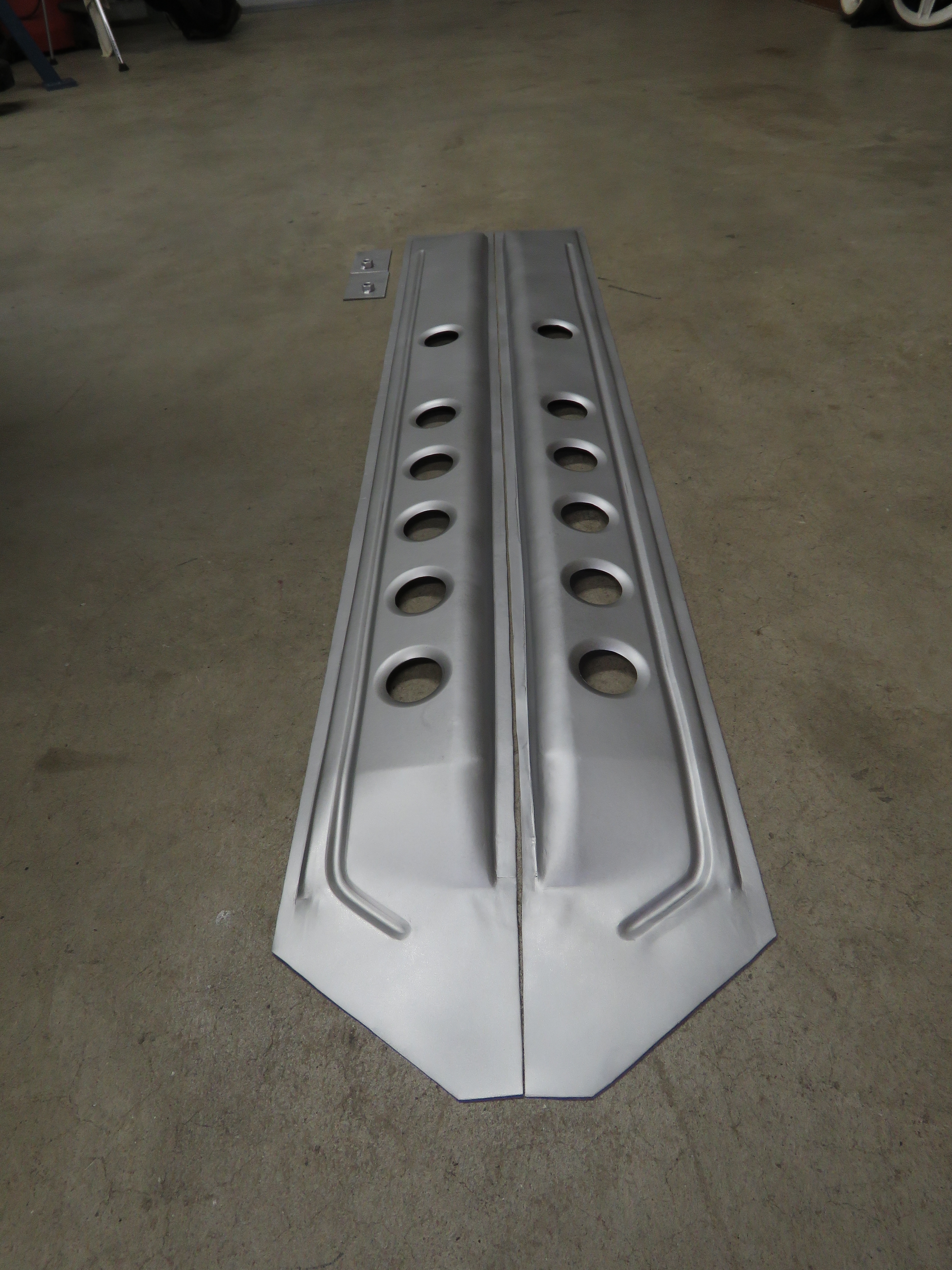

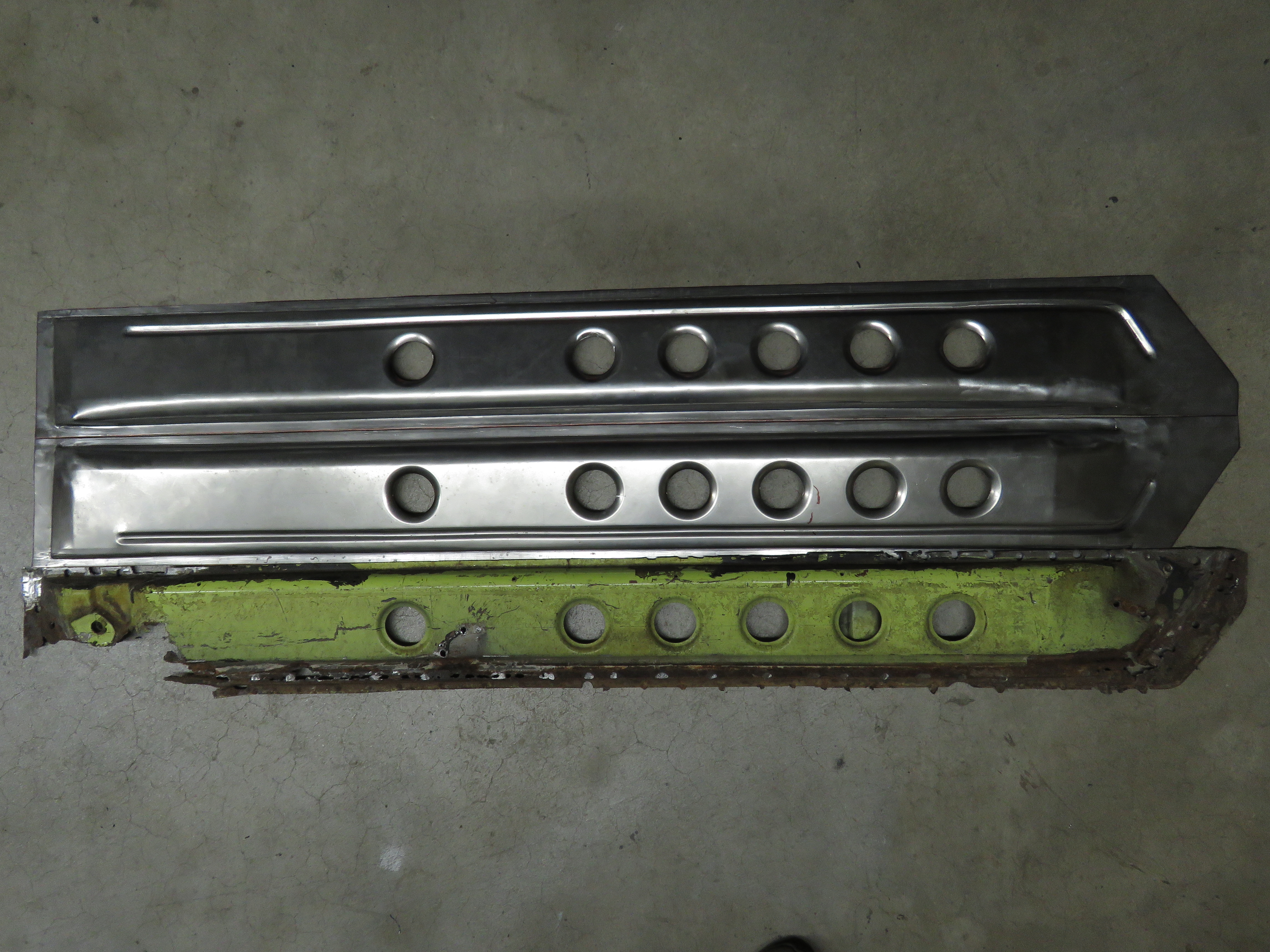

Was working on making a set of 240z Interior rocker panels yesterday and finished tonight for Charlie at Zedd Findings.
You can see in the pictures below, that the bottom of it is straight like its supposed too, unlike the one pictured above.
Before painted comparison picture.
After a light coat of Rust preventative Weldable Primer.

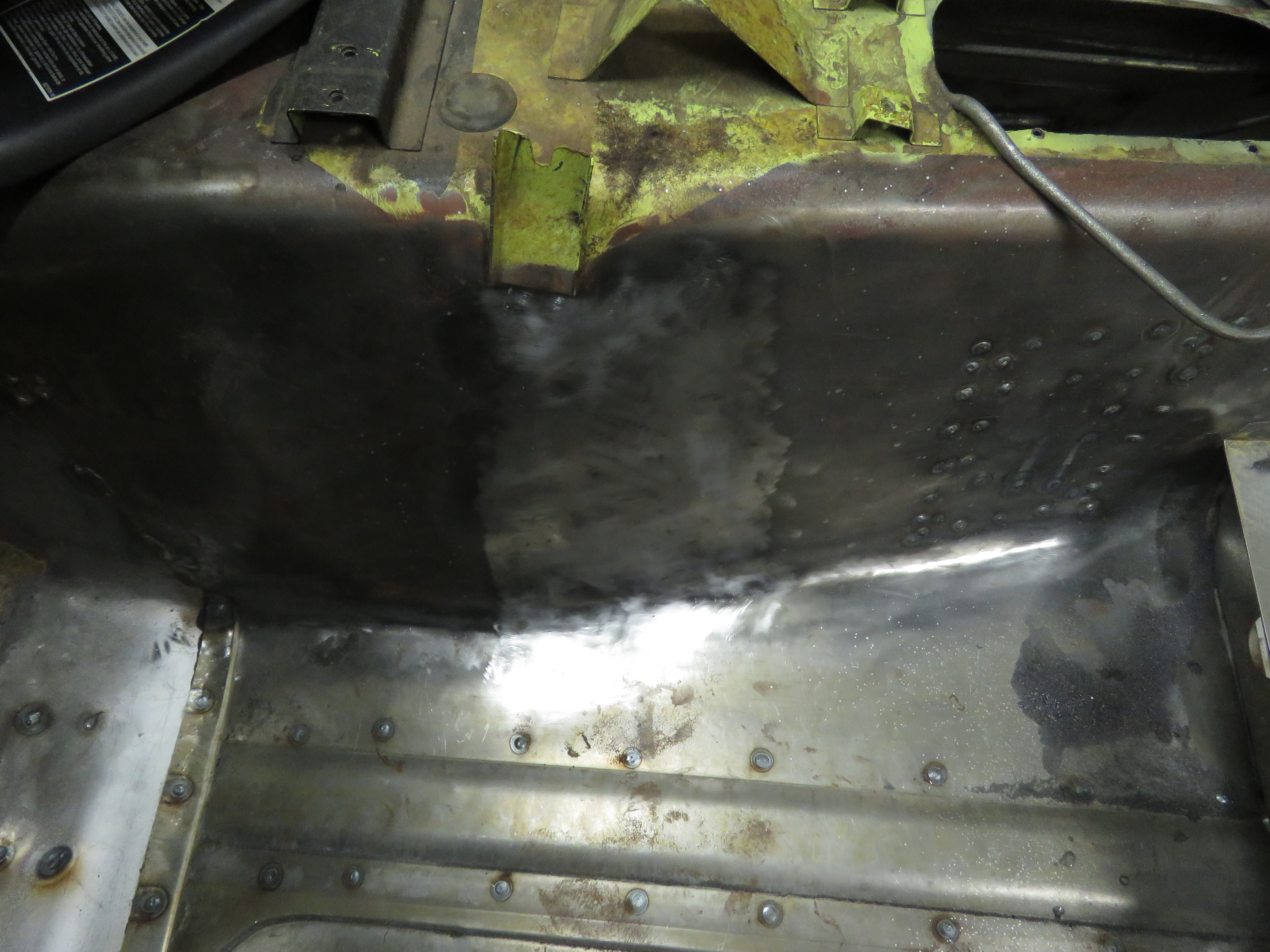

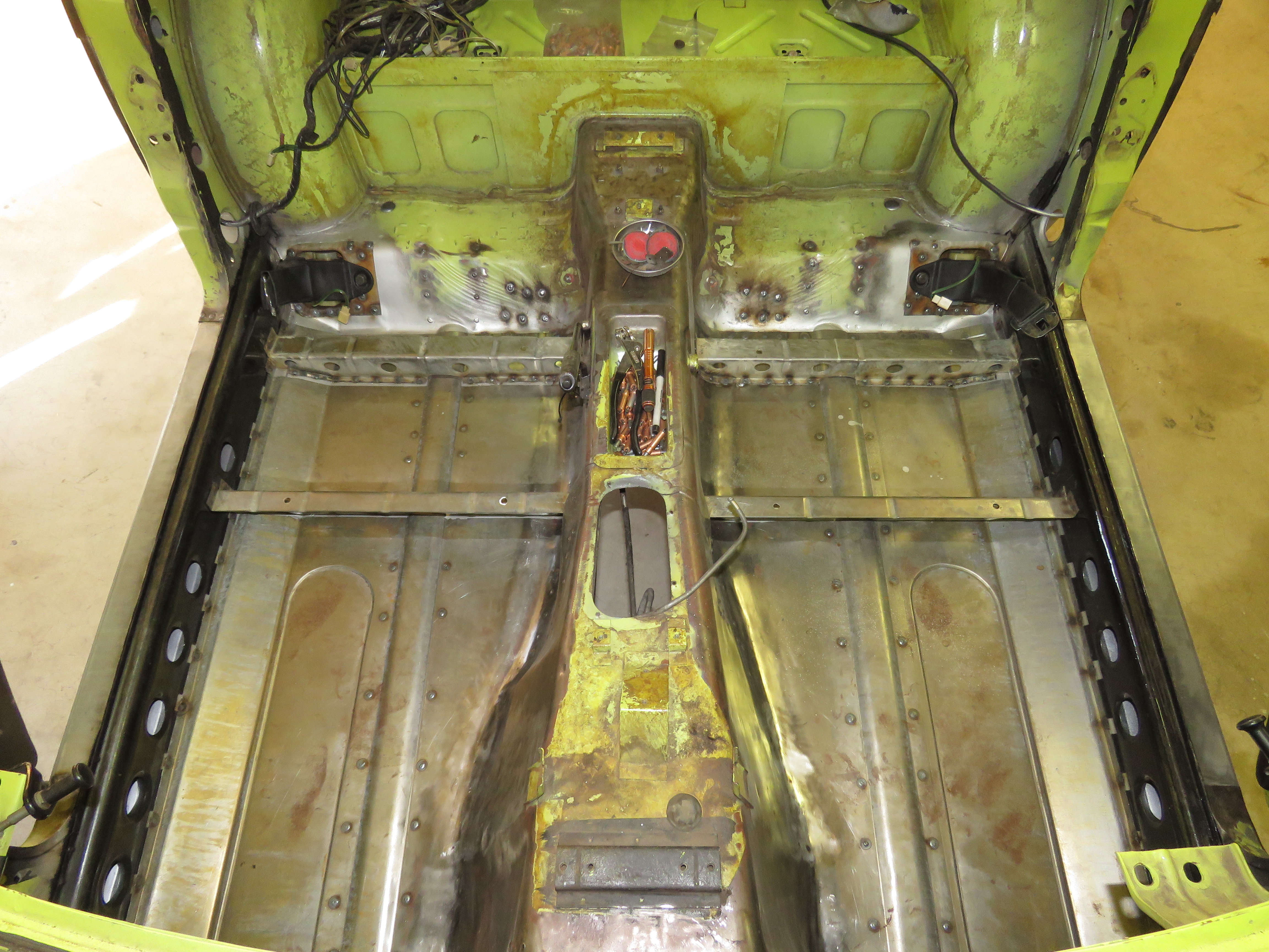

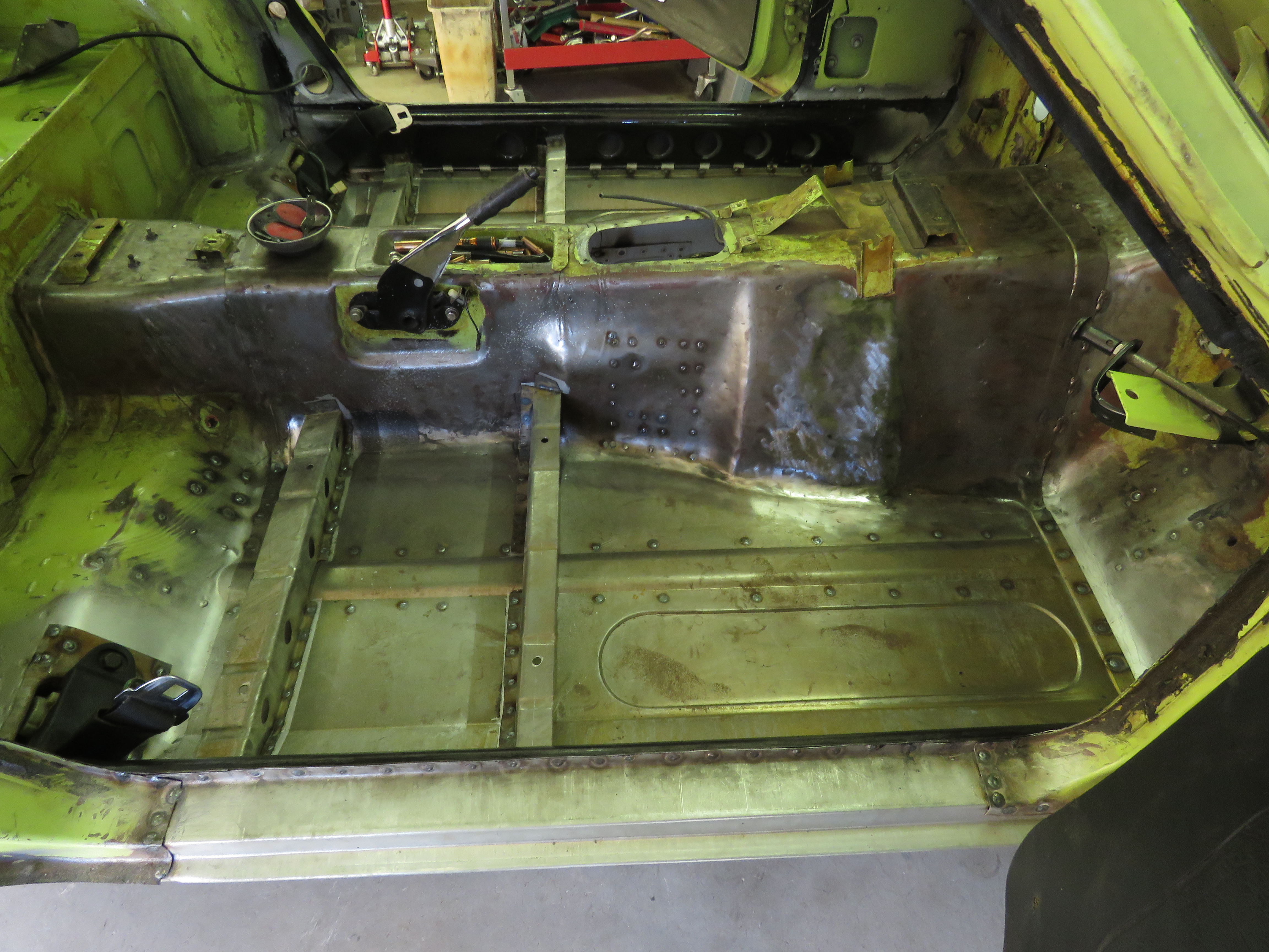

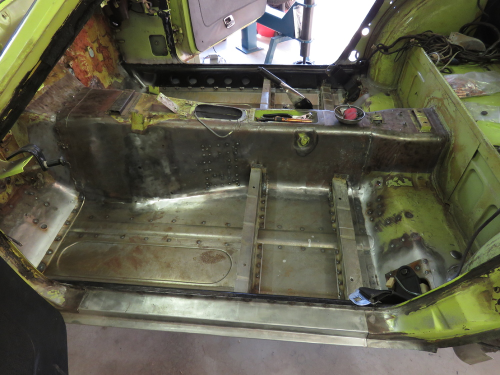

Small update to show. Just glad the interior is all finished. Now to work on the rear of the car.

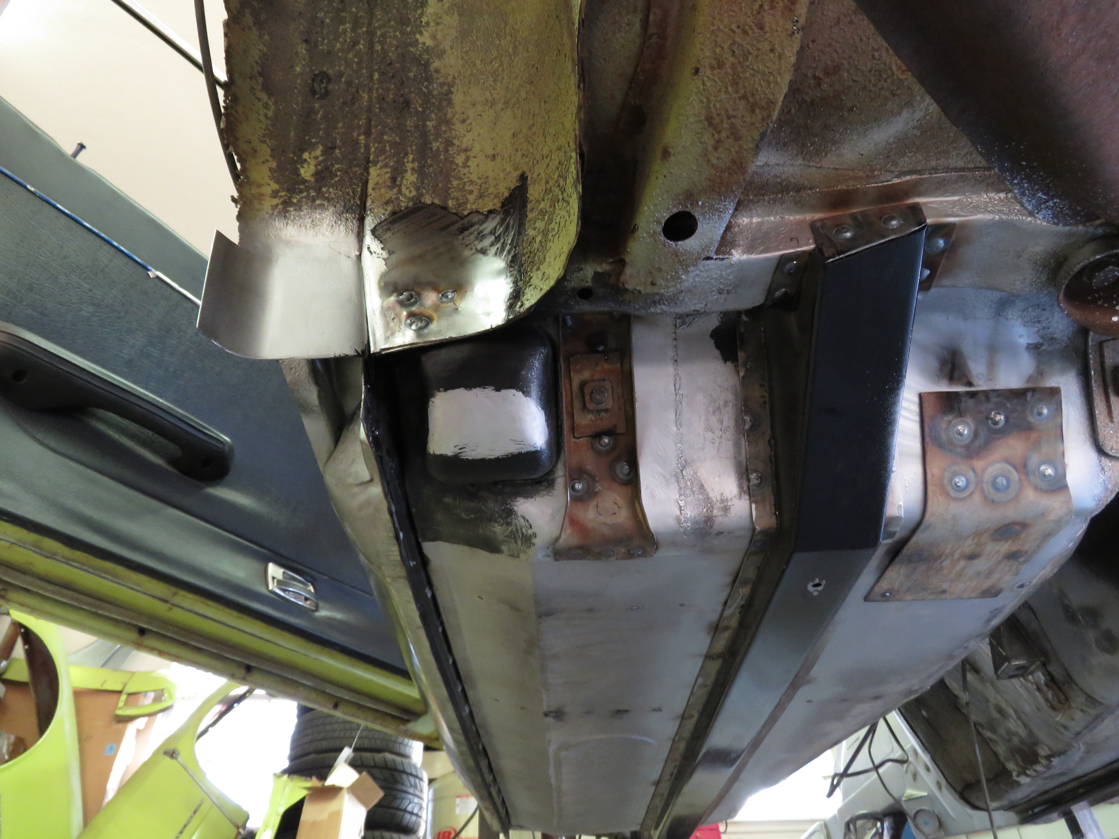

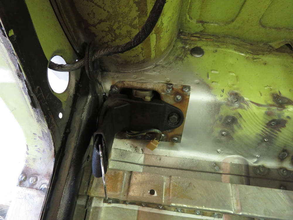

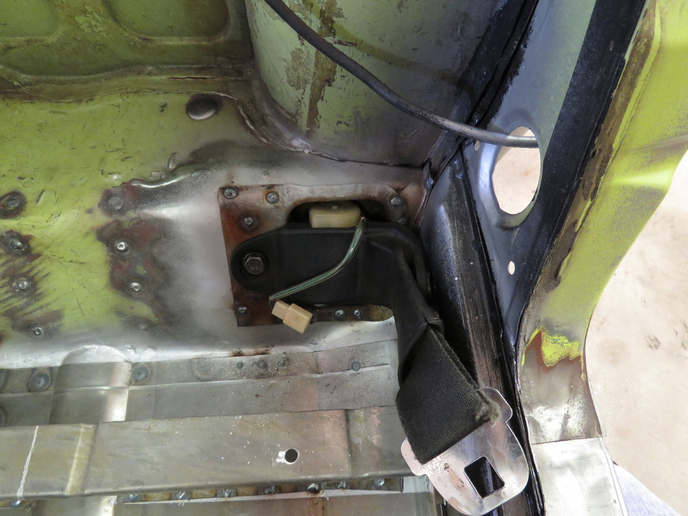

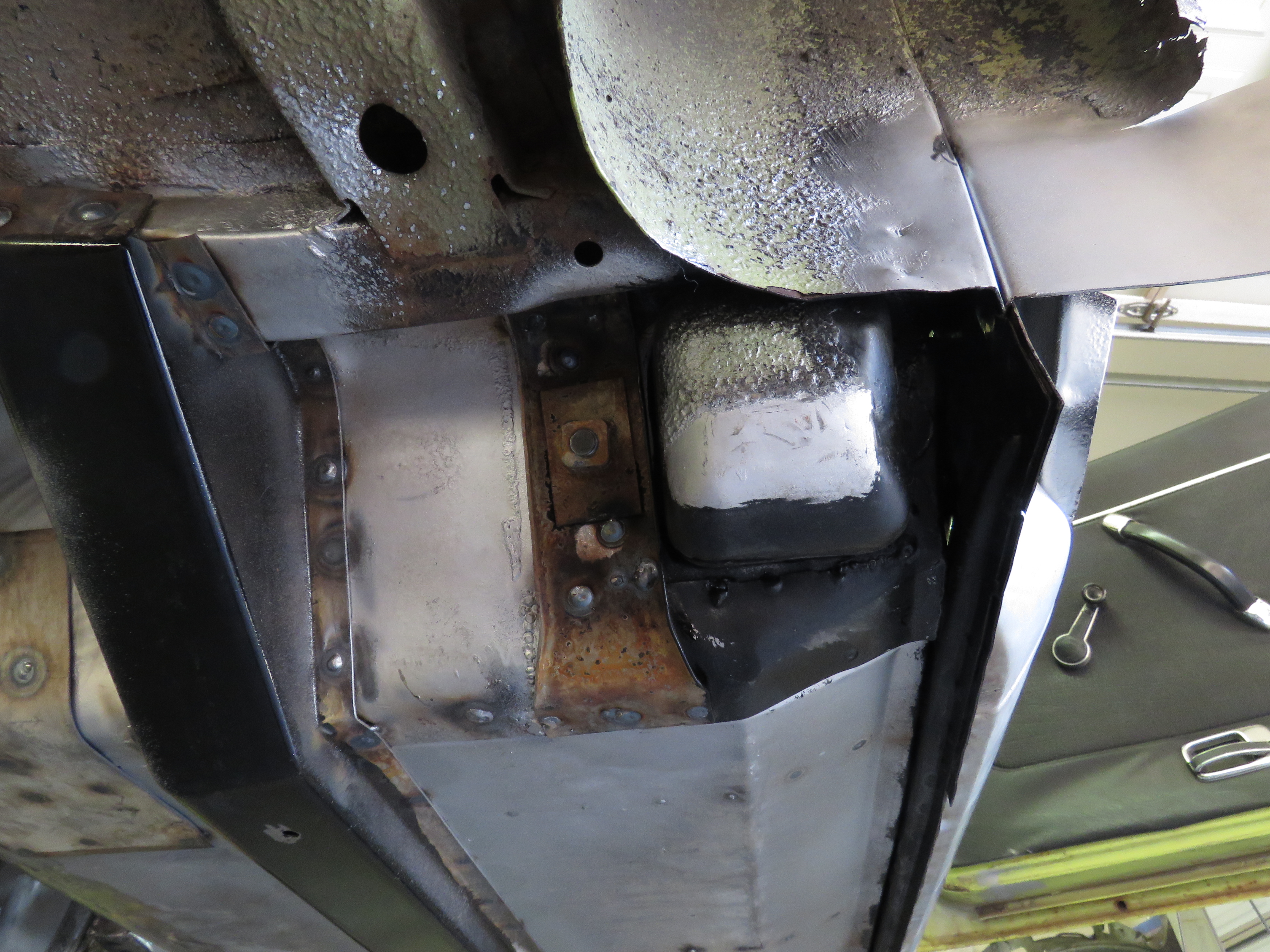

Filled in any rusted holes and sanded down on these parts pictured below.  Coated those parts I sandblasted for the seat belt mechanisms.
Parts welded on. Gonna hold off on welding the tie in plates for the seat belt mechanism housing (not sure what their called) because I have plans to make some jack support braces later on.  The rear jack stand points will be in this area somewhere. Havent planned it out yet in details but will. Besides the tie in plates dont fit that great for some reason, most likely since everything I made wasnt an exact OE fit in order for the seat belt mechanism housing tie plates to fit perfectly.

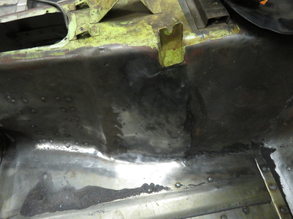

Finally welded in all those holes shut and sanded down from when I removed the original transmission tunnel mounts. Had to make my own and move them back a little ways for the T56 magnum trans for the LS1.
Well thats it for the interior, at least for now anyways.

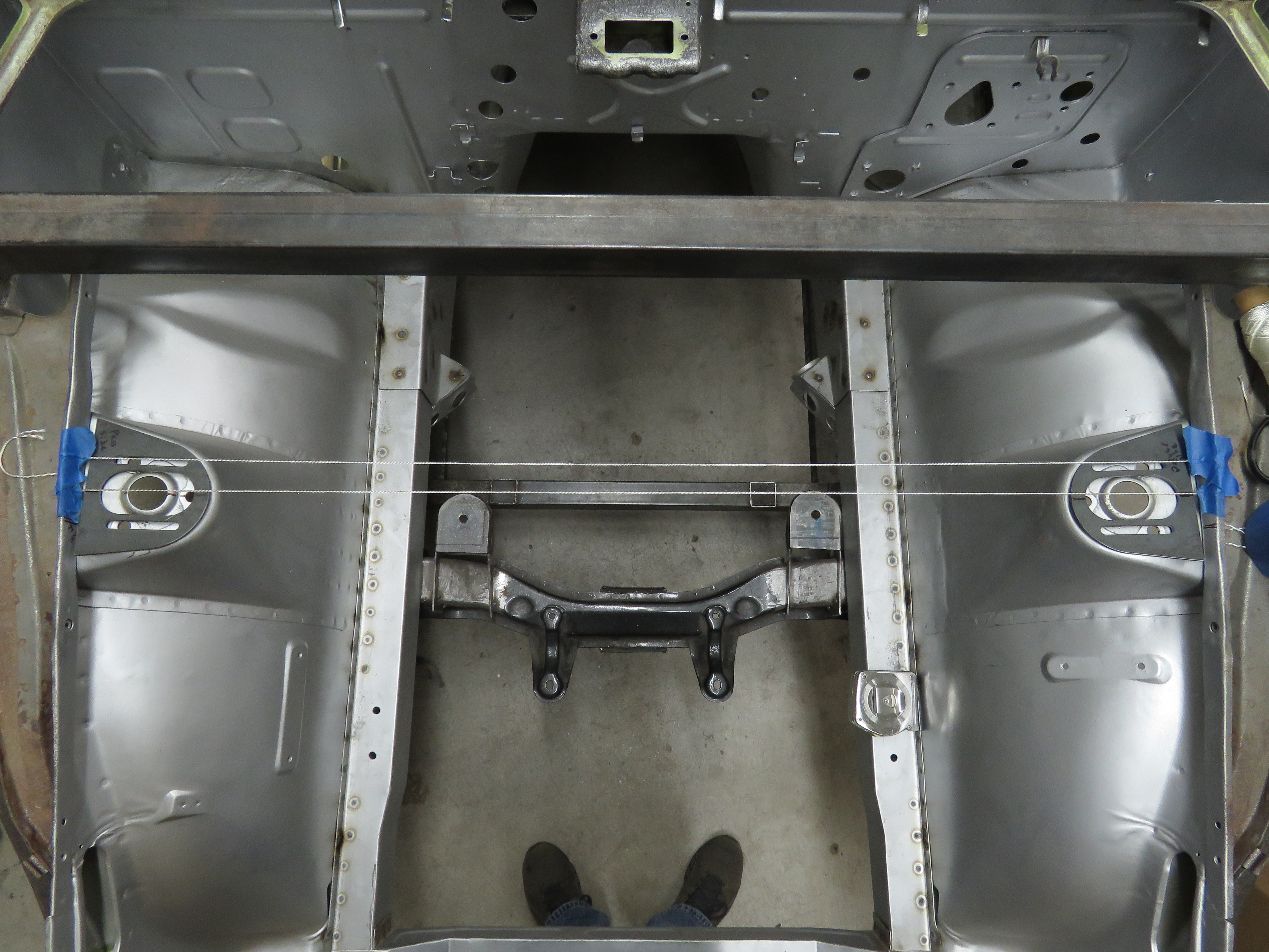

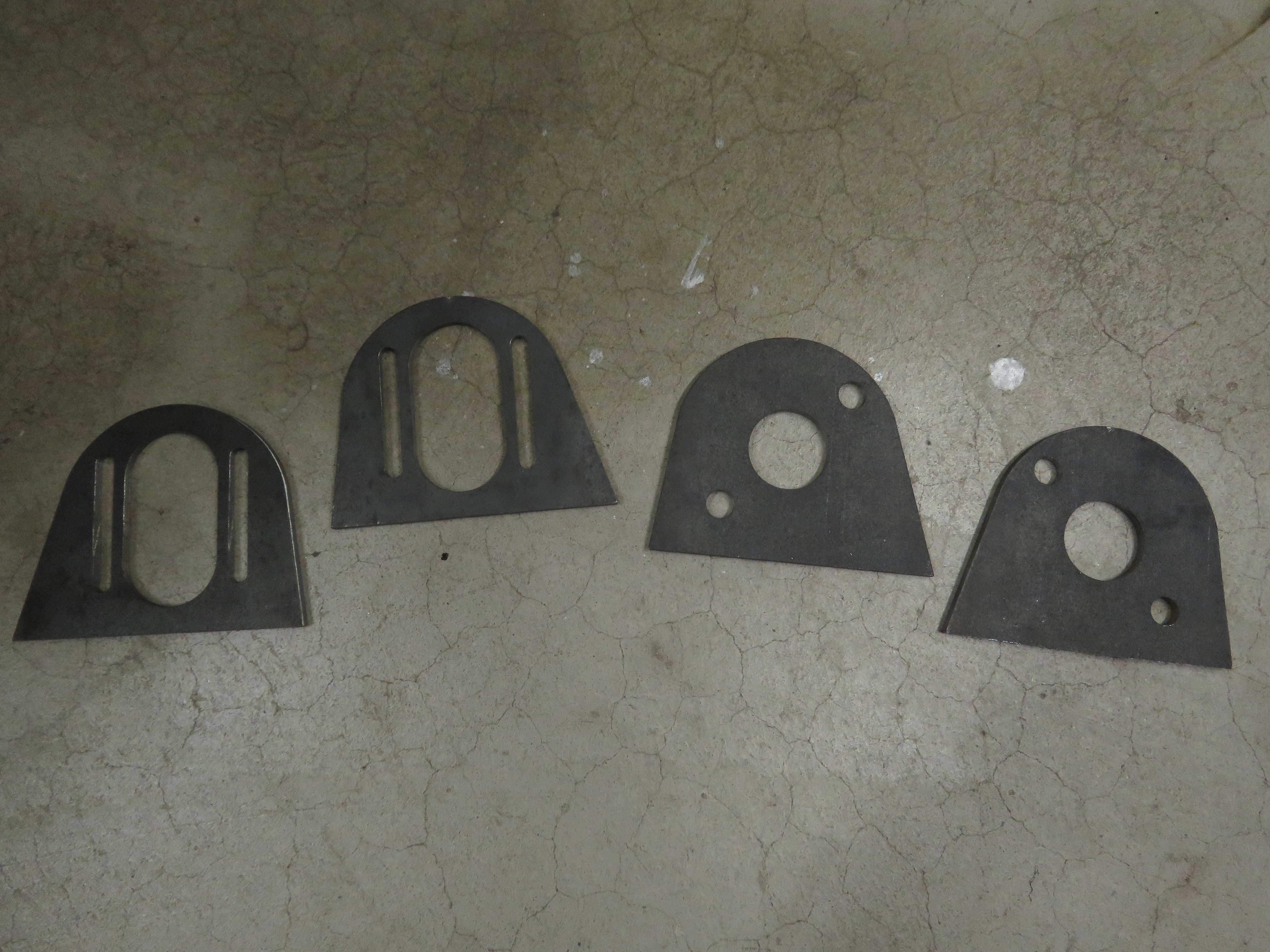

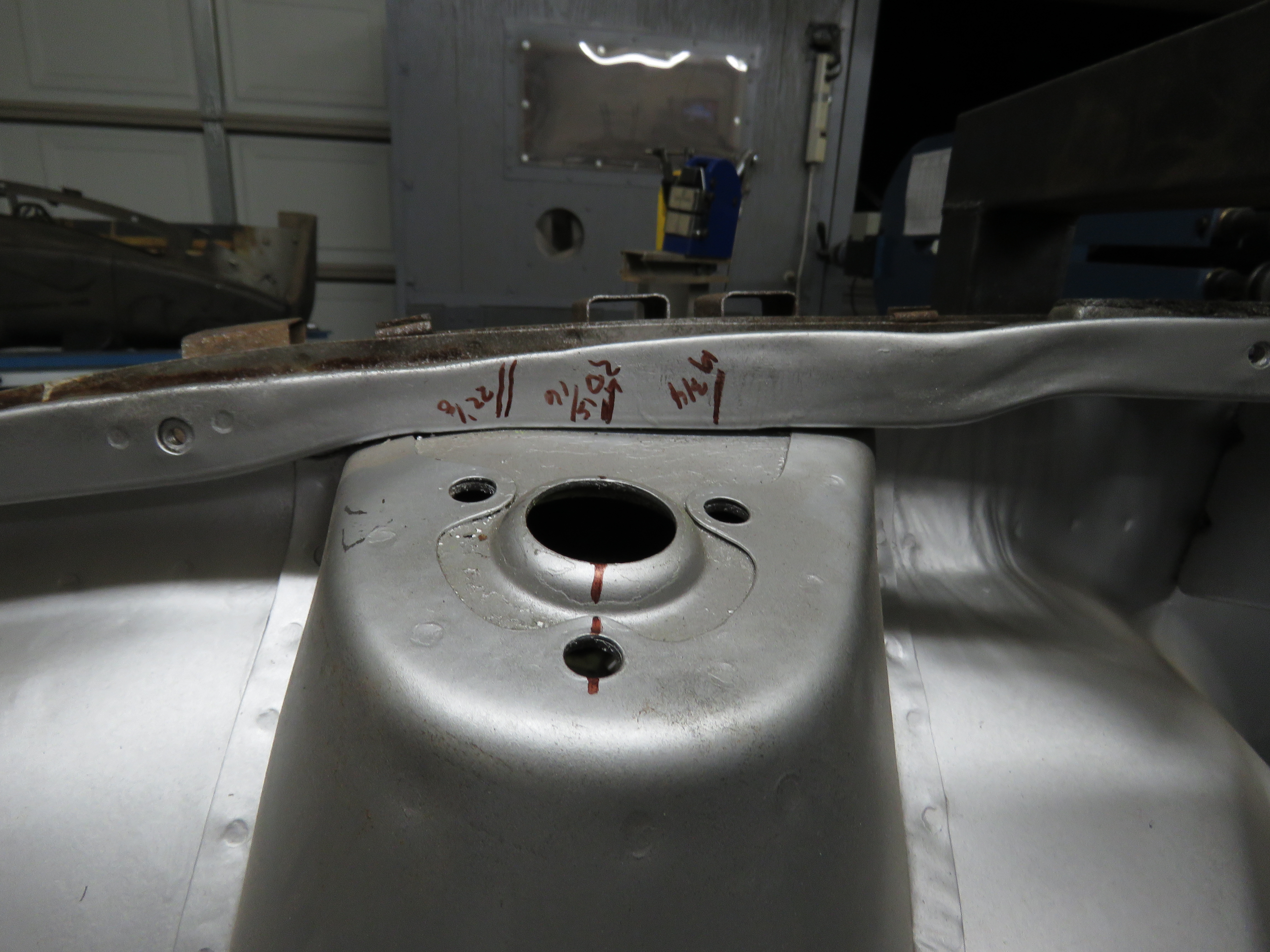

Though before I work on that, I want to get the front camber plates installed. Took me forever to figure out where I had placed them in this mess.
Found them..

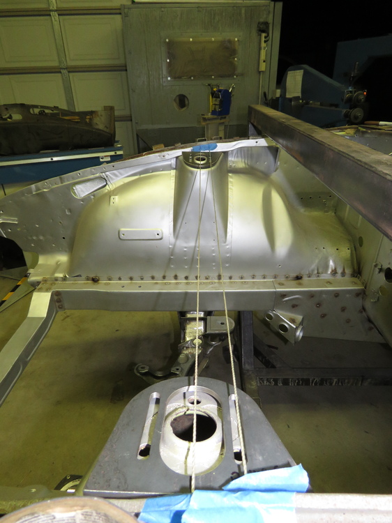

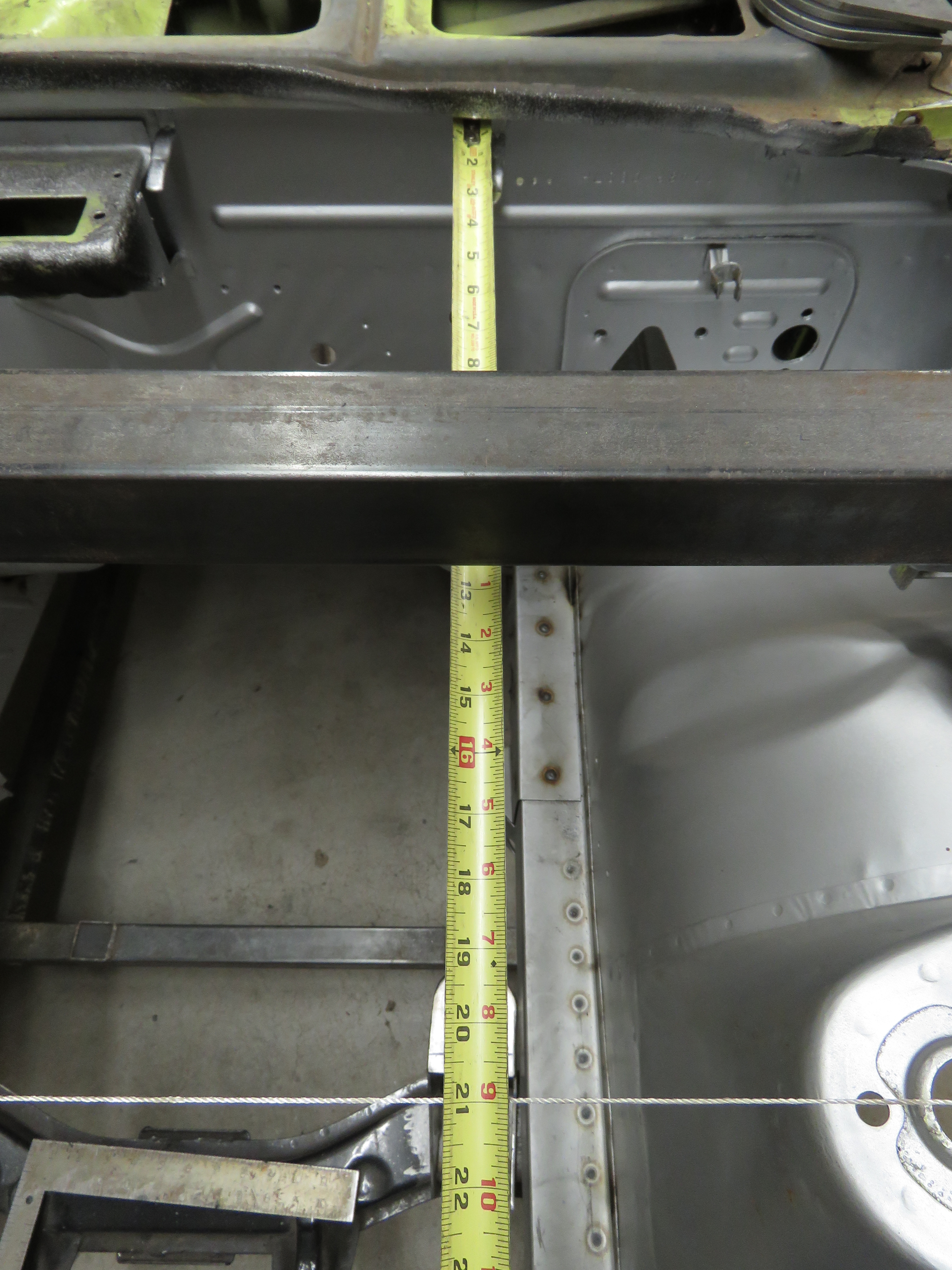

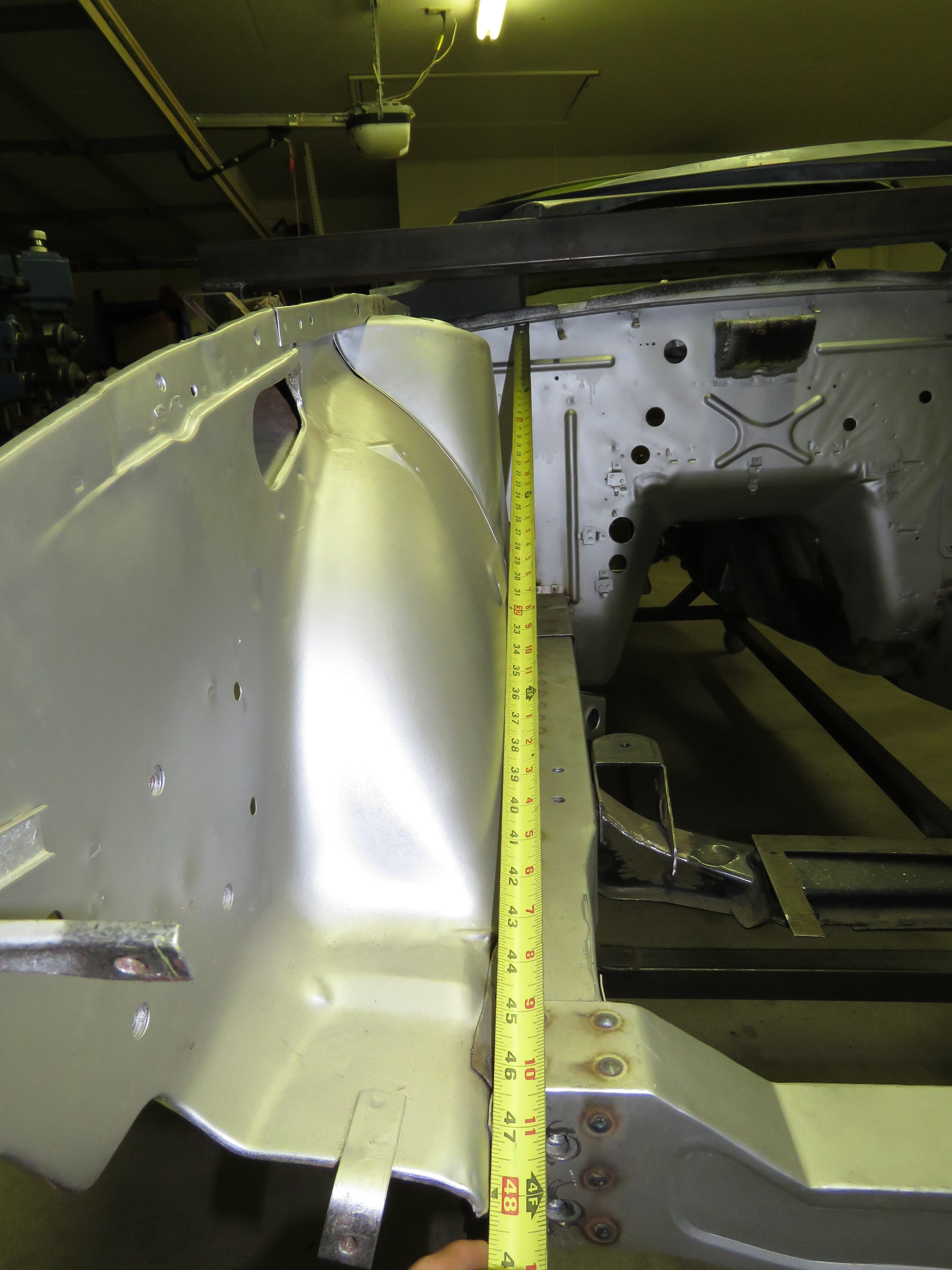

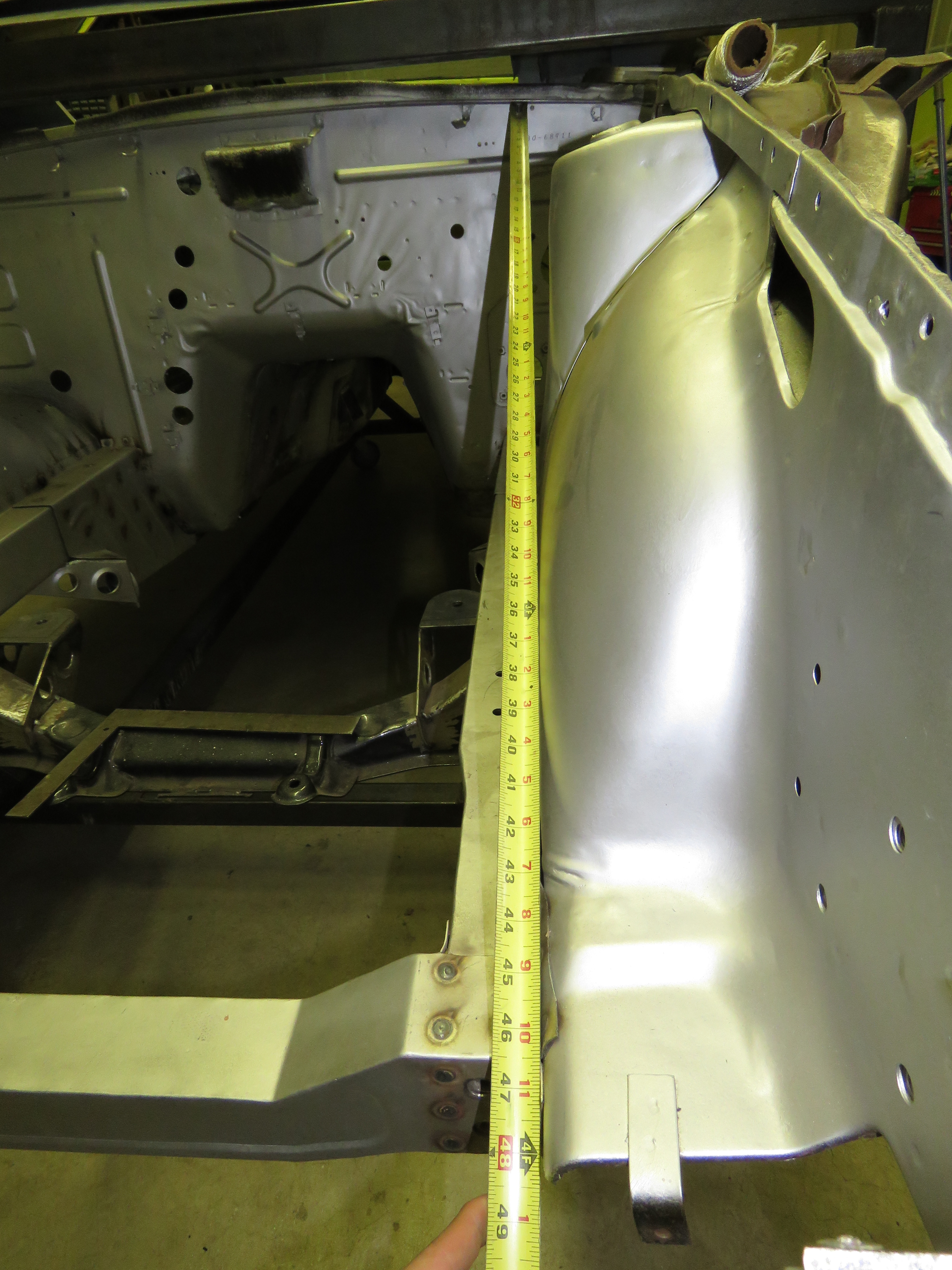

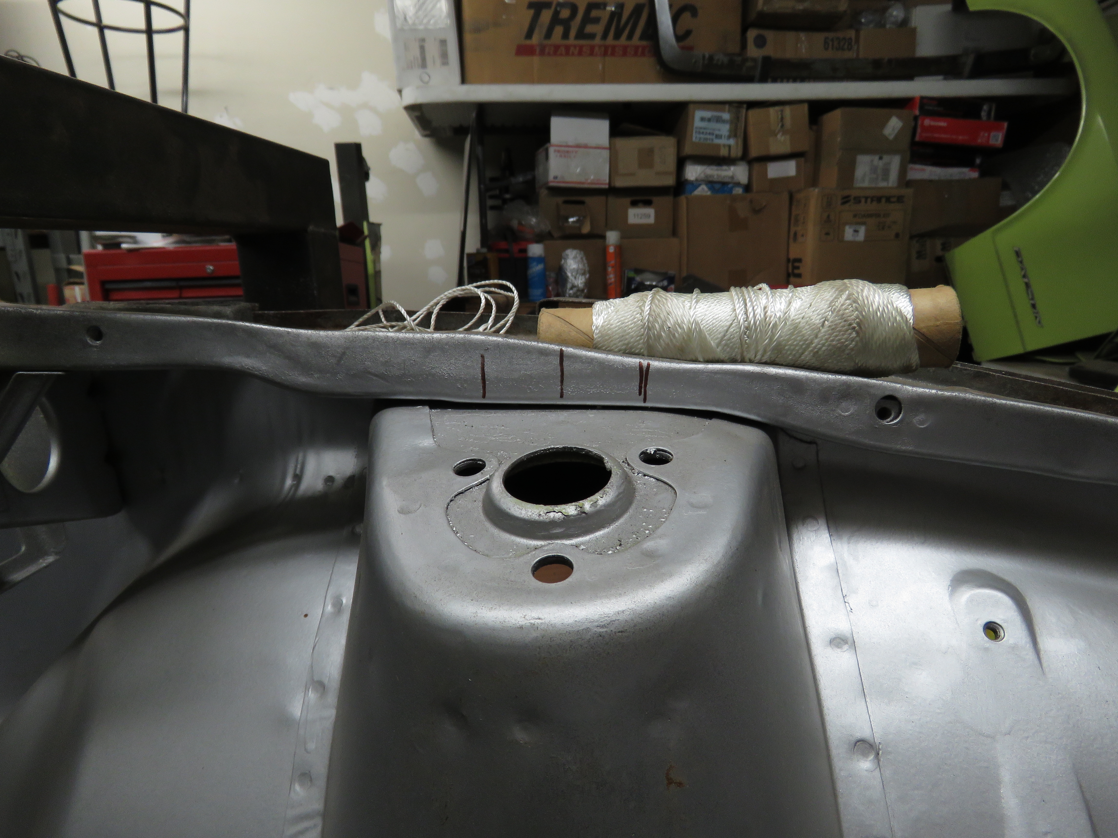

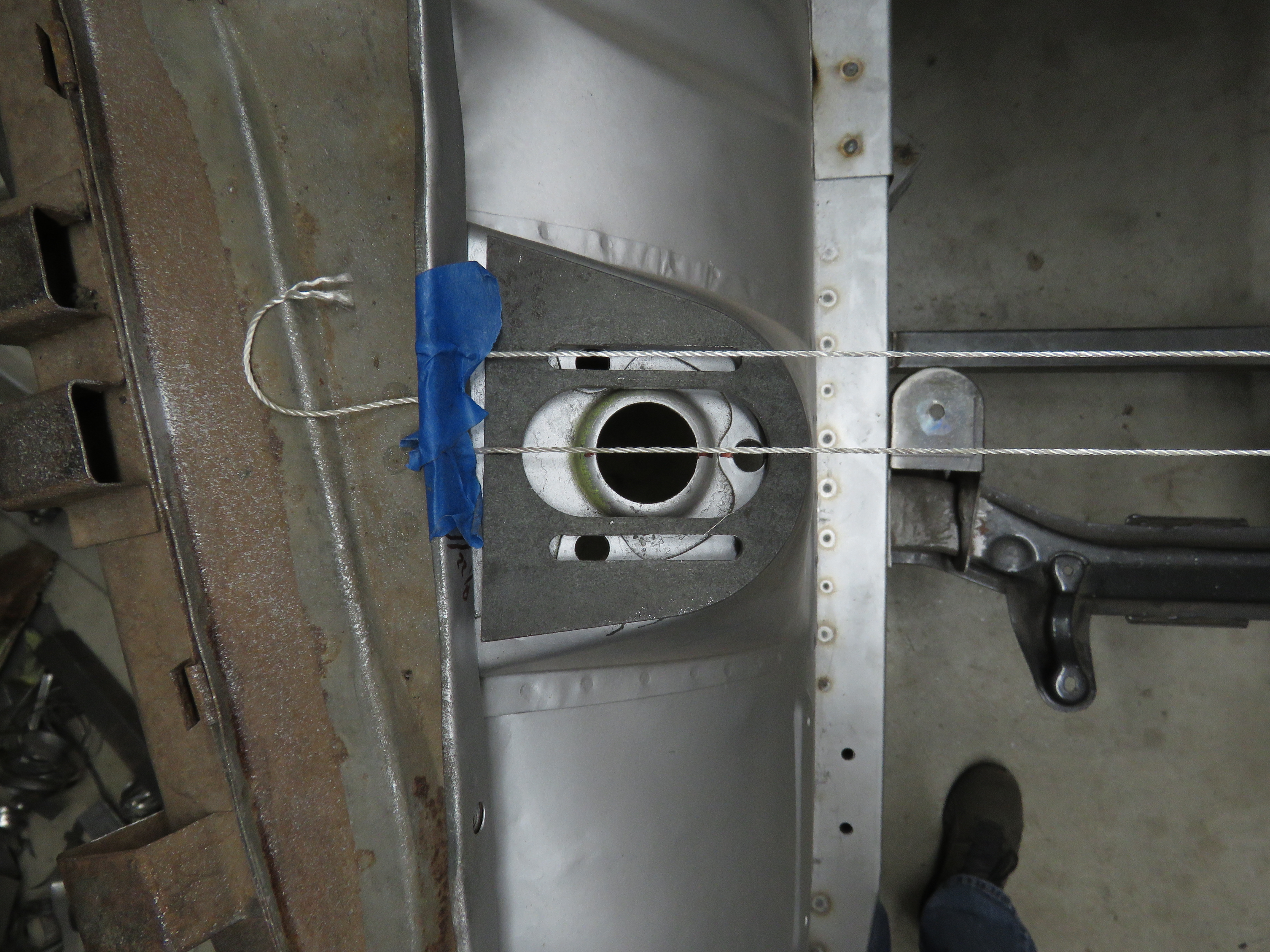

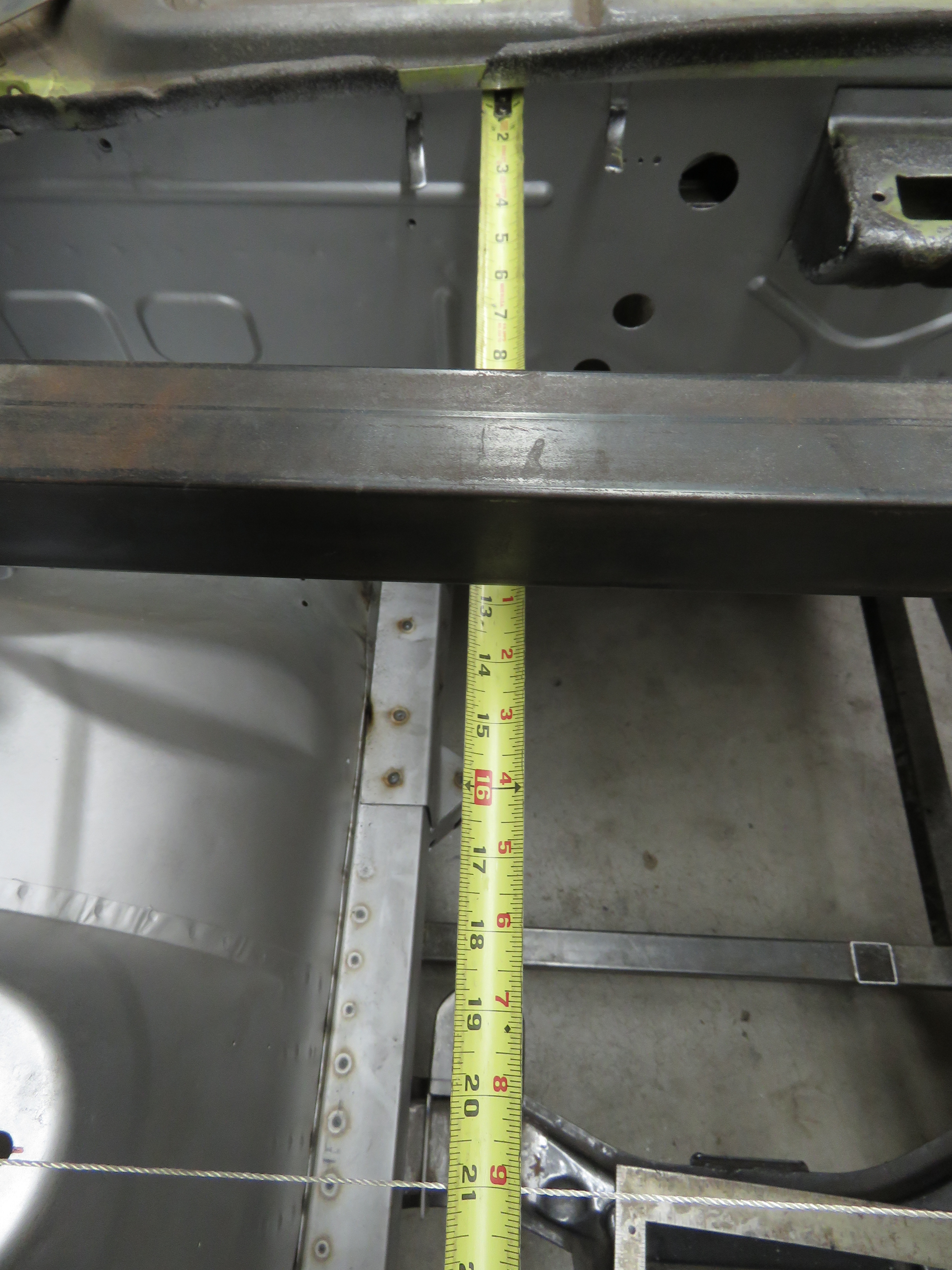

Get alignments made for when its time to weld the camber plates.  Wanted to make sure first that the fire wall was same distance on each side, I just choose two points on the front end of the car.
Marks measured and scribed.
Rough mock up to see how it looks.
