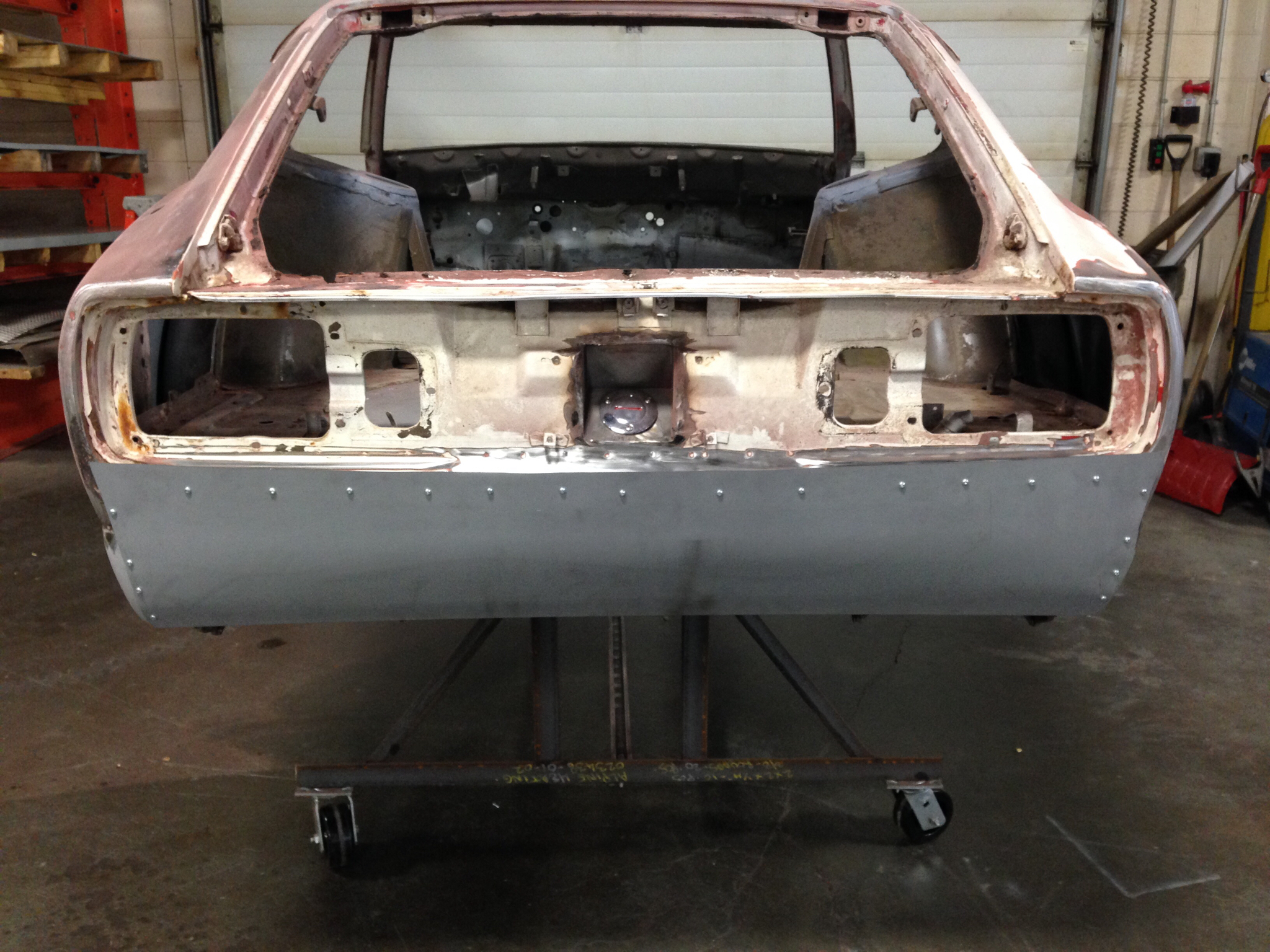

Got the Gas door opening welded shut on the passenger side. As of now havent decided where I want to place the gas filler at, just know I didnt want it where it was.
Started out cutting the flange out. Used the plasma cutter for this.
Used the Belt sander to sand back the indention/lip back.
What it looks like after all that.
Made a replacement panel with the English Wheel. Put a band on the upper wheel and used a lower anvil with a radius similar to the panel. For those that dont know, the band is so the metal gets bend in two directions (left and right), prevents it from bending/shaping the metal front to back.
What it looks like after a round of band wheeling.
I then took the band off and wheeled metal to metal because I need a radius on the replacement panel left to right when on the car as the quarter panel isnt flat from left to right (has a slight curve). Traced out the panel, used the snips to cut it out, smooth out the edges from the cutting, then test fitted it.
IMG_0022.JPGIMG_0023.JPGIMG_0026.JPGIMG_0028.JPGIMG_0031.JPGIMG_0032.JPGIMG_0033.JPGIMG_0037.JPGIMG_0044.JPG
Tack welded in place.
Welded, hammer and dollied,sanded down and coated. So I made a Slapper out of some scrap metal, the thickest I had. Feel dumb on why i wasnt using this before on the other stuff. Thing works great in bringing up the low spots and smoothing out the welding zones. This little project came out better than the quarters, the welding zones are a lot better and smooth. Still might could work on it a little more, but I am happy with it. One thing to note is the replacement panel I made is a little too curved (left to right) and you will see in some pictures how it bulges out slightly from the quarter panel. I suppose I could try to heat it up and cool it down to shrink it some. I used the pulse feature for this project on my Tig Welder, seem to help some with the welds but not much. Ill have to keep practicing. The crease will need to be made with bondo, I dont feel like screwing around with it. I still want to get some body filers for sanding, still looking up on some sites and deciding which to buy.

Will get the side markers shaved and work on some dents in the rear. Stay Tuned!
