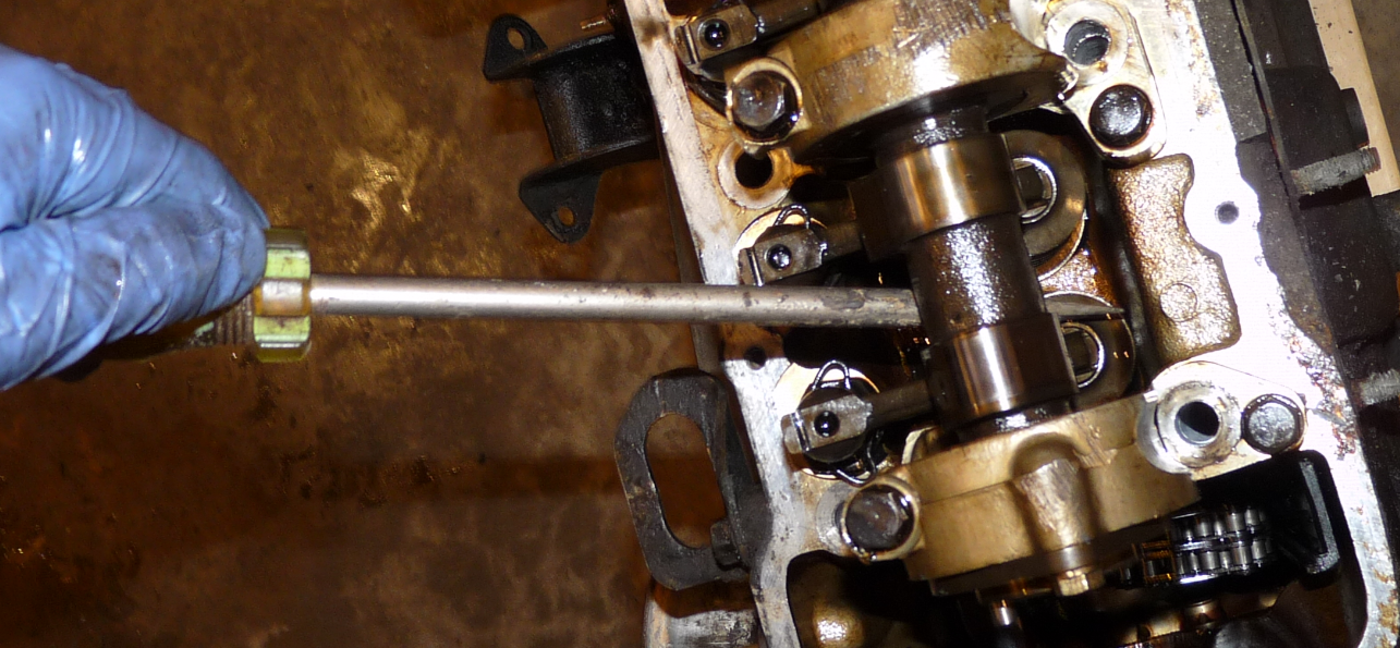

For the rocker install:
  1. Turn cam so that the problem lobe is up.
  2. Install the lash pad.
  3. Place the rocker beside the lowered adjuster and fit the other end into the lash pad.
  4. Rotate the rocker toward the adjuster and try to lift its end up onto the adjuster's ball cap.
  5. If the pressure is too much, you can stick a very large screw driver between the spring retainer and the cam. Pry the retainer down by using the cam body (not the lobe) as the fulcrum.

I just pulled apart a head and took photos for the above procedure. I'll post here tomorrow.
Here is a photo of how to pry valve down so that you can slide rocker in place or out:
