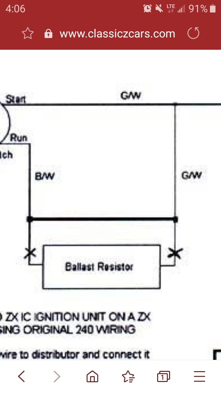

Yeah, that's kind of what I went through back in August.....I had the dizzy installed and bypassed the resistor as instructed...my tach was all bouncy at higher rpm. So I tried hooking the resistor back up and that's when it fried the ignition module on the dizzy.  Maybe I need a different coil? I thought I had the correct ohm version...but now I forget what I have in there.  I'll have to check.
5 hours ago, siteunseen said:
Should be 1.5 for the zx.
3.0 for the z.
I run a Crane Fireball PS20. Seems perfect for the last 3 or 4 years?
Do you have the ballast resistor hooked up with your setup?

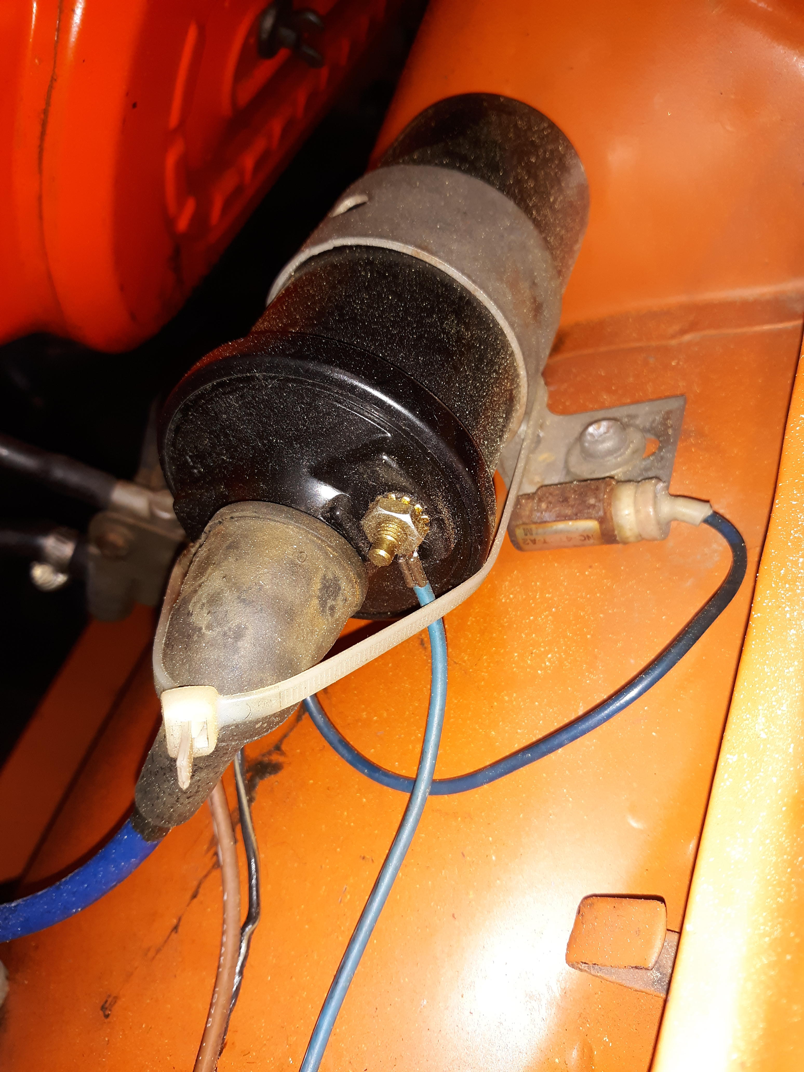

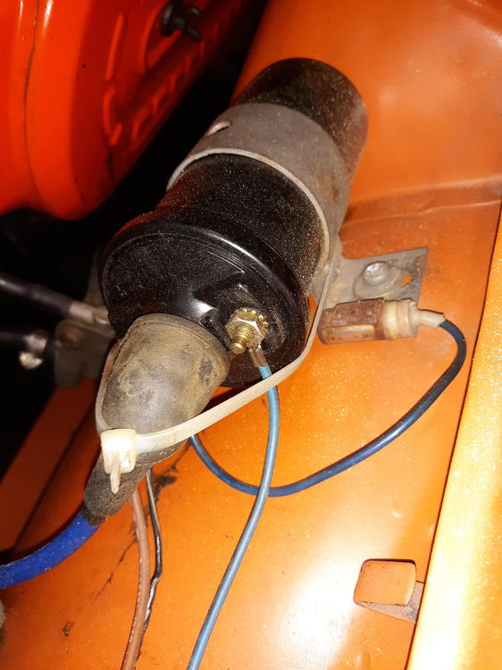

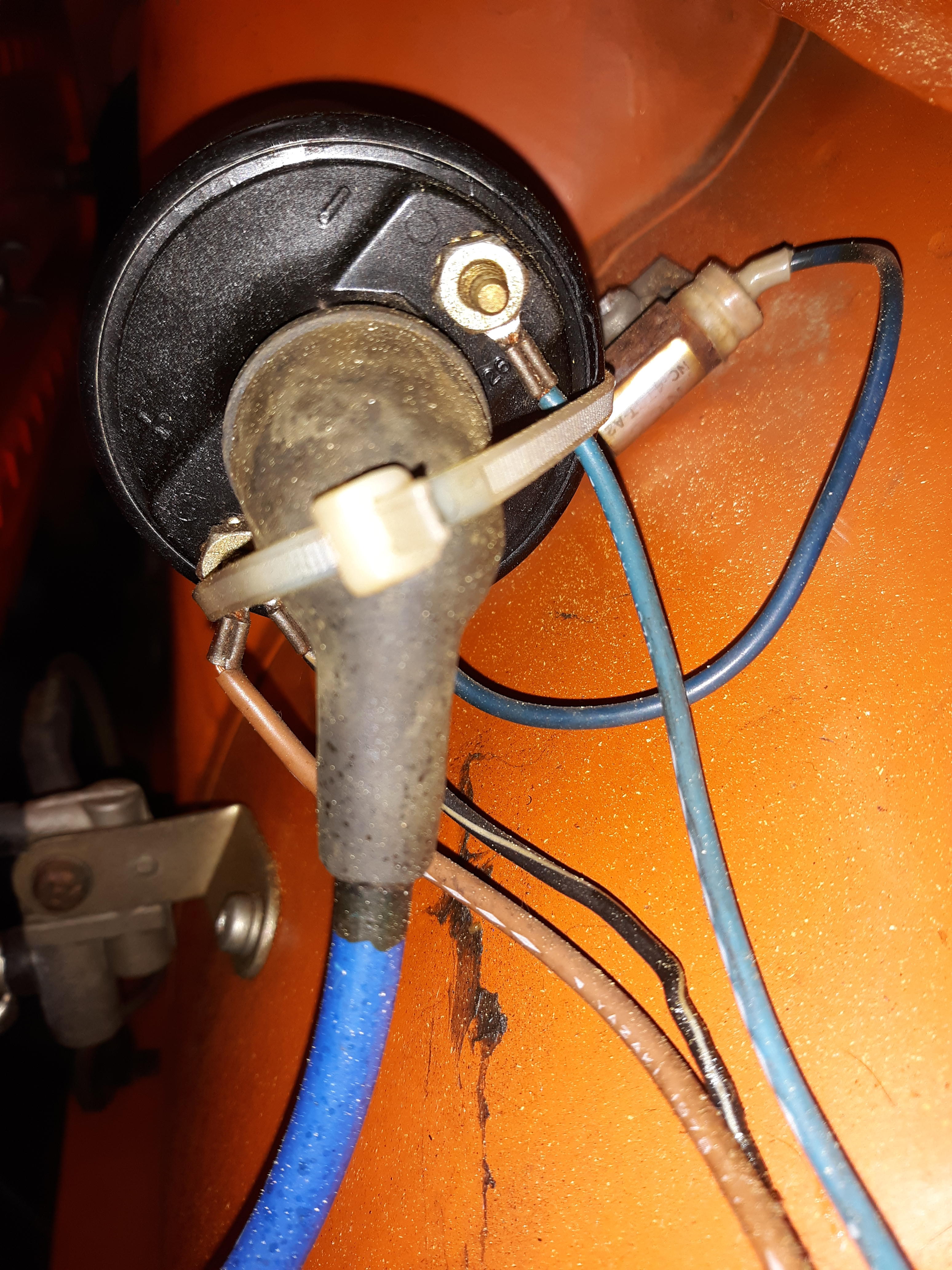

Here's mine. If you need more let me know.
And the reason my wires are different colors than the instructions above is I found a ZX in a junkyard. Got the dizzy adapter and about 4ft. of the ZX wiring harness then spliced it into the 240's wires.
