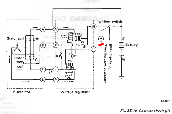

Wow, thanks for the quick reply. I wasn't able to use any writeup actually as I have an alternator from a heated windshield car which has 4 prongs as apposed to 3 in all the writeups. The 4 wire alternator has the 4 that zed head posted.
If I connect the switch the F for the L, will I require a resistor? I was reading so many sources, I confused myself. Surprised that diagram never showed up in my searches as I was looking for exactly that.
The bulb in the L wire on your car is a resistor.  I have read though that the CS alternators don't like too much current on the L wire.  I'll see if I can dig up the reference.

Thanks Zed. I didn't actually think the 240z had a light, that's why I'm wondering about the resistor. Maybe it does and I'm just out to lunch? That first link you sent made me worried is it says without a resistor can damage the alternator.
Looks like L comes through the ammeter shunt.  Probably some resistance there.  Where's the electrical guys?  I'll step away.........
Edit - I think the above is wrong.  The 260Z diagram is hard to trace, all black and white.

No, thanks zed head. Really appreciate your input. The '71 manual is the one which is missing in the library so I'm weary of believing the newer model diagram. All I know is I don't have a light (it's in the console correct).  Hopefully someone can answer this as it's really tempting to just swap prongs, and start it up.
