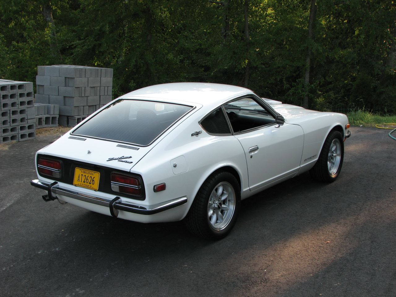

You guys are awesome....I love your creativity.....grannyknot, I'm impressed....Careless...where is the final shot of your first Resto? I know how you feel....once restoration is done, you're ready for the next.....the fun is in making something ugly beautiful again. How's this for a before and after.....

That car is still in the works. I will update that thread soon. I had been making templates from the car you see above so that I can prepare the sound deadening sheets that the body shop who did the work forgot to put back in the first car before painting it. Really causes a big headache when they do that. So once that is done, I think the interior will come together fairly quickly. There will be a couple of things missing but I'm making note of everything and making sure it's stuff we can change later.
Your white Z looks similar to a white Z i might own soon :-)
