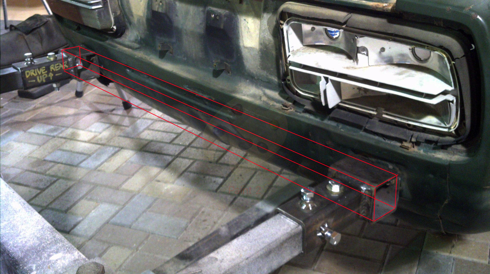

The mounts i am using are the ones that came with the rotisserie. the ones i made slip over the end of those. the only length I added is the horizontal 3x3 cubes mounted to the car. the rest of the mount itself that i welded to is 100% fully supported by the original rotisserie mounts. what i mean by that is ... the original arms go all the way to the end of the tube that is slipped over them, and actually touches the 3x3 cube from the inside. I only added about 3.5 inches to the length of those arms. I don't understand how that could be too far or how we have the same rotisserie in this case. Mikes photo with the red tube is a good depiction of how much material i added.
Here's a photo of a nearly identical hoist:
the arms shown there look to be the same length, and the mounts seem like they're no more than 2 inches shorter than what I've come up with.
