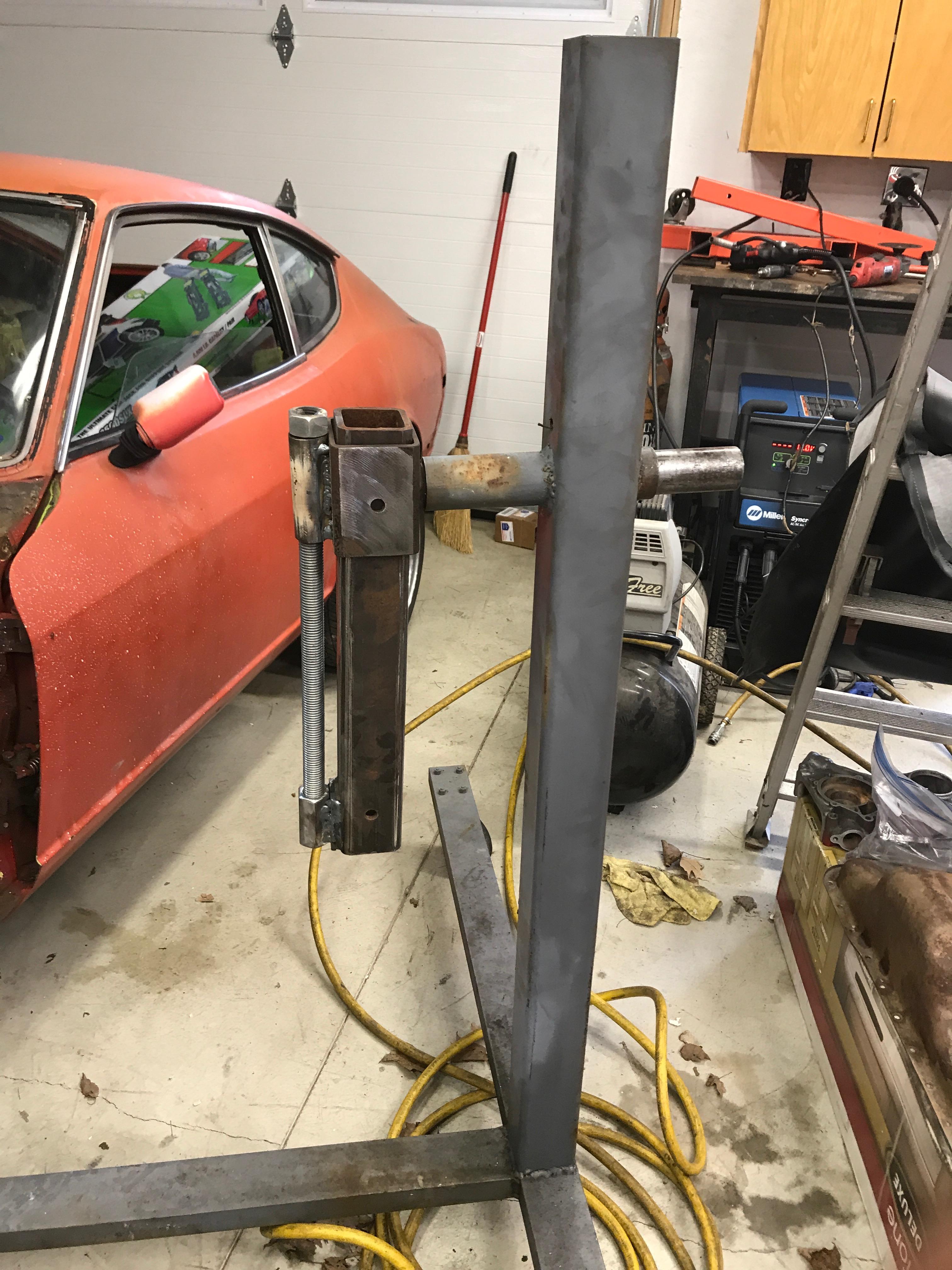

Ok, I will admit that mounting the car using the bumper mounts seems flimsy but once everything locked into place the car is solid and easy to roll over. I built my rotisserie.
Sent from my SCH-R970 using Classic Zcar Club mobile
Seems like the bumper mounts have thus far been adequate. It's currently being blasted but the weather is not playing nice. far too much humidity to complete the job right now.
The flex shown in the photo was due to the rotisserie itself. I added shims between all the sliding points on the roti and it straightened right up. Once it was all straight, I loosened the center connecting bar and realigned and re-torqued it while the car was held straight, and so far the blasting guys haven't had issue rolling it around and flipping it over.
now if the humidity drops, they can complete the job and I can deliver it to the body shop. even some snow would be welcome at this point!

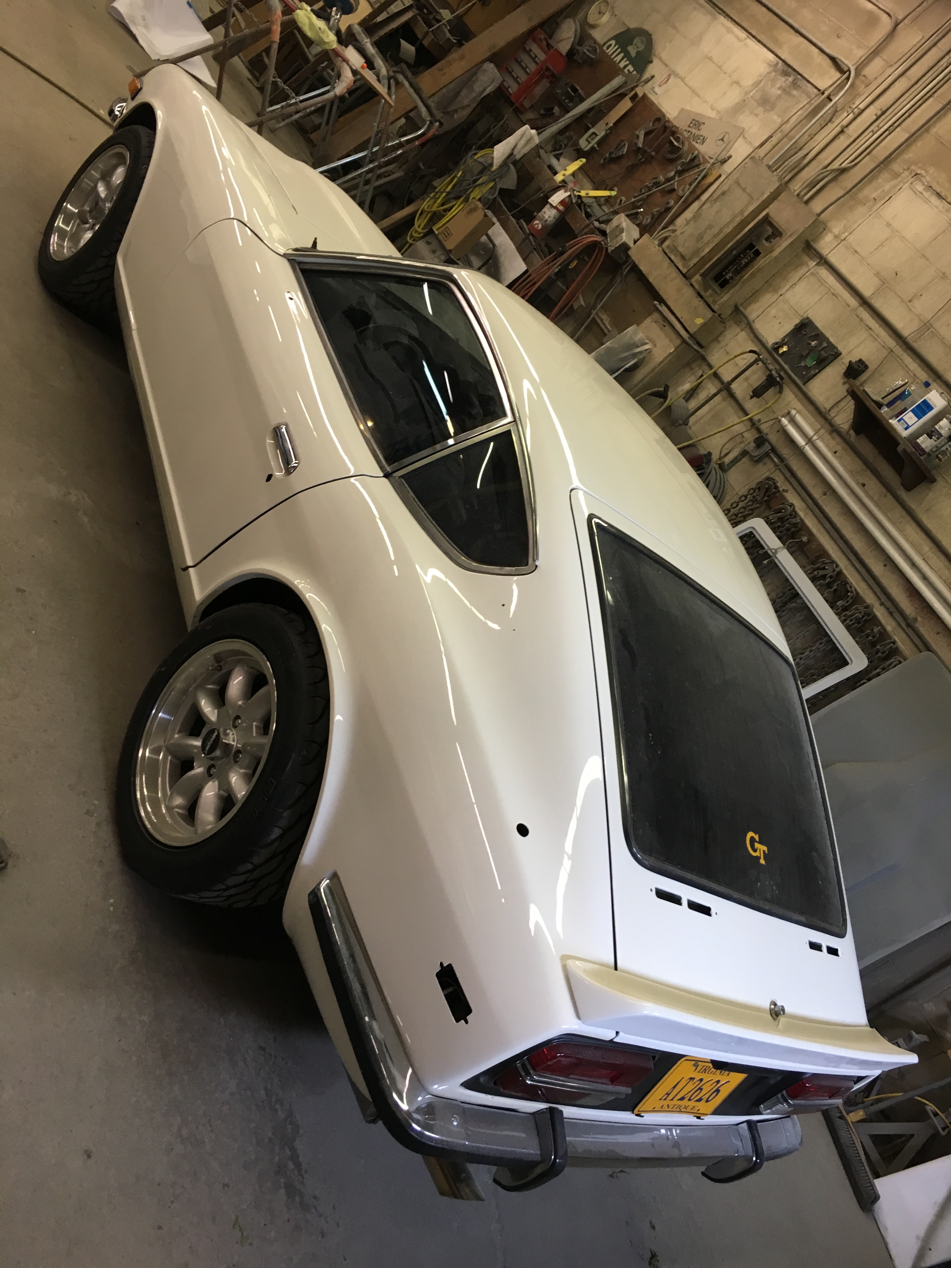

On 10/23/2016 at 8:46 AM, Diseazd said:
How's this for a before and after
Diseazd:
Looking at the photos once again, I think you've nailed the stance perfectly on this white car.  Can you please advise on how you got it there...
  • spring & shock set-up?
  • tire size?
  • wheels? (esp. offset)
  • anything else done to affect (or allow) the ride height?
Also:  What type of chin spoiler is this car wearing?
Thanks Namerow.....The white Z is running Eibach springs with Tokico blue shocks. I'm running 16x7 inch Panasport wheels (not sure of the offset) with 205 55 16 Goodrich KDW's. The chin spoiler is the fiberglass BRE Spook from Motorsport. I've since this post, added a rear spoiler.

So I thought I would tag on to this thread with questions about my rotisserie build. As you can see I’m not very far along , but need to think about how high the car needs to be to clear spinning. I’ve built In adjustability on the main bar so I can adjust balance once I get it close. I know it doesn’t have to be too high to clear, but I figured 36” at the center?
Still not sure about where I want to mount the front end. I was considering using the sway bar mount points along with the tow hook holes under the frame rail. I know the bumper will hold up- but I also have repair to do at the radiator core and the right bumper mount. Might be a mute point because I might fix the radiator core first, but still considering mounting at frame rail.

That seems like a lot! So how many inches does the body clear the bottom bar at its closest point? These cars are 60+ inches across , so I thought 36” would be safe . I’m hoping I can jack car up high enough with my Quick jack ,  to not have to put hydraulic jacks on the rotisserie.
i guess everyone’s set up is different as far as contact points, so it’s hard to compare notes .
18 hours ago, madkaw said:
5” is pretty good , so centerline could be lower depending on center connecting bar height.
Thanks Charles
Maybe, It will depend on how you mount it and where neutral twirl is. I built my rotisserie for more than just this project and the extra height helps me not worry about contact.
