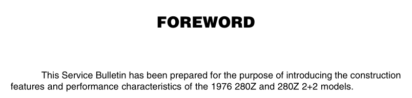

Generally people seem to say that the harder seats didn't show up until the N47 head, I think.  But Nissan does mention hardened seat materials in the 1976 Service Bulletin.  Seems like if they reported it in 1976 then the engines before probably didn't have it.  I'd say "unlikely".
If the valves and seats wear your valve lash will close up.  That could be a maintenance check to do, to head off problems.
Edit - might as well post the words in.  Pictures below.
