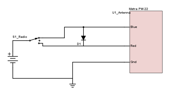

If you want a new-design antenna to work with the switch, you'll need to add a diode between the blue and red wires, then connect the hot-when-up wire to the blue wire, and hot-when-down wire to the red wire on the antenna.
My schematic skills are rusty, but this shows what you'll need to do to make it work with the switch: both blue and red need power to go up, and only red needs power to go down.  The way I accomplished that was to put a diode in between the blue and red leads.  You'll need a fairly beefy diode to make this work.  I just went to Radio Shack and found a big rectifier diode that was something like 400V@5A rating.
Your mileage may vary, but I found that the L/R wire was hot when I pushed the switch "up", and the L/W wire was hot when I pushed the switch "down".

He's right.  You can't just hook up a switched power wire to one of the new automatic powered antennas.  You can use the factory-style antenna switch, but with the modification as indicated.  I used a micro size DPDT rocker switch on my antenna, but I first rebuilt the motor with new brushes.
