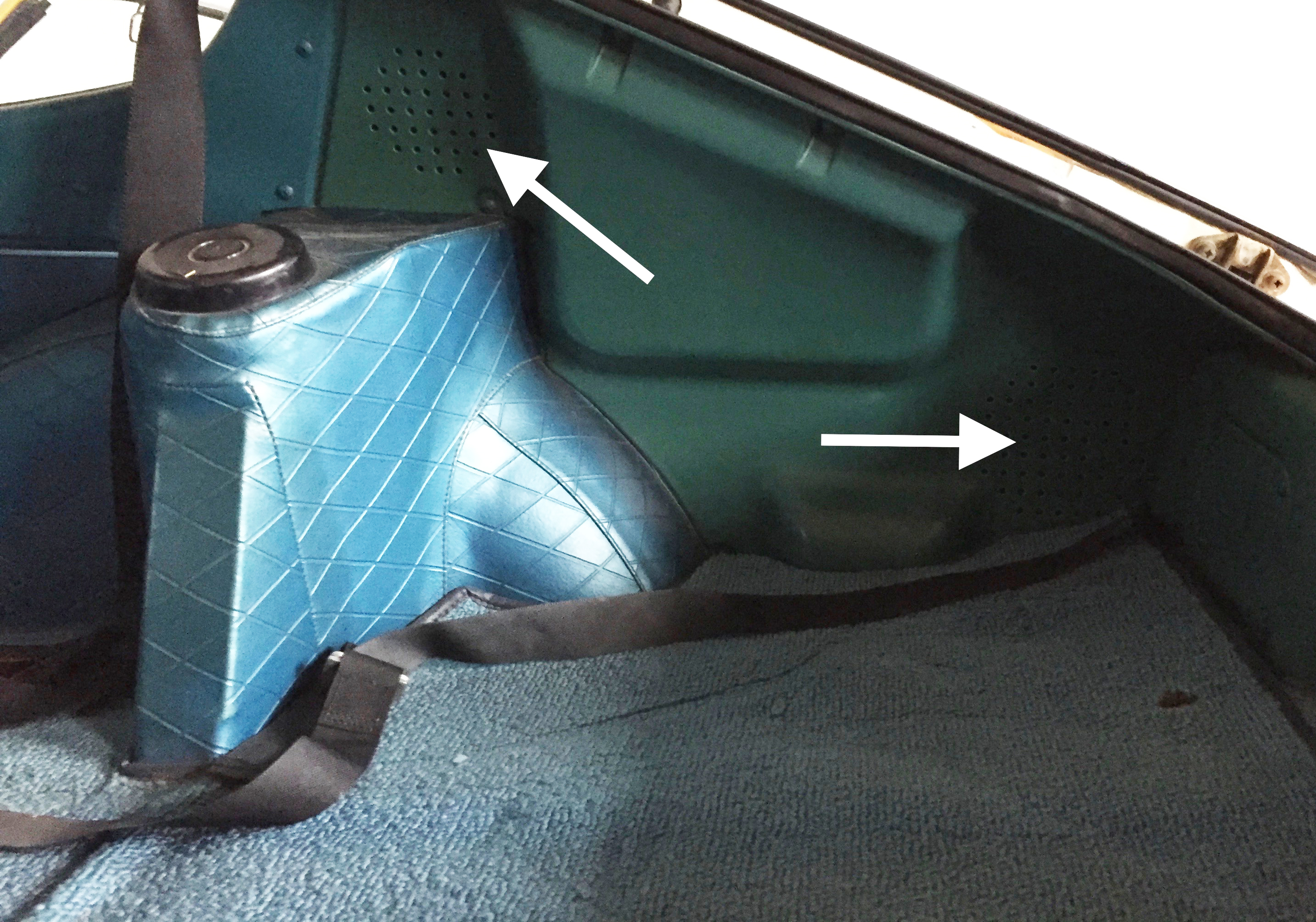

@delsol  the upper perforated areas that you have indicated are part of the cabin ventilation system, not speaker locations. Here is an old thread discussing this, see thread item 10 for an image showing the ventilation routing through these areas.

I saw that there are two openings for speakers on each side of the rear side panels. Looks original to me.
Thats why I don't want to go with the speaker panel because I want to keep the interior as original as possible.
The factory did not put speakers back there. The area on the left is solid behind the plastic panel. The area in the lower right can be creatively used to mount a speaker. I've done it. You could put 5 1/4" speakers in the rear side and buy the custom kick panels with speaker holes for up front. You could mount boxes behind the seats or under the dash. They aren't the best locations acoustically but they can go there and not really be noticed.

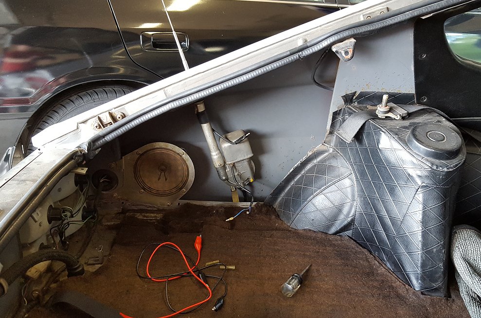

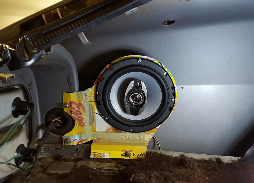

You are only limited by your imagination, selection of tool, and the skills needed to use them.  When I was planning to stick with my AM/FM/CD/BT radio I was going to install two 6.5" speakers behind the plastic trim panel.  Using an Eggo waffle box (leggo my Eggo!) I started making a rough template for the driver side.  After examining it I had my doubts if there would be room for the power antenna and I decided to install a factory AM radio so there was no need for something this big.  I abandoned the project but your car came with one 5.25" speaker just like mine.  You could use the original mount as a template to cut out another mount for the passenger side and have dual rear speakers.  Some cardboard for making a template, a sharpie, some flat 20-22ga steel, and an assortment of tin snips should help you get what you want.
