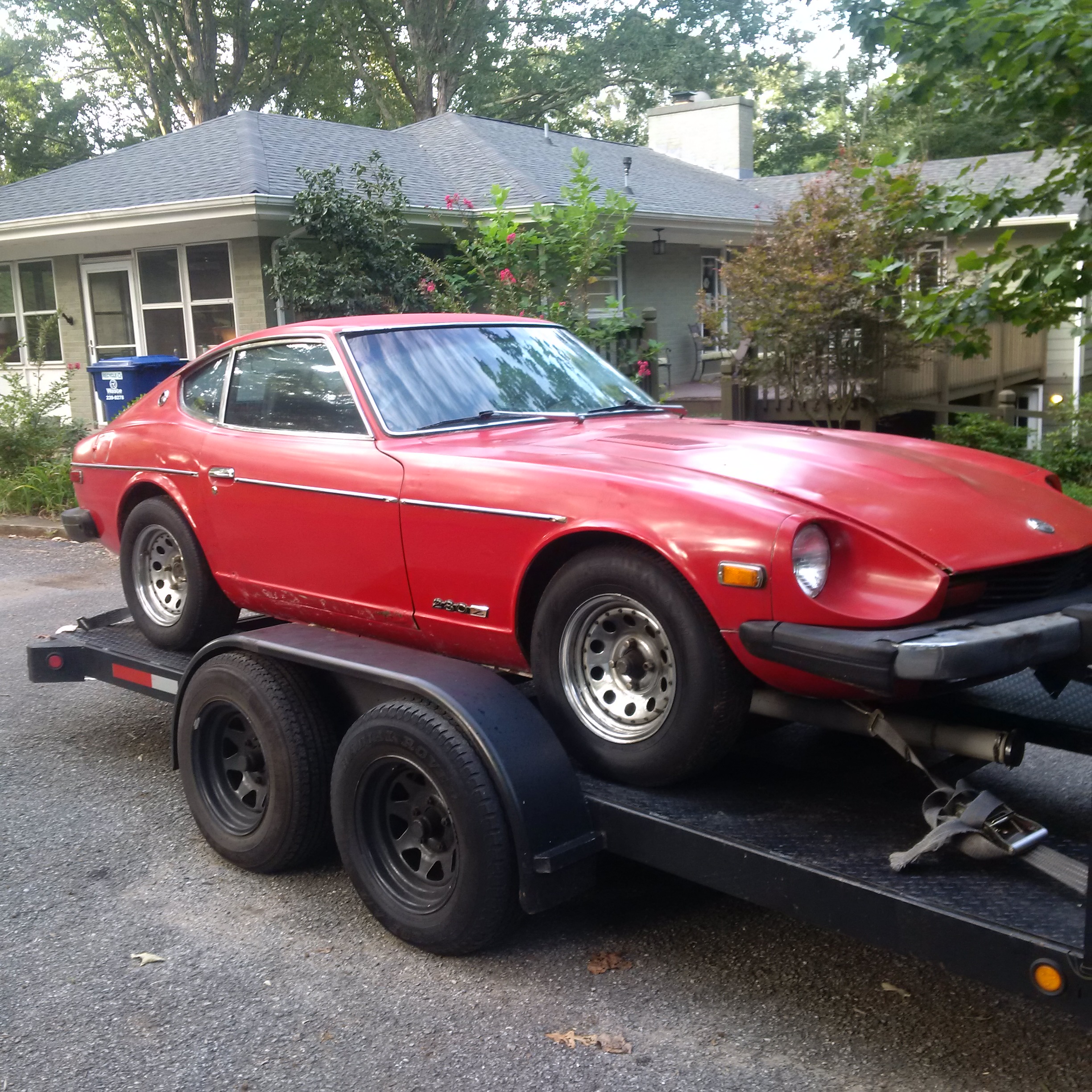

found this on craigslist  looked ok in the pictures so I drove 5 hours and bought it , paid 2k  probably a it too much but hey..
1) the plan
when I first got it, I was going to tear into it and start restoring it right away.  on further thought I am going to get it running and driving upgrade and enjoy it as a beater/ rat rod  and "restore" it later
2) rust assessment
first I inspected it for rust .  when I looked at it before buying the rust seemed like a really mixed bag, no rust in lots of typical areas but seemingly bad rust in others.
no rear hatch rust, nothing in the rear quarters,no front frame rail rust,  very little bit of bubbling in the rockers, one lower front fender was bad but the other was very good. and only the drivers side pan was rusted, but it was pretty bad.  both doors have quite a bit of bubbling along the lower edge , luckily I have probably have 5 doors sitting behind the shop

Congrats on the acquisition Plucker!  Sounds like a to-do list is getting put together fairly quickly.  Are you going to keep the FI system or run carbs?  I think your plan of getting it up to scratch as a driver is the best idea.  Once you have some seat time you will figure out how far and in what direction you want to take certain aspects of the car.  Based on the picture and info I think $2K is pretty fair.  Prices seem to be all over to map for everything these days.  You drove 5 hours which means you really drove 10 round trip so as they always say "the best time to buy something is when it is in front of you"  I look forward to your updates.

I hear ya on the triple Webers.  If my car was not an early VIN car and so original, I would invest in a cam and some triples.
Traveling for work and buying a vintage Z, there is something to be said for good planning and efficiency!

I'm Redwing, a "mature" lady of 74. I have the sister to your red Z,  my '76 RedBird.  I bought her almost 2 years ago.  She came from Scottsdale, a 1 owner car.  I was exceedingly fortunate to get her, she is in real good shape.  Does not have the rust you mentioned your Z has, but she had a myriad of senseless problems, to which my friends here helped me with.  The final thing that corrected the last of the dogging problems was to put in a new/old ECU.  Once that was installed, all other problems vanished.  She is a super driving car now, quite the sweet little lady.
I was told about your joining and how much your Z looks like RedBird.  I have to agree.  Did you say yours was a '77?

yep.. red bird looks almost like my car !  yours looks much much better though !
