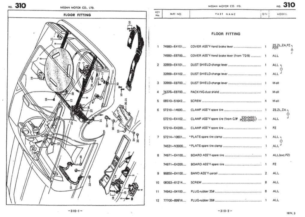

Do you think a little reinforcement will be needed on the underside? Thats quite a bit of leverage it has and the mounting points are small and might bend the floor if someone pushes their feet on it
hard. Just a thought. I've never looked at one that was installed from the factory.

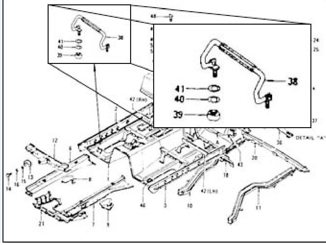

I was thinking the same thing, a large washer or flat bar brace for support. I looked up the part in the S30 parts book and they only show two flange nuts for mounting. I wonder if they had built in some reinforcement. They show the foot bar and nuts as "Optional"

That is interesting my fiche looks different for this slide and only shows two flange nuts. I would still use a big washer under the car for sure, perhaps one on the inside as well.
One thing i've noticed is Nissan sometimes leaves out the fine details in their drawings when they're covering a large area or lots of different parts. You have to drill down as far as you can in the manual until you can hopefully get a diagram that is more detailed.
