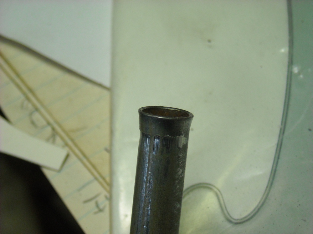

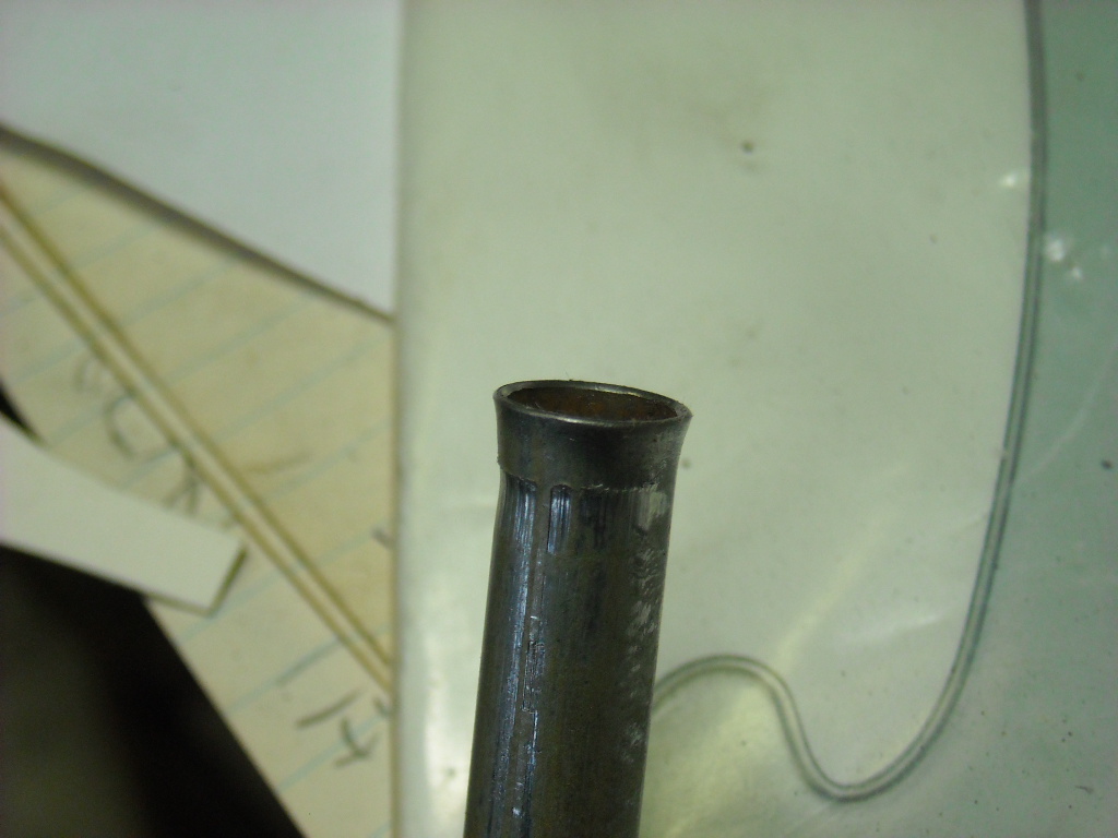

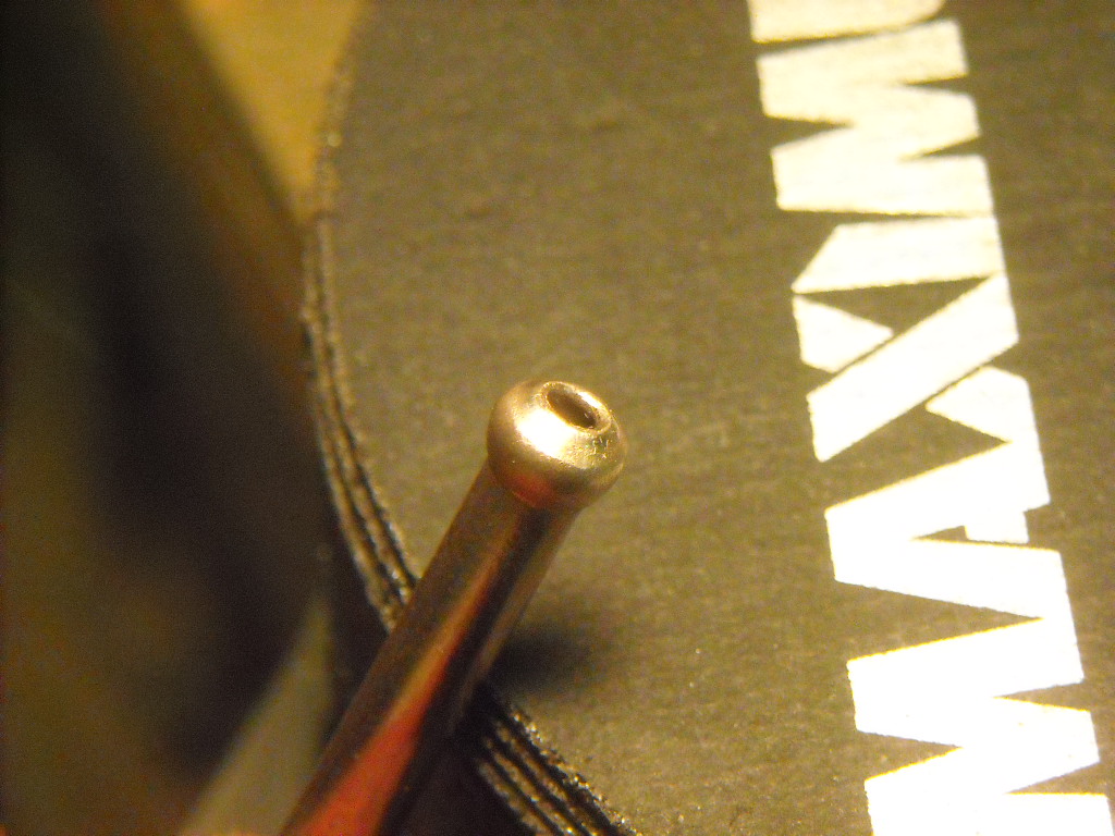

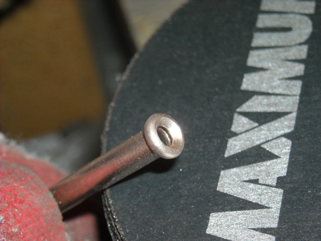

My PO did the same thing with the slight single outward flare on the fuel lines and it was a pain in the tuchus. Difficult to get the rubber started over the flare, and cut up the inside of the tube over time.

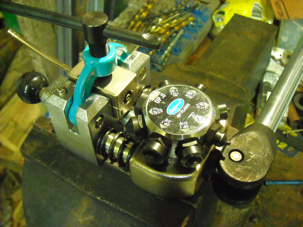

What I found worked a lot better was partially formed bubble flare. Do step one of a bubble flare, but don't push it out quite as far. Just enough to get a bulge that will keep the hose clamp from slipping off.
Yup, like that. I would go a little more with the bulge. Essentially do what you can try to recreate the shape of the bulges on the original fuel and coolant lines.

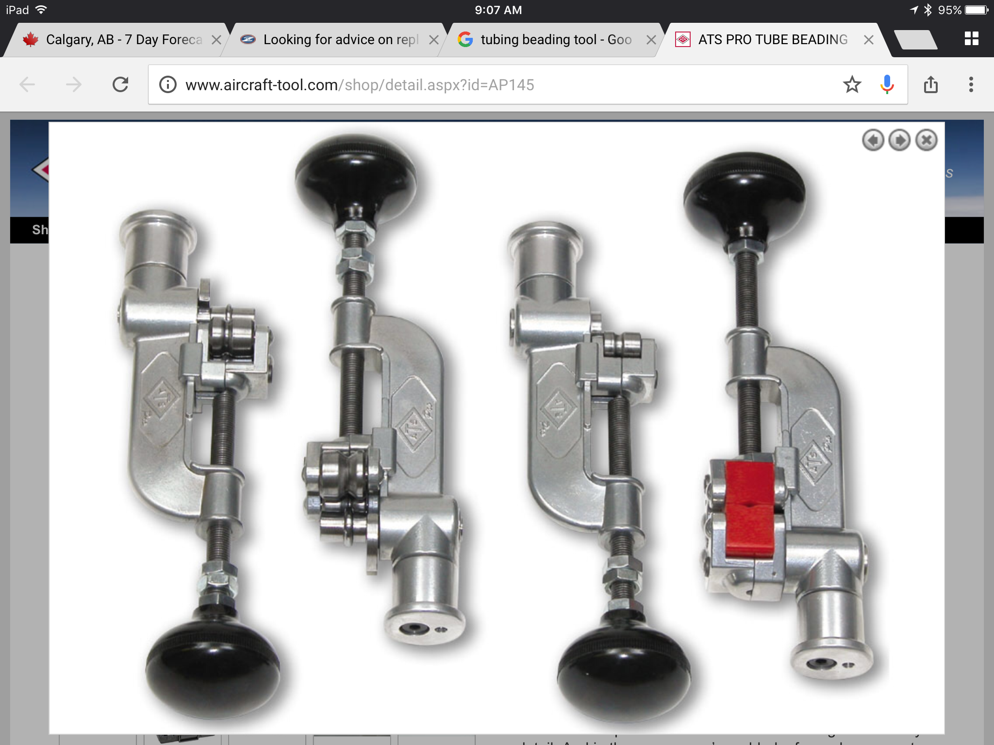

The tool to form that ridge is called a beading tool.
http://www.aircraft-tool.com/shop/detail.aspx?id=AP145
OF course there are a hundred DIY tools on Utube...

The ATS tool I linked to goes down to 1/4" tubing. I guess that leaves out 3/16, but I would think that would be small enough for our uses.
I bought the graham small tool for 1/4 and 5/16. Works just great. Sorry Wheee! You're not borrowing from my crib!
http://www.grahamtool.com/smalltubebeadingtool.aspx
