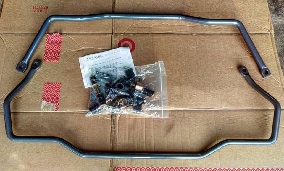

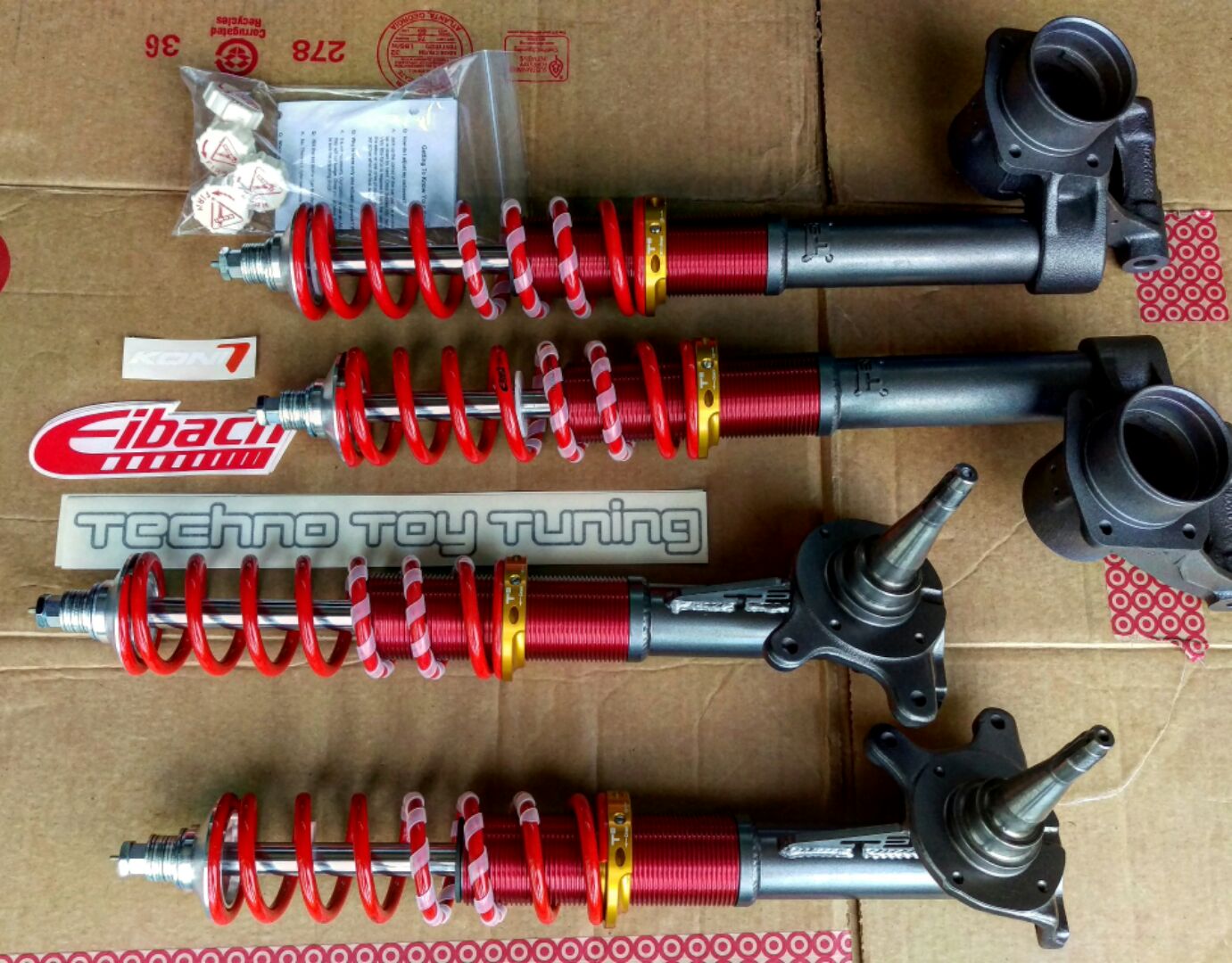

My T3 coil overs arrived today. I got the MSA sway bar kit a few weeks ago. The wheels will still take 2 or 3 months to arrive.

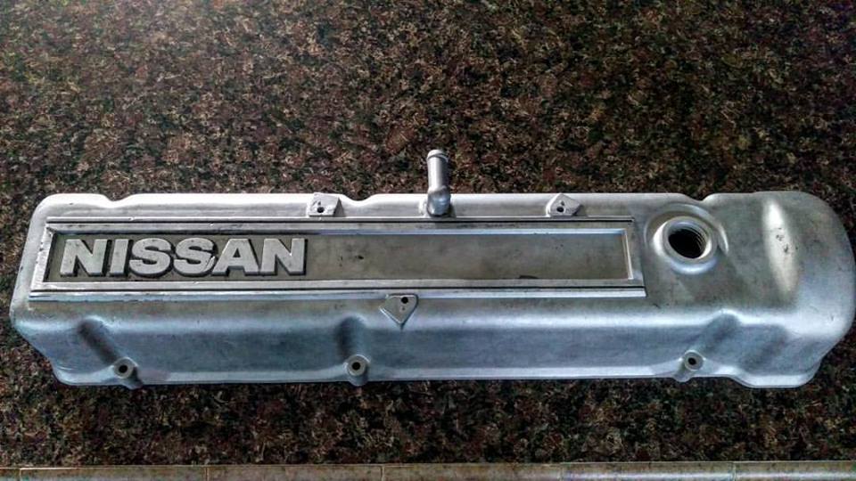

I really like the Japanese / Euro cover (big and small logo) they look awesome. I'd like to have another one for another project. I'm grateful to have found his one. I'm going to do it in wrinkle black finish.

I made my decision and also just ordered Techno Toy coilovers, Fujitsubo Legalis stainless exhaust, Cusco strut tower braces and got my Watanabe R's ordered.

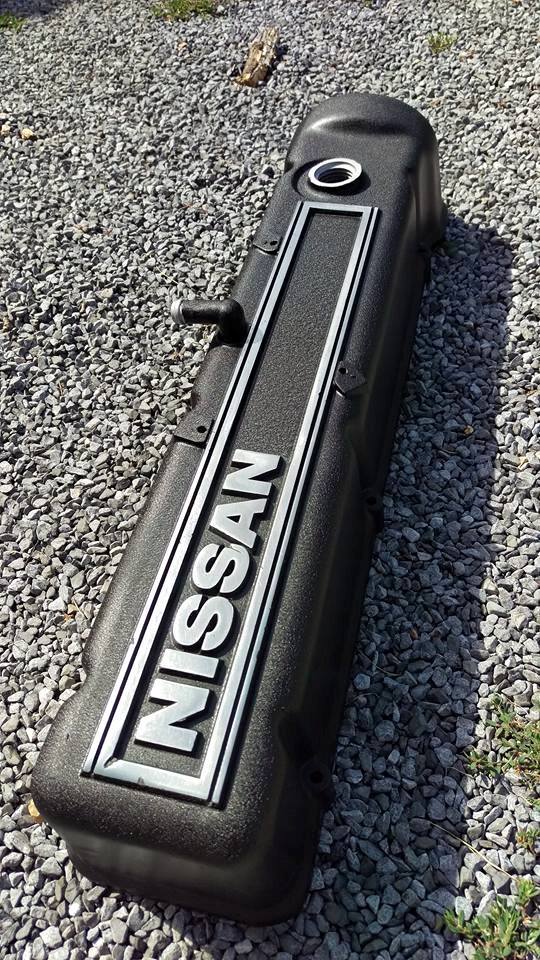

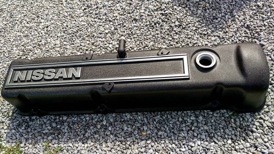

I got the cam cover finished up today. Sanded the nicks and rough sand marks out of the logo first. Some nicks were too deep to fix. Gives it character. Then got it painted with VHT wrinkle black and then cleaned off the logo and border. shined them back up and sealed the bare metal with Shark Hide. I'm happy with it and think it'll look great on my car. Would like to have another one.
