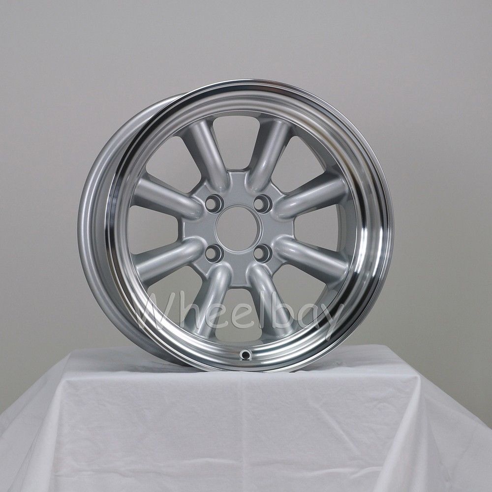

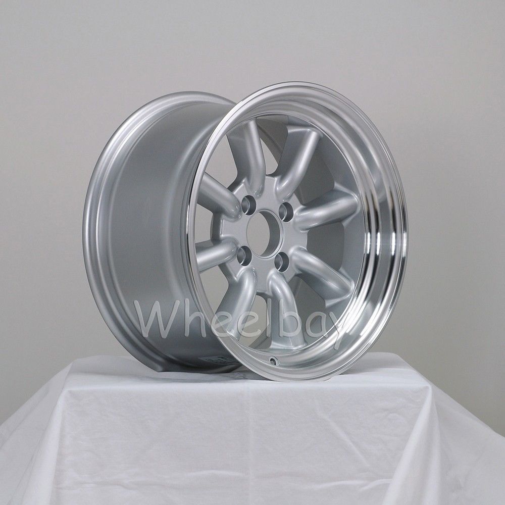

It's getting close to Christmas and I've been doing some wheel shopping, but can't seem to come to a decision.  So far I'm trying to decide between the following:
Rota RKR: I think I like the shape/style of this one best.  They're only available in 15x8, though, and I'm not sure that'll fit without rubbing.  I still have the slightly-tired stock motor, and probably will for a while, so 8" is a lot of wheel.  If the RKR were available in 15x7 or 16x7, it'd probably be a no-brainer pick.

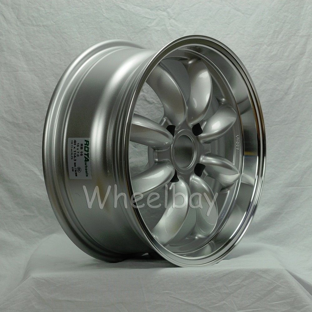

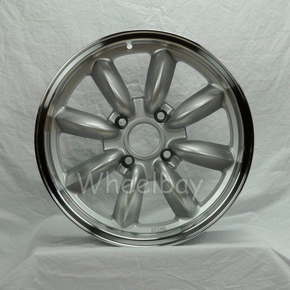

Rota RB: comes in 16x7, which is probably the best choice as far as fitment and tire availability is concerned.  (As far as looks, I've flip-flopped about 100 times on 15" vs 16"; I could go either way.)  The RB looks good straight on, but I'm not a big fan of the spoke profile.  I don't really like how it curves out from the hub and back into the rim.
Other options: Konig Rewinds don't get me super excited (opposite problem from the RB -- the spokes are a little too straight and plain, though I like the shape of the 15x7 better than 16x7). The XXR 537 only comes 8" wide and the Enkei Compe has a fluted edge that I don't like.

I will nudge you in the direction of the RB's.  I run 16x7 RB's in the warm weather and have no issues on my 77, lowered same as you.  Tire selection is far better with the 16" size vs 15".    You can run 8" width on the rear but the front will be a problem with rubbing.
The RBR has the flatter spoke style that you like, but I think they only make them in 17" now.   Too big for these cars imo.
The Panasports are a great-looking wheel, but I just can't bring myself to pay for them.  I've been through the wheels and tires thread a number of times but didn't see the gallery, so I'll definitely check that out.  I didn't know about the VTO wheels, which also look like a good -- if slightly more expensive -- option.  The 16x7 RB is where I keep leaning (for now, at least): easier to come around on looks than on something that doesn't fit.
