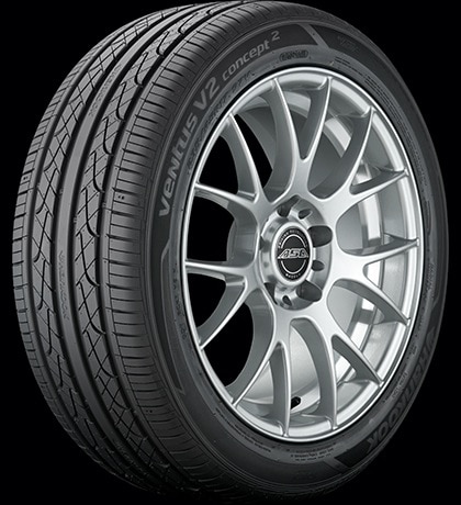

For what it's worth I run these Hankooks on my orange Z, 205/50-R15 and love them for their look and price too.  discounttire.com has them for $260 with $90 worth of rebates right now, $170.  http://www.discounttiredirect.com/direct/findTireDetail.do?ra=searchTiresBySize.do&fl=&pc=19441&counter=0&ar=50&rd=15&cs=205
Hankook Ventus V2 concept2

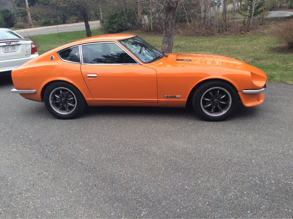

I will nudge you in the direction of the RB's.  I run 16x7 RB's in the warm weather and have no issues on my 77, lowered same as you.  Tire selection is far better with the 16" size vs 15".    You can run 8" width on the rear but the front will be a problem with rubbing.
The RBR has the flatter spoke style that you like, but I think they only make them in 17" now.   Too big for these cars imo.
What size tires are you running?
