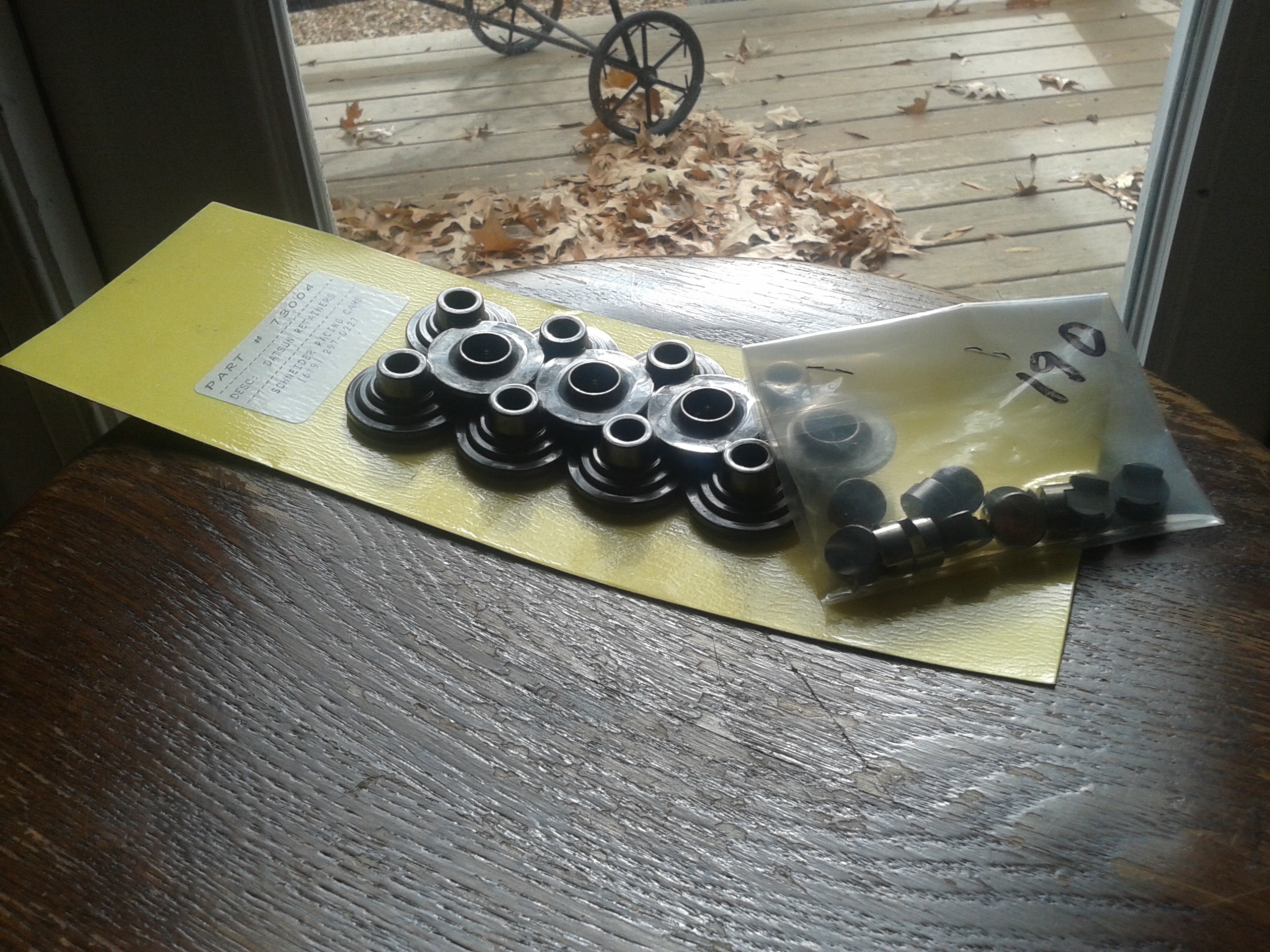

21 hours ago, sweatybetty said:
i was told that i need new retainers with those springs. did you need new keepers as well? or will the factory ones work?
thanks

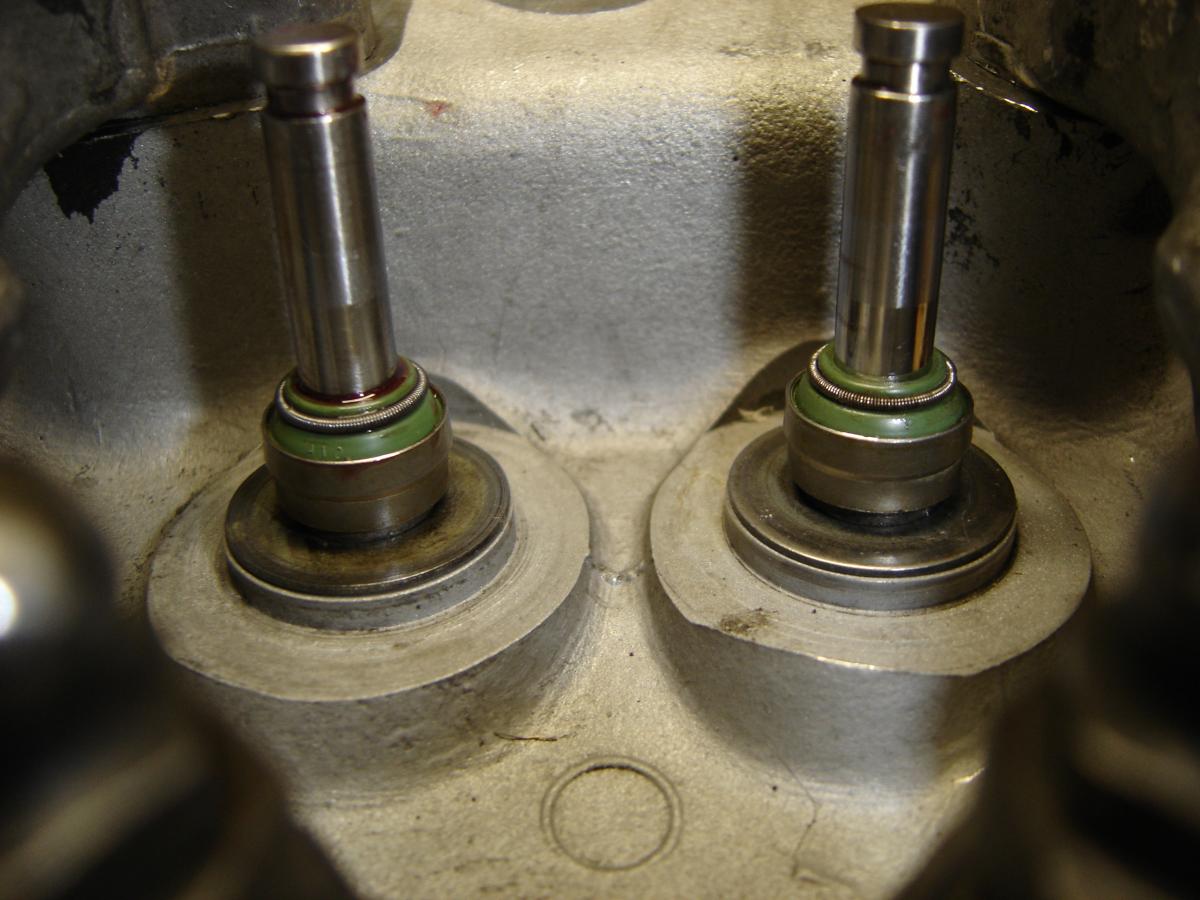

I'm gonna say stock valves, stock keepers will work.  When I bought my cam, I got everything needed according to Schneider and I did get a taller set of retainers but no new keepers or new valve seals.  Here's what I'm using and why, http://forums.hybridz.org/topic/25807-improved-l6-valve-stem-seals/    and installation precaution here,  http://forums.hybridz.org/topic/68120-problem-with-viton-valve-seals/

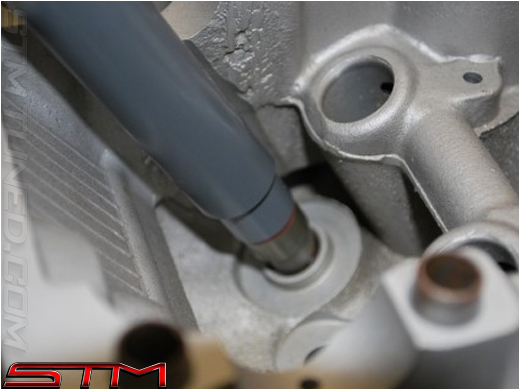

They're only $15 from Advance Auto.  I put a set on an E88 head I'm running now just to get some practice on installing, I measured 47 times and cut once.  The trick that I learned was not to use a deep socket but a 6" section of 1/2" PEX plastic pipe after seeing a "valve seal installation tool".  This one is made of PVC,

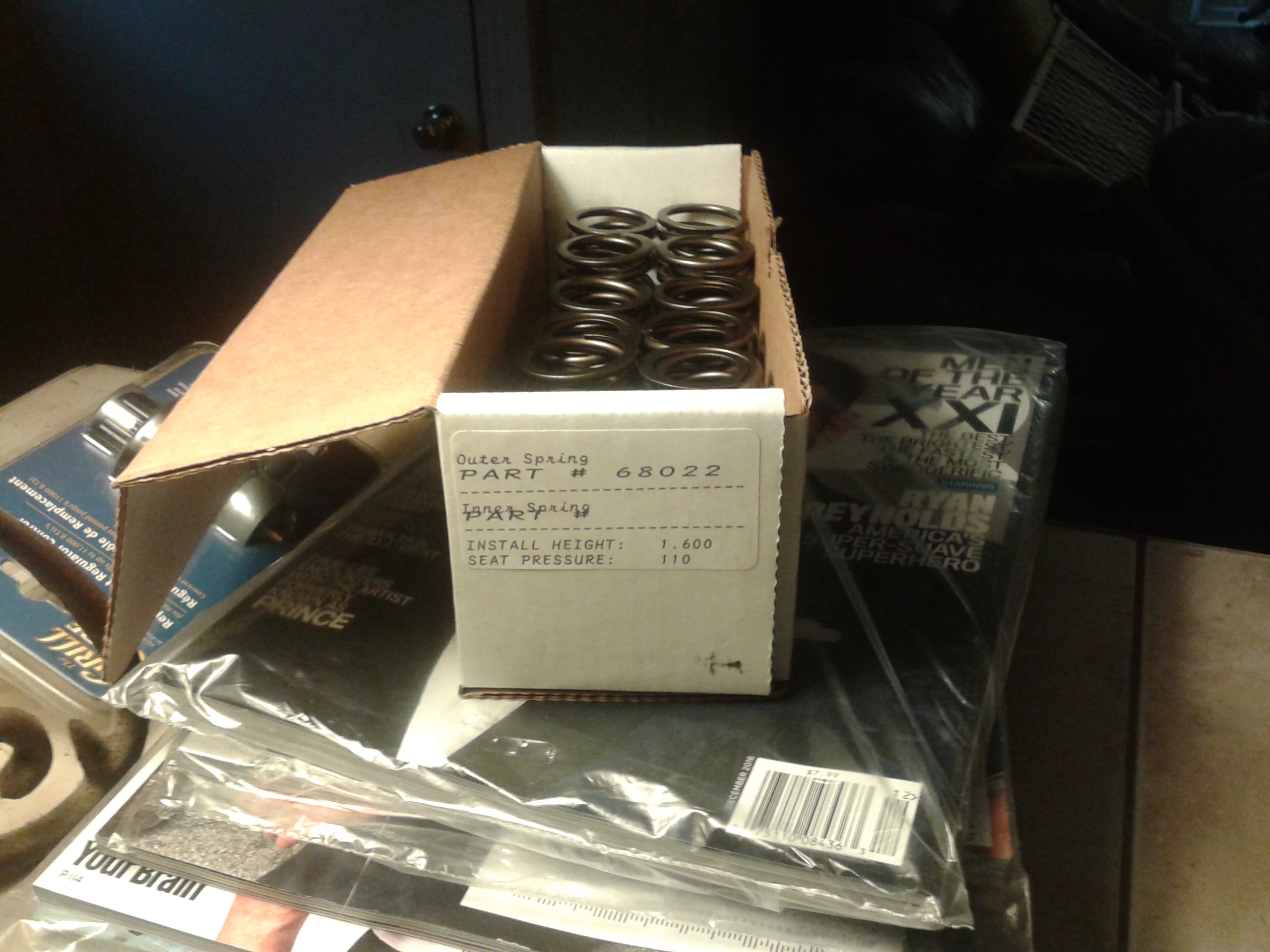

On 12/9/2016 at 4:28 PM, siteunseen said:
Try Schneider cams. They sent p/n 68022 with my cam, 460 lift. I'm almost positive they have the taller ones for our L motors.
I see on their site for .495 and over he lists p/n 68025 spring set. I would use his matching retainers too.
