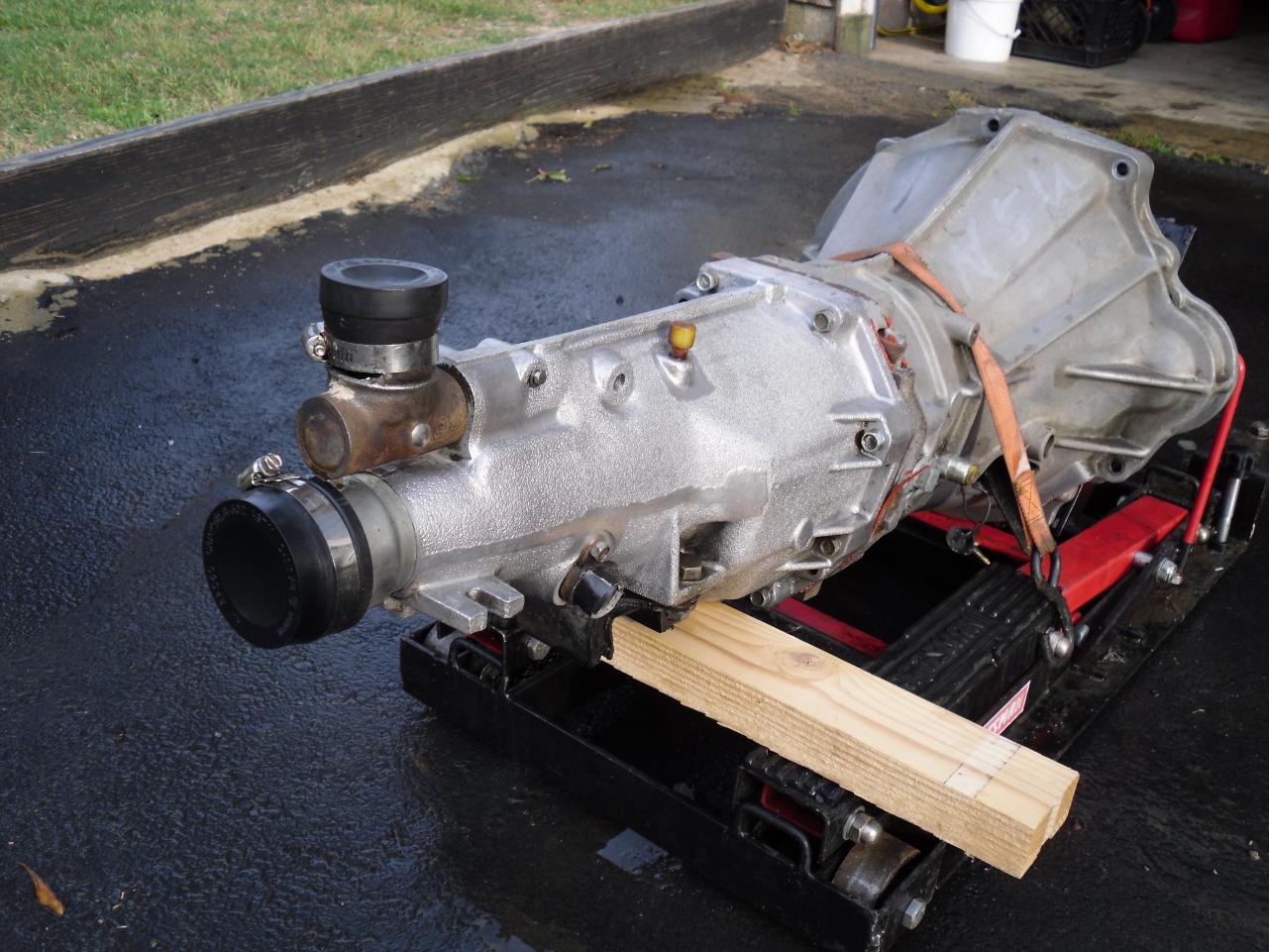

Good way to keep your trans oil inside for a couple of bucks is use a rubber cap from a hardware store.  Worked good for me when removing and pressure washing.

what size cap did you use? it would be nice to know, so whomever it is doing this next will have that cap ready to go during removal.

2 inch is what I have, it's a good tight fit.  two and a quarter inch would be perfect and would go all the way down and sit flat over the opening.
That one over the shift coupler is an inch and a half I believe.
