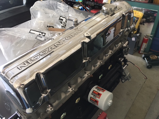

conedodger Posted March 9, 2017 Author Share #56 Posted March 9, 2017 So I got no love on the answers to my questions in the post from the first so I went ahead with some things on my own. The engine is on the stand. I have started to bolt things on to plug the holes. Link to comment https://www.classiczcars.com/topic/56686-just-another-damned-project-thread/?page=5#findComment-514878 Share on other sites More sharing options...

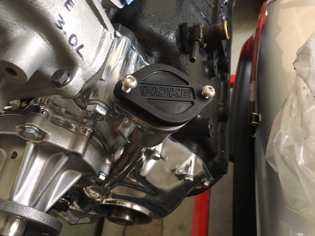

conedodger Posted March 9, 2017 Author Share #58 Posted March 9, 2017 The Hoke distributor block off. Not yet tightened down as I need to get the gasket. Link to comment https://www.classiczcars.com/topic/56686-just-another-damned-project-thread/?page=5#findComment-514880 Share on other sites More sharing options...
conedodger Posted March 9, 2017 Author Share #59 Posted March 9, 2017 A little peek at the head. This is an E31 which was modified by B.C. Gerolomy back in the 1980's. It has the 280Z valves with a comp 3 angle valve grind. It's ported and polished. Dave Rebello only had to clean it up and do a bit of his own magic to make it ready for action. Since it's going to be EFI, he had to notch the intake ports for injectors. Having already modified my head saved me a ton, but you should know, this head is worth a bit more than some of the 914's I see! Link to comment https://www.classiczcars.com/topic/56686-just-another-damned-project-thread/?page=5#findComment-514881 Share on other sites More sharing options...
