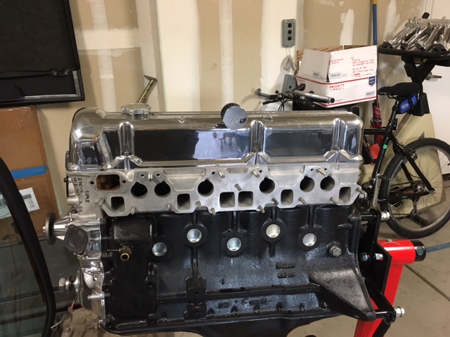

conedodger Posted May 6, 2017 Author Share #73 Posted May 6, 2017 Got most of the holes plugged. Getting it dressed up for install. Link to comment https://www.classiczcars.com/topic/56686-just-another-damned-project-thread/?page=7#findComment-520098 Share on other sites More sharing options...
