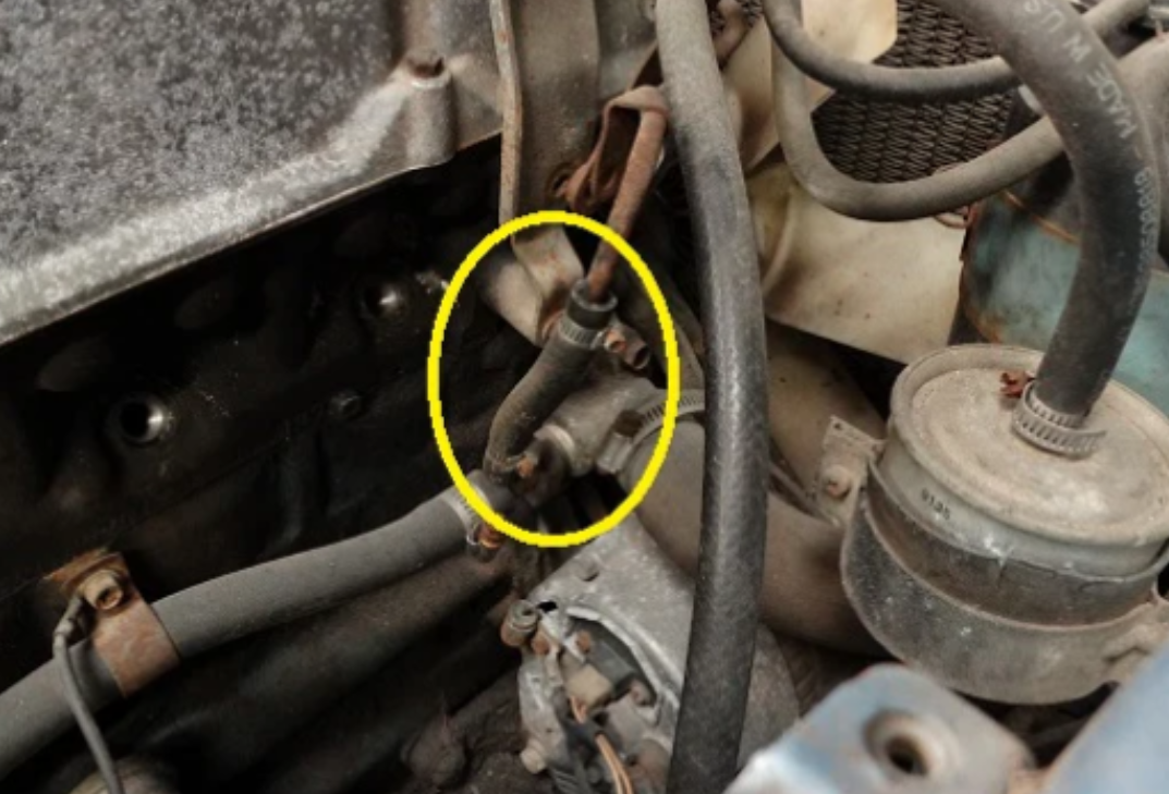

Can't seem to find any concise pics of the overall layout on the 280Z - mine has a loop hose that connects the t/stat housing to the water inlet housing. No pic of it in the 75 FSM.
Unclear as to the point of that, unless it serves as the bypass to circulate the head & block when T/stat is closed. Seems like an unwieldy design though.
Any ideas?
Any ideas?
There is no coolant bypass. When the watercock valve is closed, it is deadheaded.
So, what is the point of the loop? You are familiar with what I'm talking about? I assume all 280Z have it. Not talking about the heater circuit.
Edited by HusseinHolland
The thermostat has a weep hole for some coolant to pass before the t-stat opens.

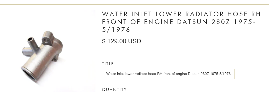

Here's the 280Z t-stat housing. This drawing shows the EFI sensors and switch.
I think I found what you are referring to.
Here are most of the part numbers in that drawing:
No, I didn't see any mention of this in the 75, 76, or 78 FSM.
Any ideas?
I think that might be the purpose.  Not clear how many 280Z's or 260Z's or 240Z's had it or why nissan stopped using it.  I've seen it discussed before thoguh.
ZCD sells them and some people put a T in the return hose from the heater core.  https://zcardepot.com/products/coolant-hose-engine-bay-t-fitting-280z-280zx
