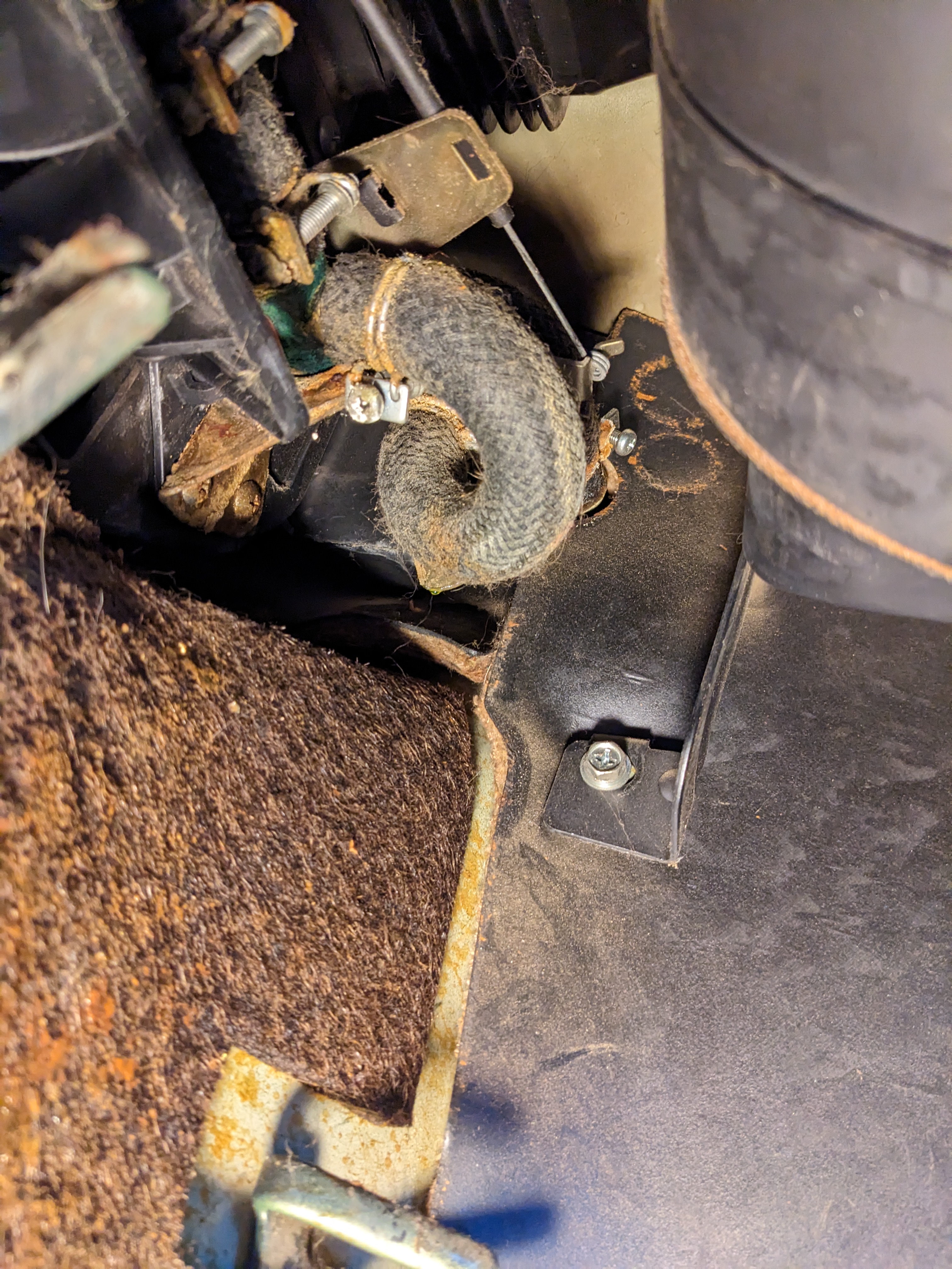

My 75 280Z has AC, but looking up under the dash, I don't see the bulkhead valve, only a heater valve. All the lAC lines look 'universal" with the hose clamp fittings, not crimped lines, so mine is perhaps a dealer installed version? Maybe that's why he said the AC never really worked, because there is no positive heat shut off?
This leads to another question - if the dealer kit differs from factory, would that mean the control head also has no vacuum switching? If I add the positive shut off valve, I will need a switched vacuum source to activate it...

Can you snap a couple pics of what you have. Should be pretty easy to tell if it's factory or aftermarket.
I'll do that. I tried to take a pic yesterday, but I didn't have sufficient lighting.
Had time to get a pic up under the dash - looks to me like the stock non-AC setup?
