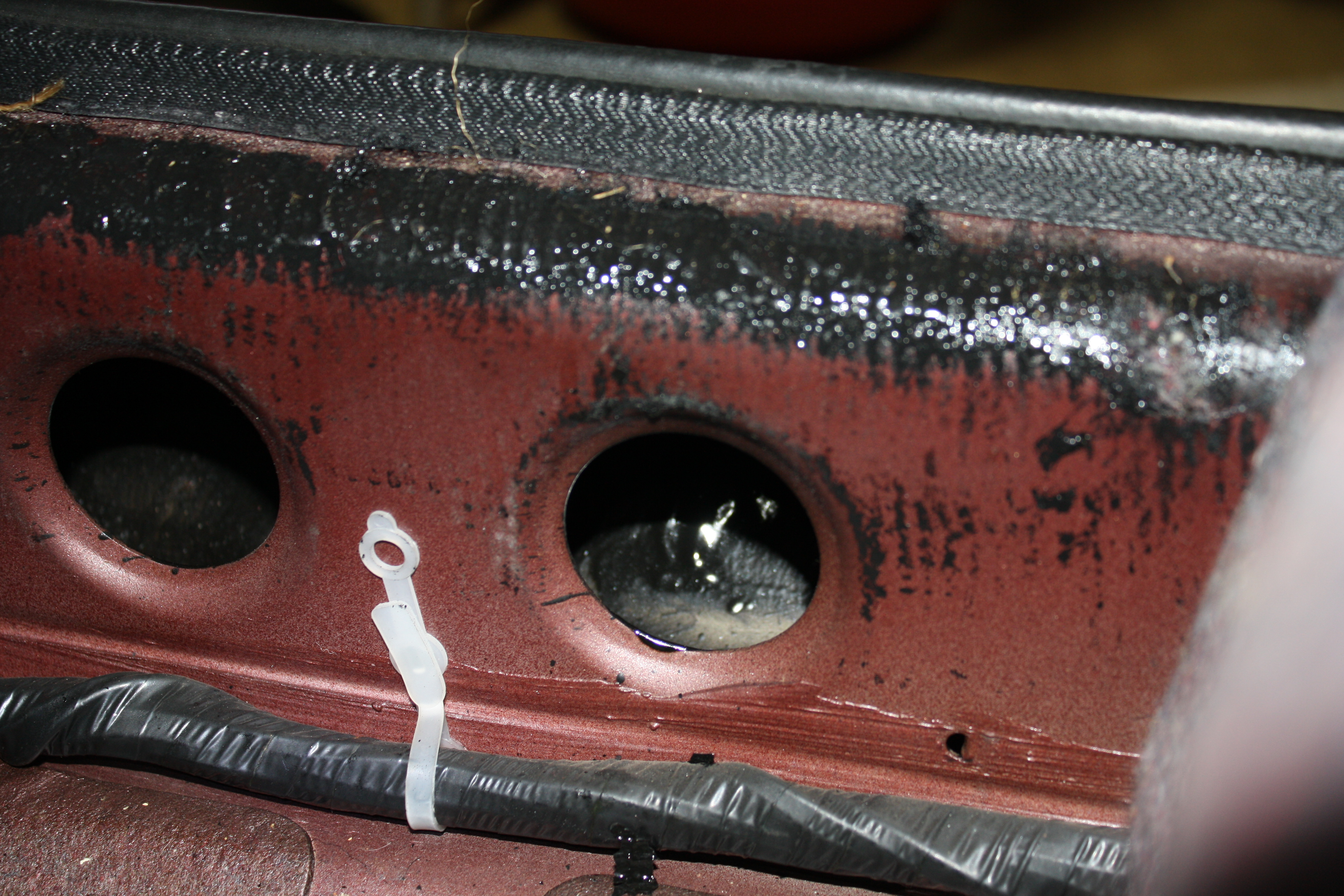

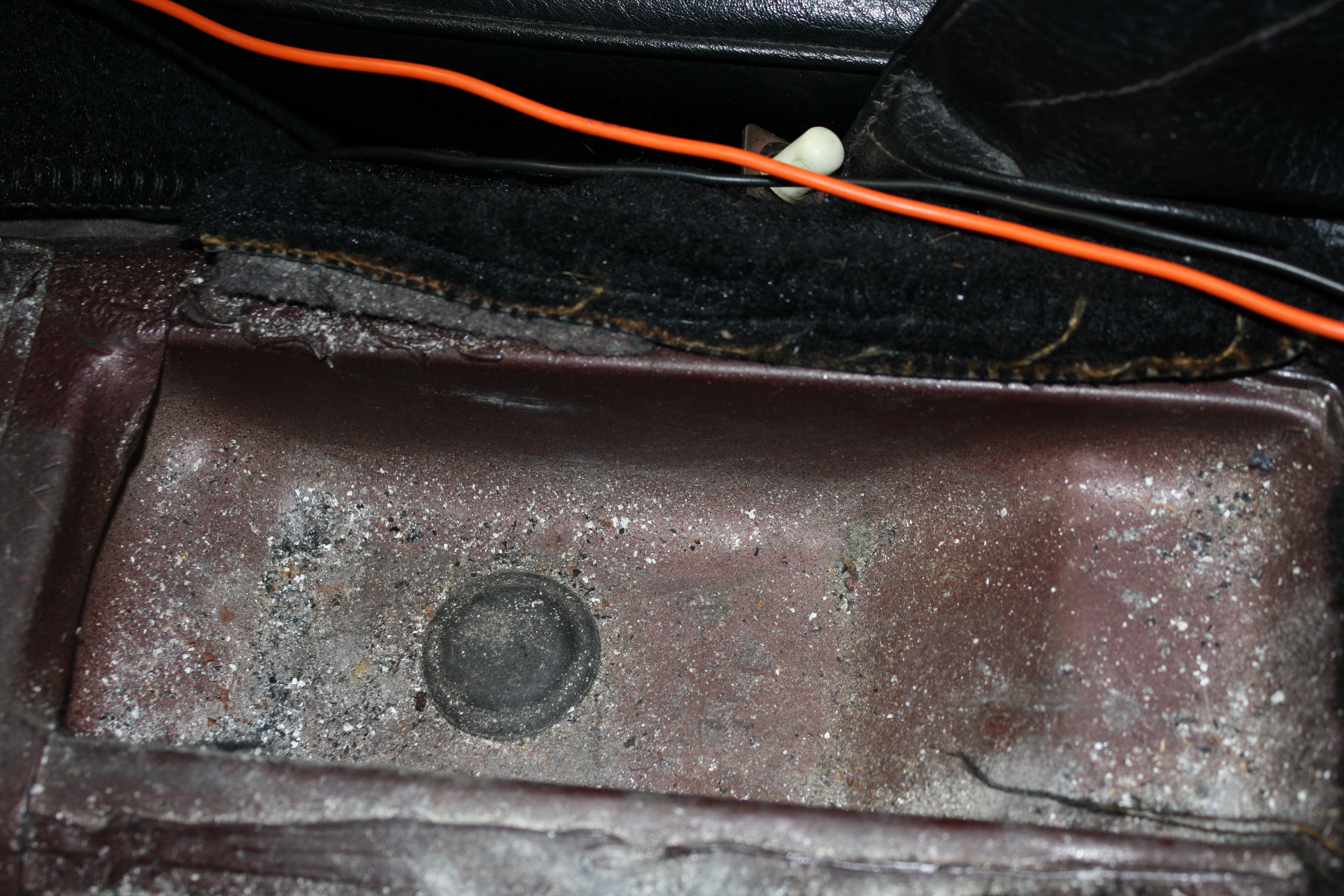

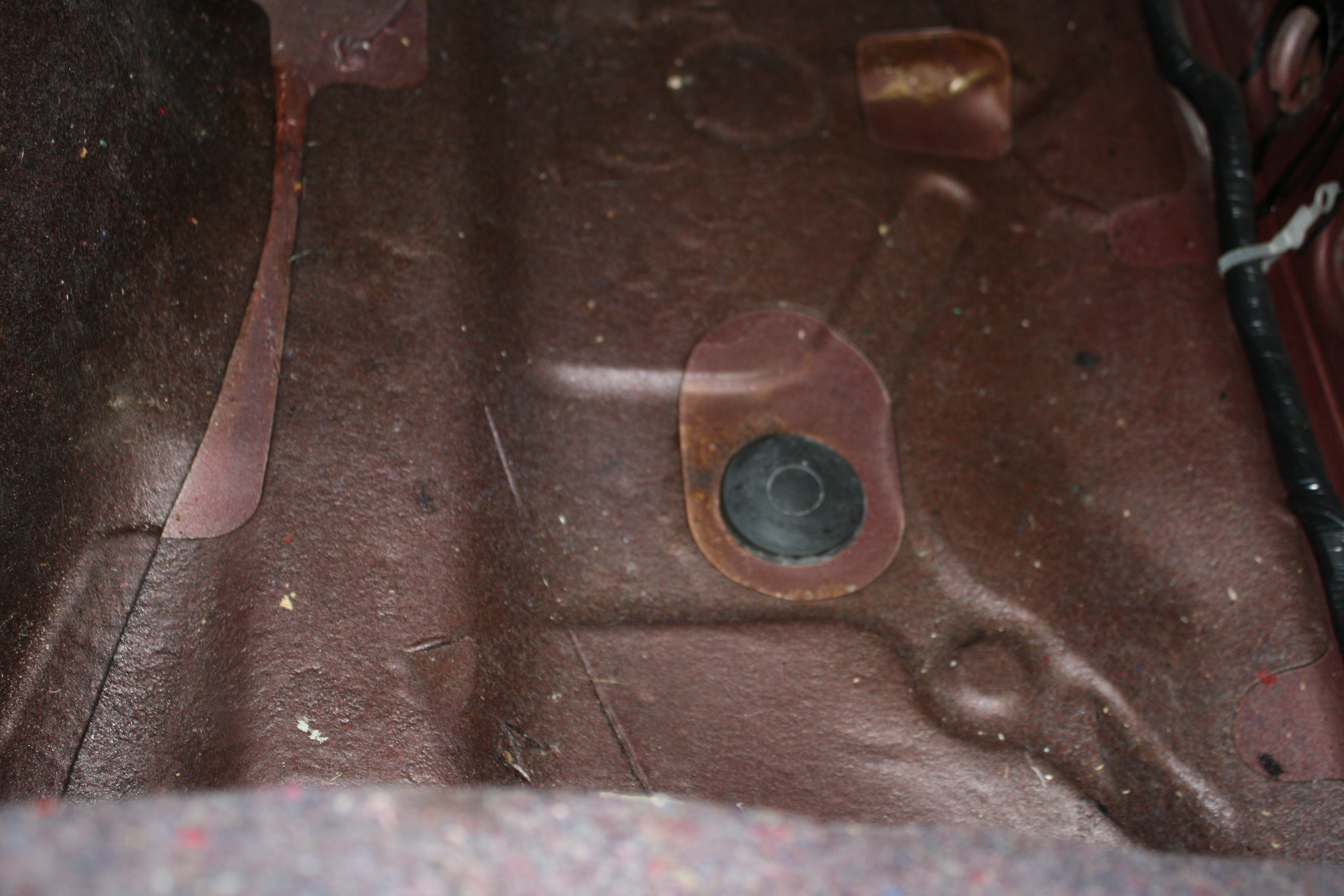

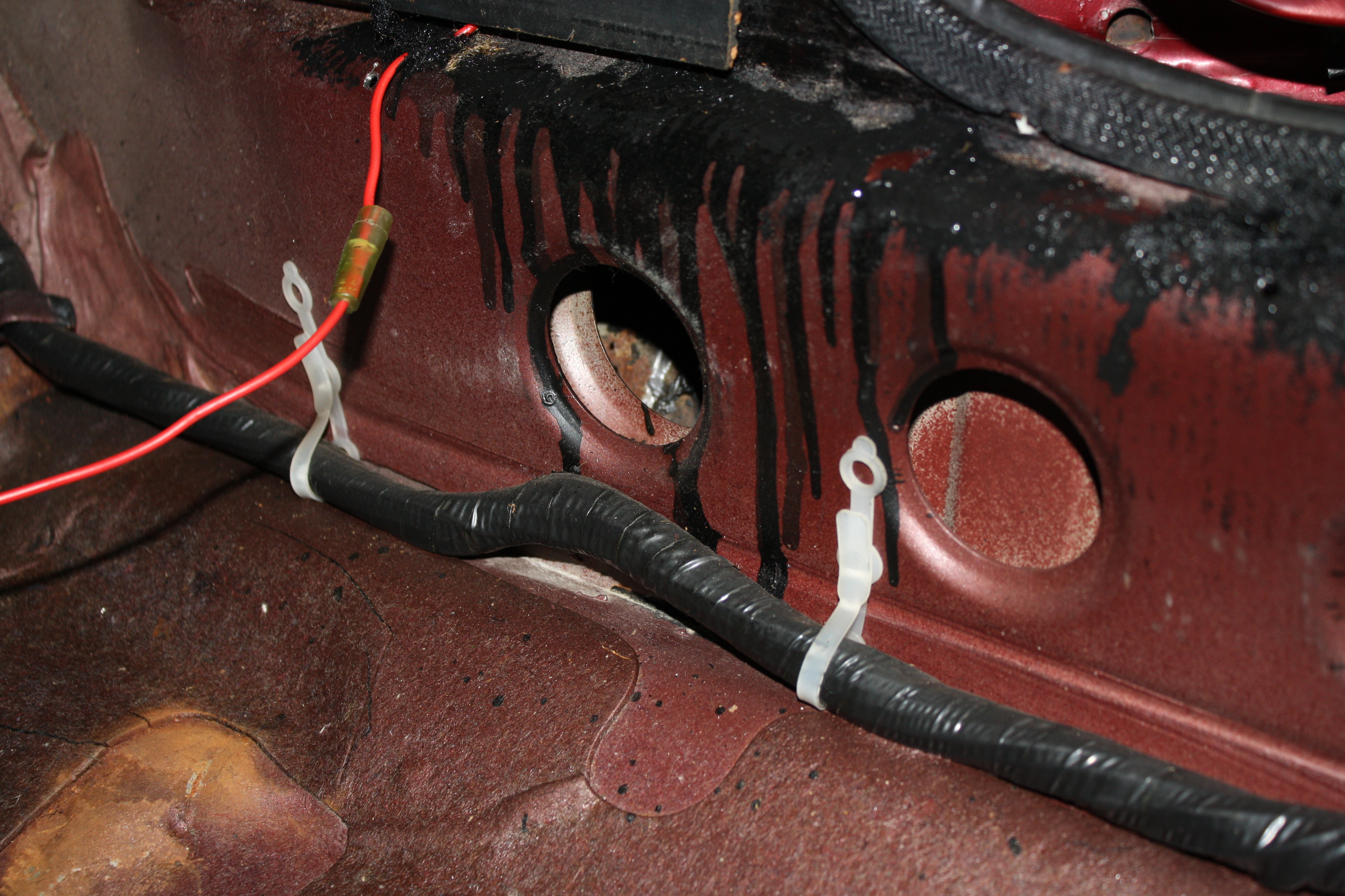

I took a few pictures this evening after taking the console out to repair shift linkage.  The PO had said that the car was coated by Ziebart in 1980 (there was a sheet in the glovebox presumably from the second owner stating it was done then).  He showed me the little holes drilled into the door jambs with little plugs but I was skeptical.  I no longer am after the photos.  The coating is visible through the holes in the inner rockers and I suppose this could be the reason the car is rust free in the critical areas. I like the look of the floor pans, that's for sure.
Are these rubber plugs easy to get back in if I take them out?  You'll see slight surface rust around it that I want to investigate.
The cigarette ashes under the console were no extra charge.
If you take the ones in the floorboards out you'll see the ground on a 240, I've not taken the ones out of my 280.  You can pop them out from the underside and putting them back is easy, if they're not too dry and brittle.
23 hours ago, charliekwin said:
Like siteunseen said, the plugs pop right out.  If the rubber's broken down with age, you can replace them with 1 7/8" plugs for old Fords; they cost about $2 or $3 each.
Thank you for that info. :)
I have a piece of Gorilla tape over the passenger's side in my 240, luckily the carpet hides it but I'd like another plug and haven't been able to find one yet.
Any ideas for the two on the hatch bottom?  Thanks!
