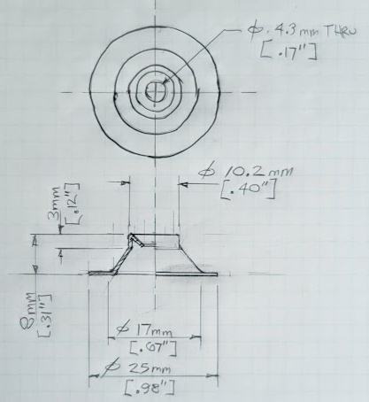

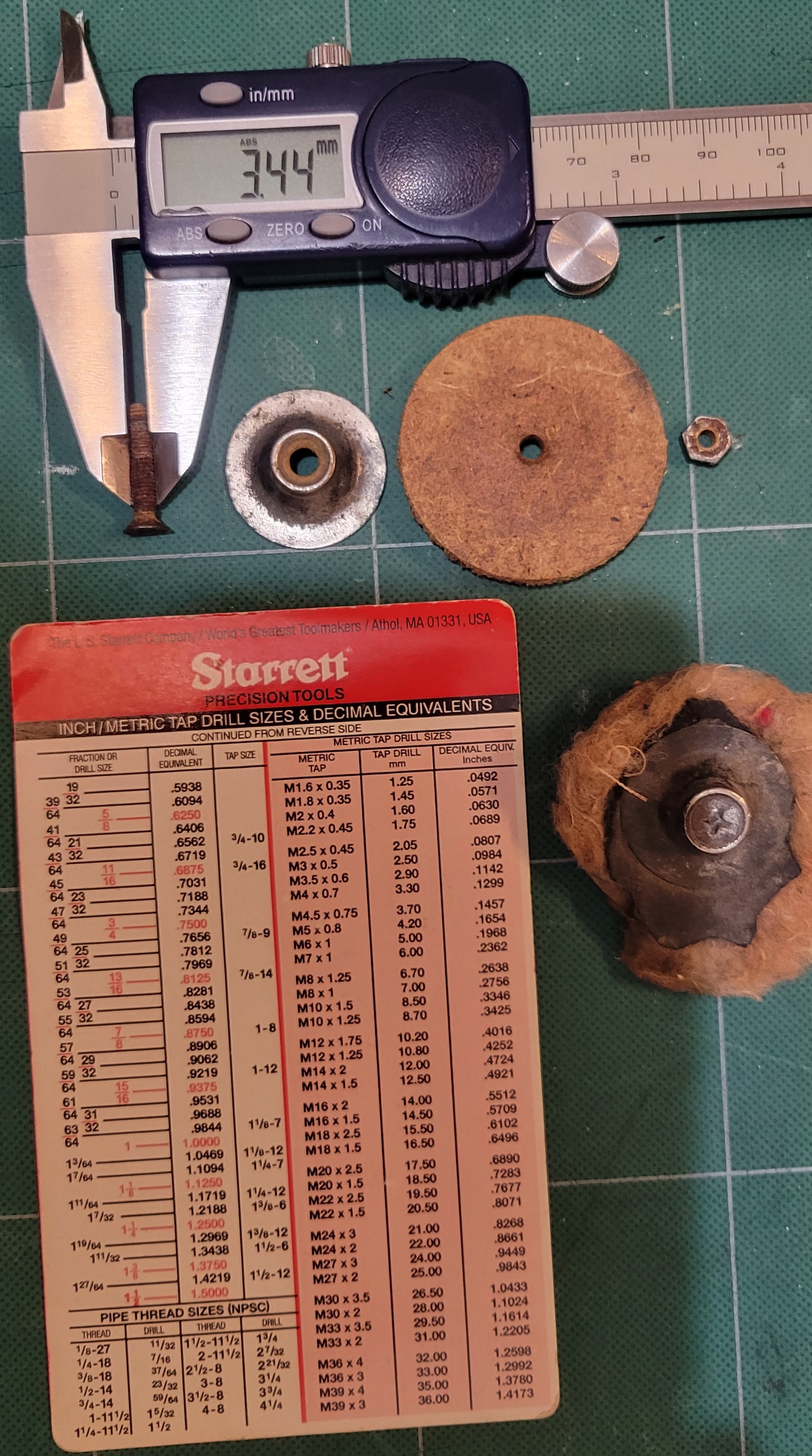

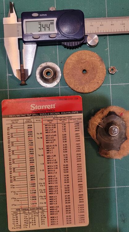

Here is a pic of a couple I saved from a 12/70 parts car. The measurements agree with those posted by @AZ-240z back in 2016, post #6. I was able to determine the flat head screw is a M3.5 x 0.6mm pitch x 20mm long.

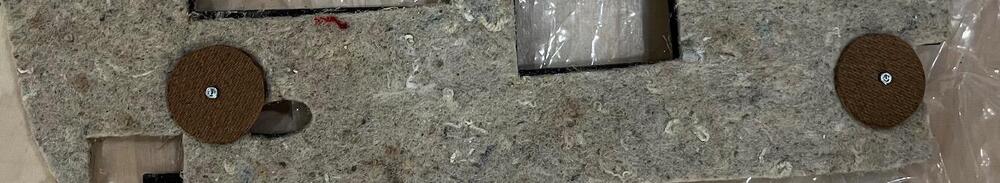

Just wanted to thank everyone who contributed to this thread. I finished up my firewall snaps and carpet snaps, and am satisfied with the results. Not perfect, but those snaps weren't on my firewall when I got the car, and they seem to be unobtanium. I guess I could make a 3D printed model, and maybe get some online place to print it in metal. might work.
