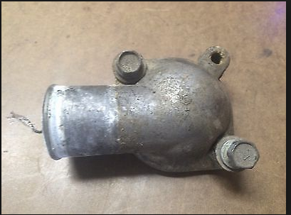

now i am seeing coolant coming out from one of the bolts!!  Should i just buy a new set of stainless Steel bolts size 12, remove the old gasket, clean both surfaces (thermostat housing and cover)  and install new bolts with this new gasket?? I really dont want to use any High Temp silicone,

Your bolts might be too long.  Run them in to their holes with the cover off and see how deep they go.
It's a little bit weird that you removed the cover without removing the hose first.  Remove the hose before you put it back together, and be extra careful when you reassemble everything.  Check the mating surfaces, install the thermostat in the housing making sure it's flat and seated in its groove, place the gasket carefully, then carefully set the cover on and insert the bolts. Tighten the bolts firmly, use a torque wrench if you have one.  Then put the hose on.

took one of the bolts out! I think they are 12mm. Cleaned it with wd40 but still has lot of rust! Should i replace them with Stainless Steel of the same size.
no on replace. You should make sure they are not bottoming out and noted above.
Edited by Dave WM
The only thing that matters at this point, right now, is how much of the bolts stick out from the bottom of the cover when you stick the bolts in to the holes.  Forget about all of that other stuff and focus on that.  Stick the bolts in the holes.  Measure or take a picture of the bolts sticking out of the bottom of the holes.
That image, or measurements, will establish the ground work for future suggestions on this problem.
The suggestion about the flat washer was intended for AFTER you determine if you have the correct bolts.
cleaned both surfaces, cleaned and removed rust from both bolts, installed them with the two washers and new gasket: No more leaks! No need to use high temp rtv. However i did noticed that during traffic jams temp gauge still raises to more than 1/2 so i ordered a 160°F thermostat from z car depot! Not original OEM but at least it is 160°F
