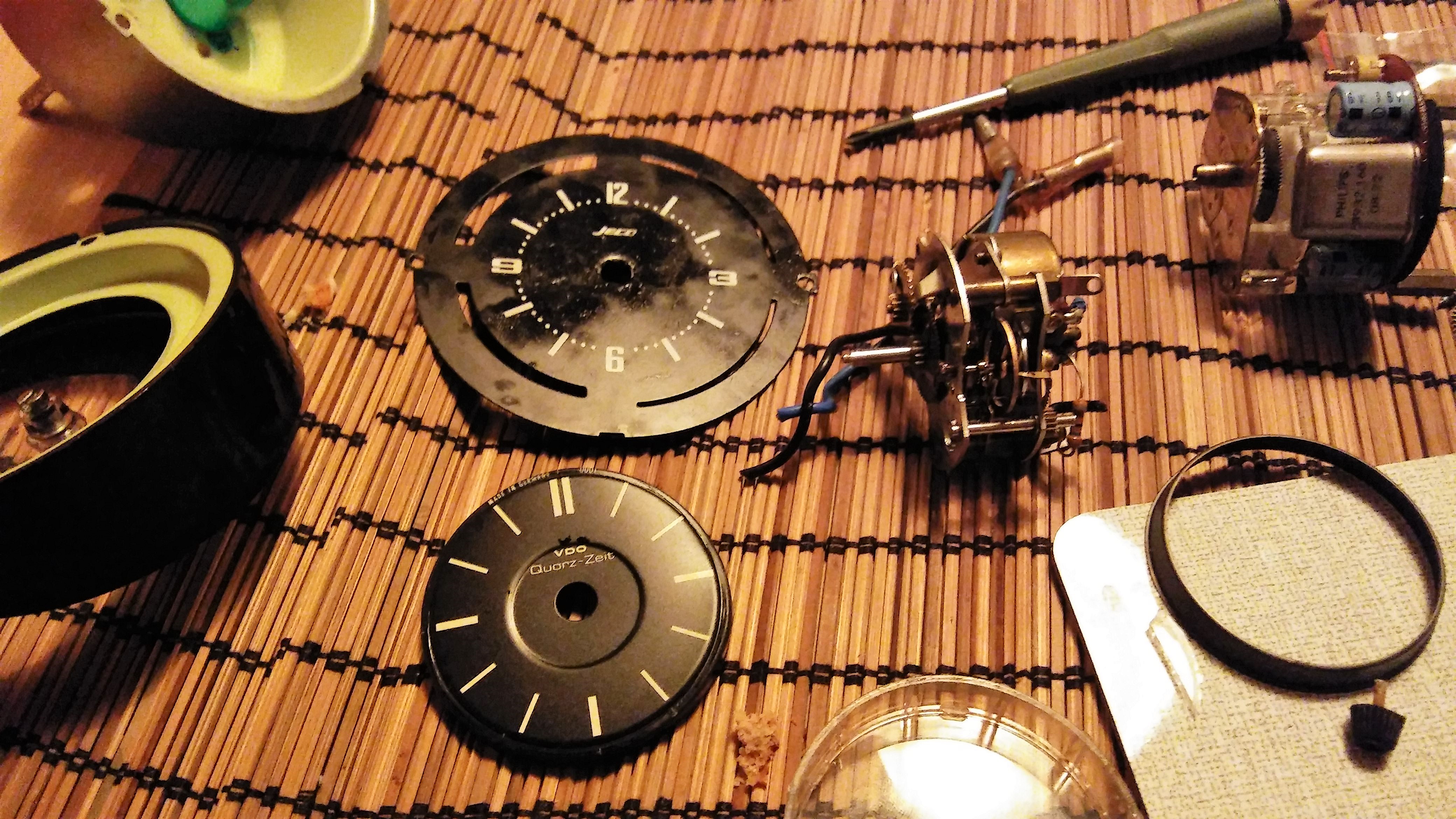

decided to tackle a clock I have has a spare, it was not working, uses a hybrid of electronic and mechanical. Replaced the two 10uf caps, left the .22 electro (I do not have one that value handy).
You have to be very very careful about the wire on the pad that is shared by one of the caps and the coil. Anyway the good news is it working fine, the caps were completely open (when testing with a Simpson 260 VOM). I made a video should be up soon will post when done.

Get yourself some small 10uf radials and the .22 if you are going in there. I kinda started to run out of room with the 35v ones I had on hand, 16v would have fit a lot better.

220nF polyester capacitors should be easy to find to replace the 0.22uF electrolytic. I would certainly do that while you have the clock apart.
And as far as the transistor goes, it might be ok, but I wouldn't trust it. It's a basic npn silicon transistor. I have fixed a few of these clocks now, and I have seen the transistor fail.

already back together, I like to do things is stages, so far so good, keeping time to the minute over several days. I would replace at least the cap if I was going to put it into service. for now its just a spare.

You got real lucky with just a cap that was bad. In my experience the tran goes bad all the time and the two coils do drift to the point that they are not usable. Nice wording on UBER careful when soldering around the coil wires, that can't be stressed enough. They are about 35 gauge and easily to overheat. I haven't seen a Simpson 260 for years and loved the one I had when I was in the service.
