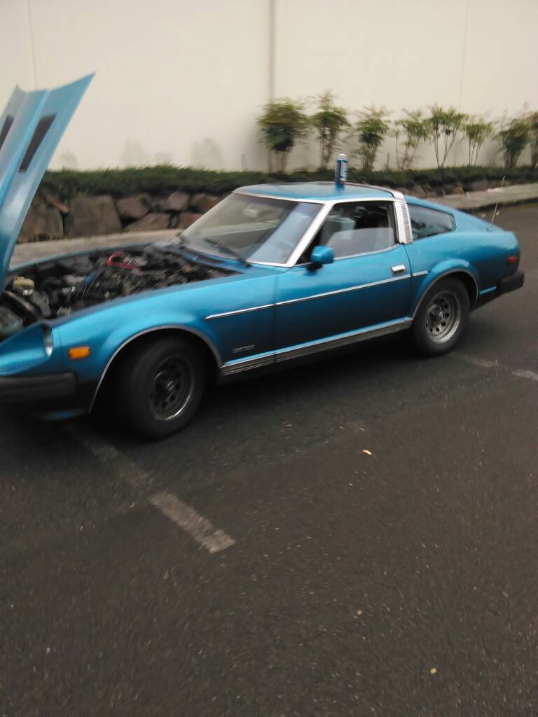

Greeting to all. I joyously join this site after having discovered an abandoned treasure in a middle aged lady's garage while installing some kitchen appliances at her home. A 1980 zx n/a. I asked her how much and she said 200$. I went to the bank right then. A tuneup and some seafoam and it sits at my house. About to tear into the intake/exhaust to do the gasket and replace vacumn and elec connectors, fuel injectors and such. IMG_20160923_175151.thumb.jpeg.4b2390592

Around here they go a few grand in basket case condition. So its lucky indeed. It has a strange misfire at 1500-2000 rpm. Not bad but noticeable. I know for sure the injector connectors are toast and it has an intake/exhaust leak around #1 and 2 cylinders. I'm going to deoxit d5 the ecu for safe measure along with a complete vacumn line and injector/connector replacement. Manifold gasket of course. The compression on #1 and 2 are 128psi, the rest sit at 165 ish. I put a known working AFM on it and I've adjusted the valves according to FSM. Hopefully all that will bring compression back up and make the hiccups go away. New CHTS but need connector replaced too.
