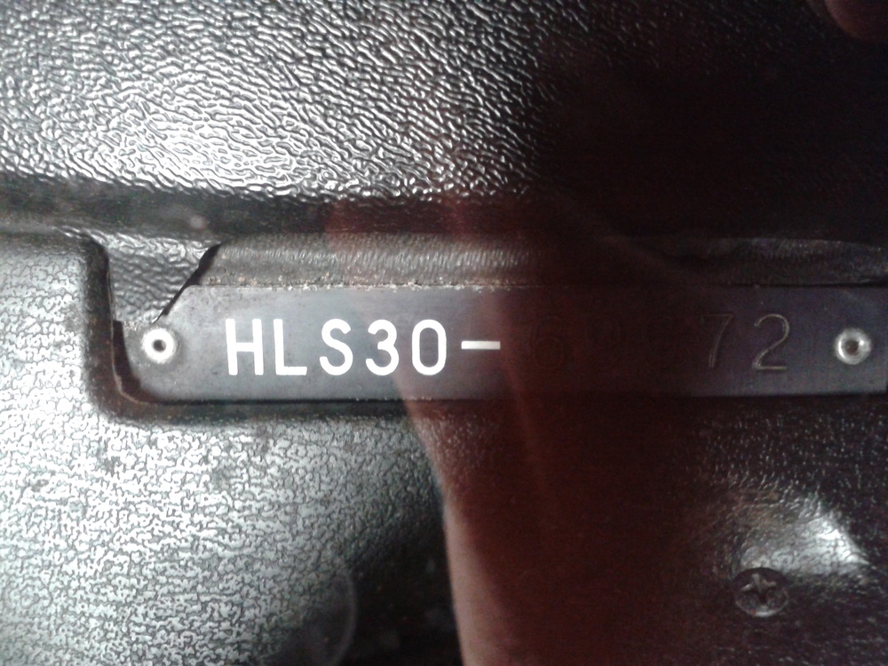

I may be difficult to replicate one of these tags to OE standards...
  • The plate itself is made from stamped-out piece of aluminum sheet
  • The black top coat has a satin-ish semi-gloss appearance, with a barely noticable top-to-bottom 'grain'
  • The 'HLS30' characters were produced by leaving the shiny top surface of the aluminum plate stock exposed.  The characters have no 'lip' around their edges (i.e. the entire top surface feels smooth), so the black overcoat must be just mil's thick.  Masking and painting won't replicate this.  I think the overall process used originally would have consisted of some kind of silkscreening.  Maybe somebody else with experience in a print or photography shop knows better.
  • The five (or six) digit VIN numerals were produced by the die punch cutting through the black top surface of the plate and penetrating into the underlying aluminum.  There doesn't appear to have been any paint used to highlight the 'trench'.  Once again, what you see is the exposed aluminum of the underlying plate stock.
  • You'll need to find a metric number punch set with the correct font style (?) and the correct size (seems to be 7mm x 4mm).
It sounds to me like Mike at Banzai has priced this out quite fairly at $450 (to do it right).  If that's too steep for your budget, maybe you could just use the VIN tag that Grannyknot has sent you.  Given the car's salvage-title history, it would seem to be mainly just for show (although your local constabulary may not share this view).  The VIN that's stamped into the firewall is the definitive identifier of the vehicle and it should be backed up by the number stamped into the plate in the engine bay.

I'm still in the process in developing this vin tag. The "HLS-30" is not exposed aluminium, it looks to be a silver paint similar to a silver sharpie. I purchased the aluminum plate, I have a similar punch set I'm just trying to duplicate the HLS-30. My buddy will powder coat the plate to a semi-gloss. I will then go to a decal shop and ask for an exact copy, place it over the aluminum plate use the punch set and clearcoat the whole plate to give it the smoothness.

@siteunseen I think the style of the tag has to do with the year of the car.  The tag hatepotholez has is from a low vin car which is what I need to replicate.  You can see the numbers on your tag are even a different style.  The 2 on your tag does not have the "tail" like on the tag hatepotholez has.  I really appreciate the pic though for comparison.
