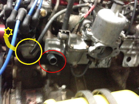

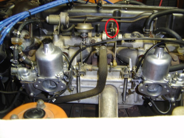

24 minutes ago, Chickenman said:
Can't see where the other end of your PCV hose connects to, but it should be connected to the Block breather tube as in the following picture. Is it?
Come to think of it I had a few vacuum leaks with the small hoses detached on the top picture. I forgot that I took a picture of this a while ago. I had unplugged the pcv valve hose on purpose on the top pic but the other hoses were just chilling.
The bottom pics shows everything plugged and that's when the backfiring started. Well the car still ran like crap with those leaks but didn't back fire haha

The only large hose I can think of on the balance tube is the brake booster hose towards the rear and then the PCV fitting and hose in the middle.

Looking at your picture I think the timing is off, retarded.
The vacuum advance dashpot should be close to 8 o'clock.  If you set the high idle screw like Lumens suggest, turn the distributor clockwise to advance it.

^^^^ siteunseen, I don't think that is actually his car, but a sample photo chickenman posted to show the block breather location for reference.  Good point though and a good check.
Ooops!  Sorry about that, thanks for correcting my mistake. :)
