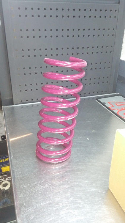

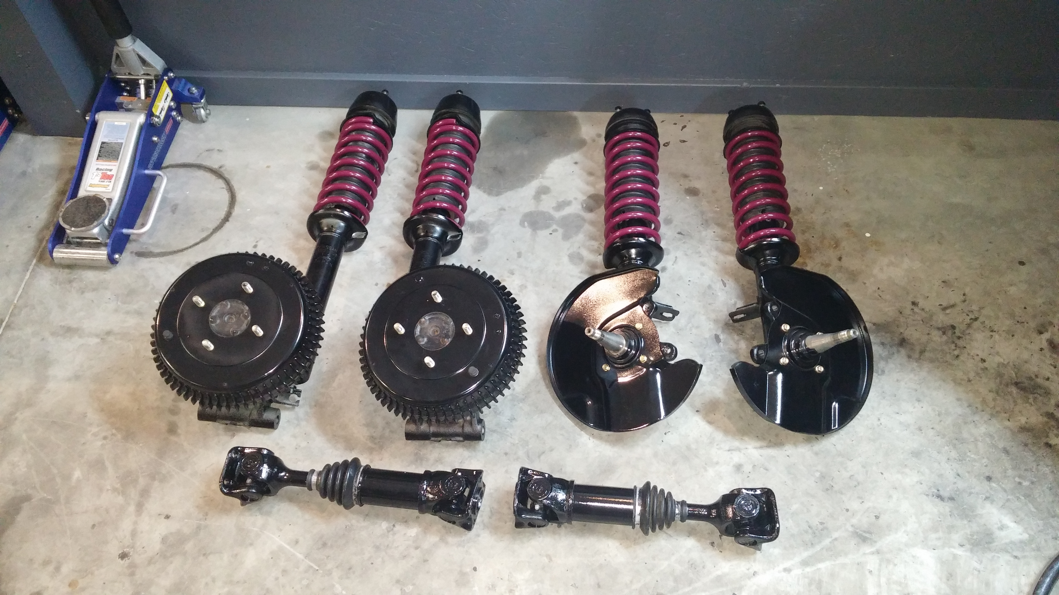

Today was a new a day at the shop, I finished painting the driveshaft, half shafts and belly pan, all looks good. I wanted to start opening boxes and checking out a few things. First box opened Vogtland Springs, on the internet they are ruby/blood red, these are a purpleish pink color, not happy. I was reading a thread last night by Captain Obvious about rack and pinion Prothane bushings not fitting good. So I went straight to the box with them in it only to find out they sent me the wrong ones, so pissed. The drivers side needs reworked as expected but the passenger side is to narrow and loose. lastly, I started fitting a few bushings to see how they are going to look only to find out I wasn't supposed to remove the sleeves out of the Mustache Bar.  I guess reassembly of the rear won't be happening tomorrow!

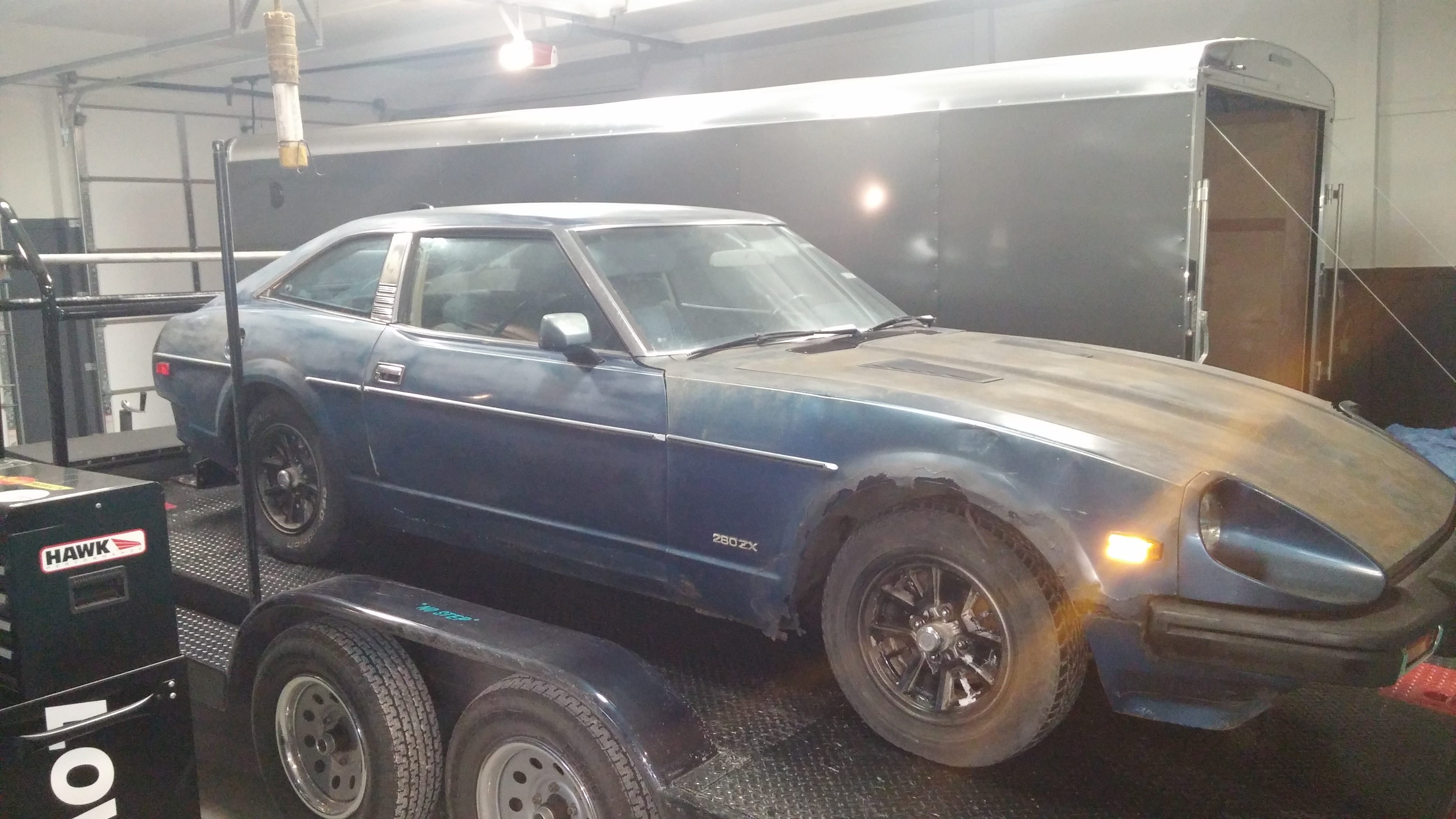

While the project has stalled due to my mistake, I was able to nab a 1979 zx for the 5spd trans. seems to go in all the gears easy. Car doesn't run, so fingers crossed. Craigslist comes through again!

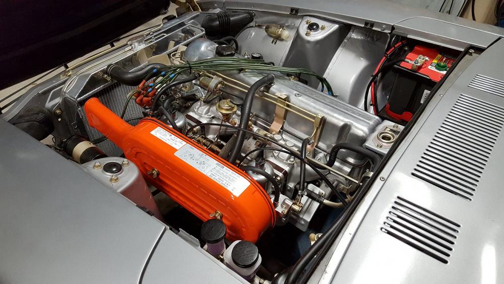

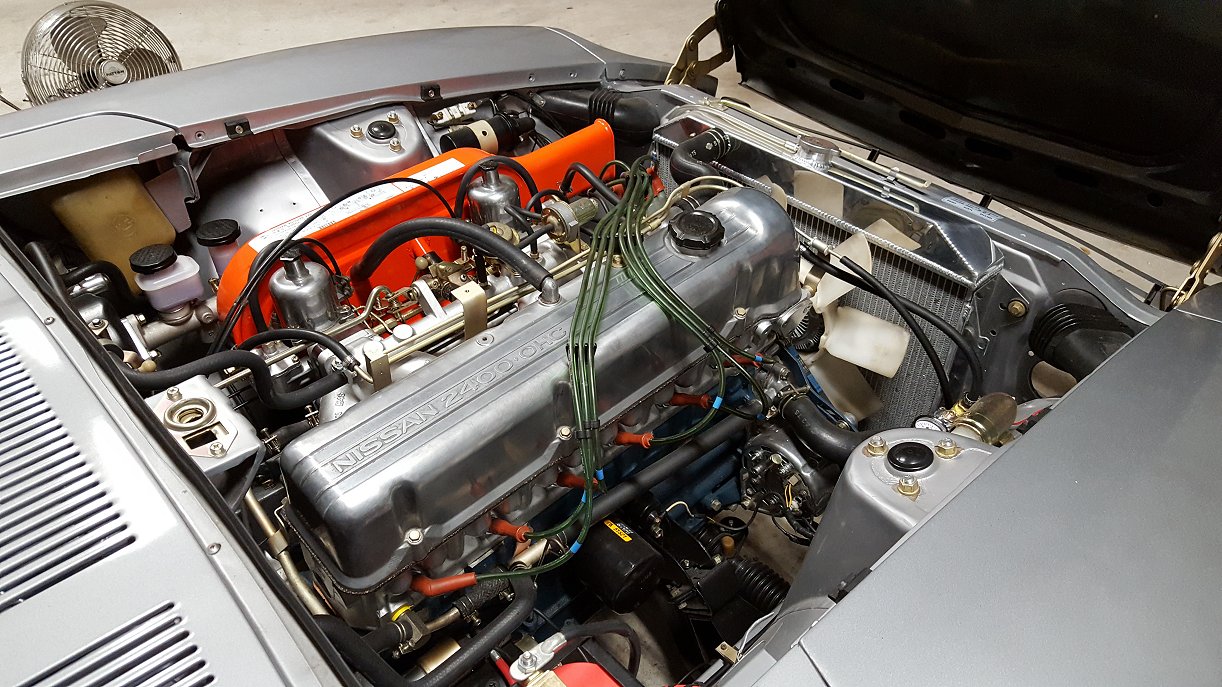

I think your question of how far to take the engine appearance is a personal preference.  I think a clean and well detailed engine is the way to go.  Too much bling = time spent polishing and cleaning all the time.  If your engine is stock then getting the details right go a long way.  Mine is stock and has received a fair amount of yellow zinc plating on parts along with the correct rubber bits and clamps.  The previous owner polished the front timing cover and alternator so I keep up with it as best I can.  The aluminum radiator top is due for a round of polishing as well.  If I had to do it over again I would have gone with a black 280z radiator.
