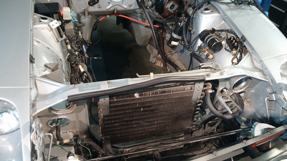

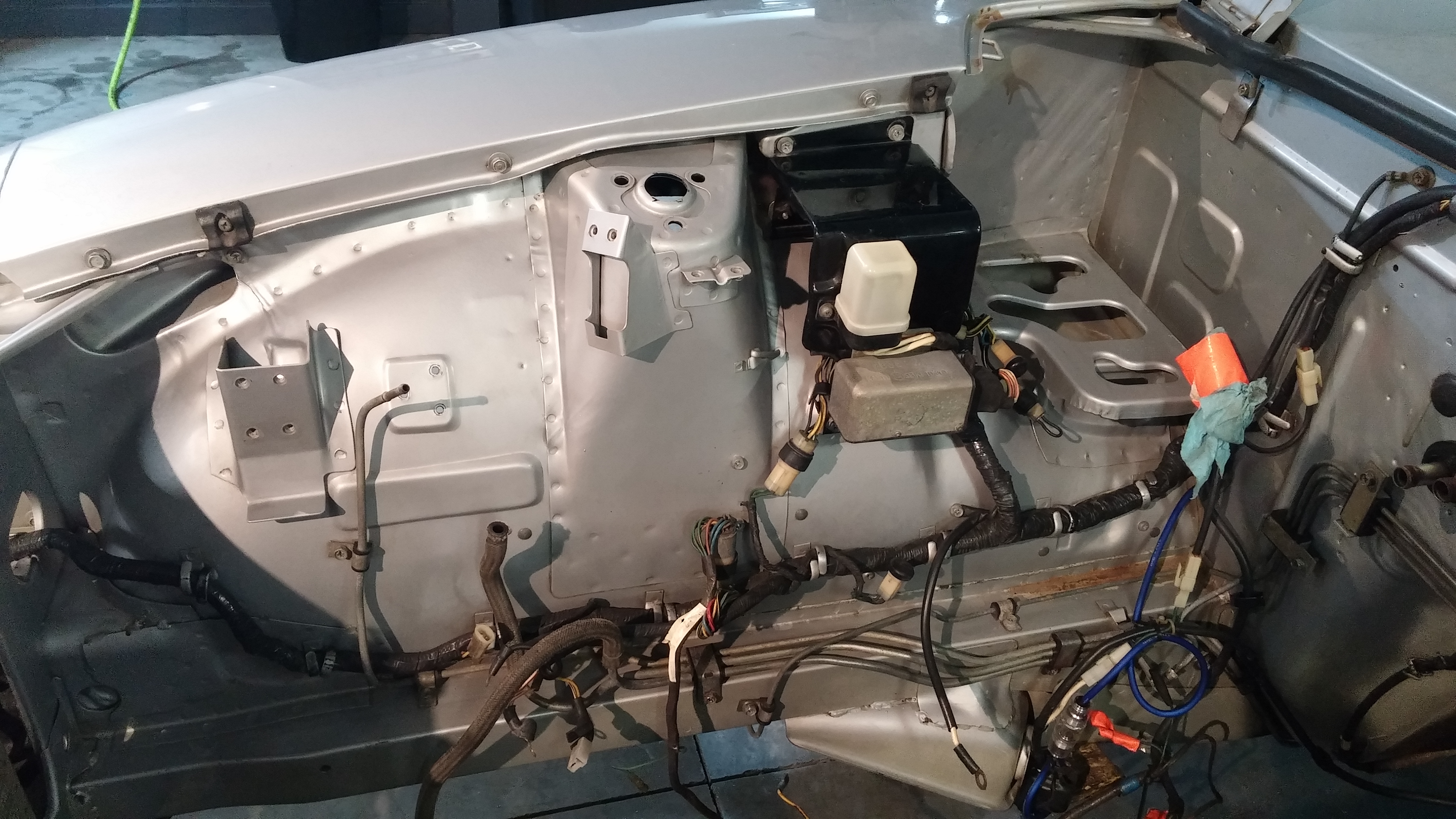

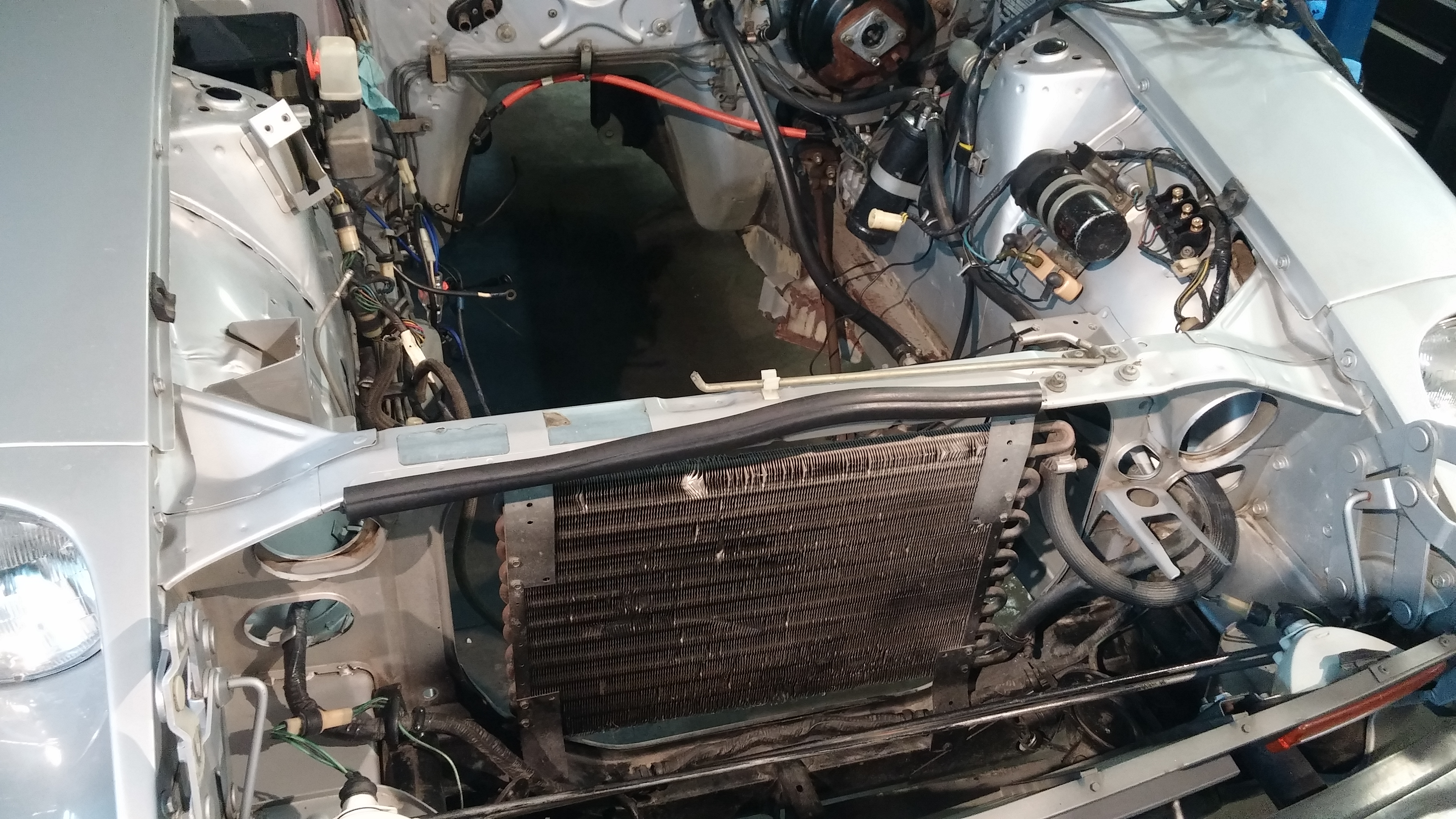

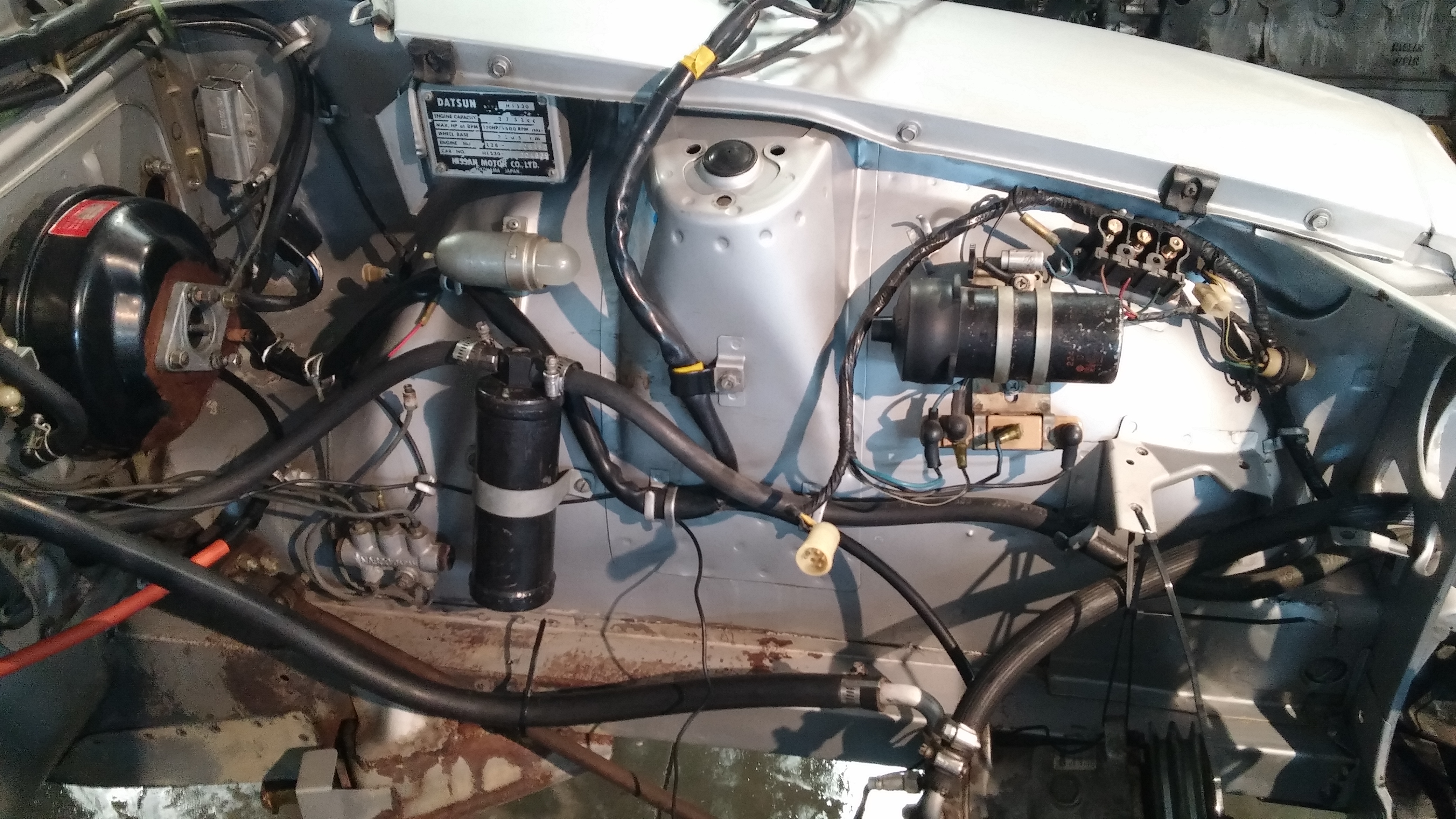

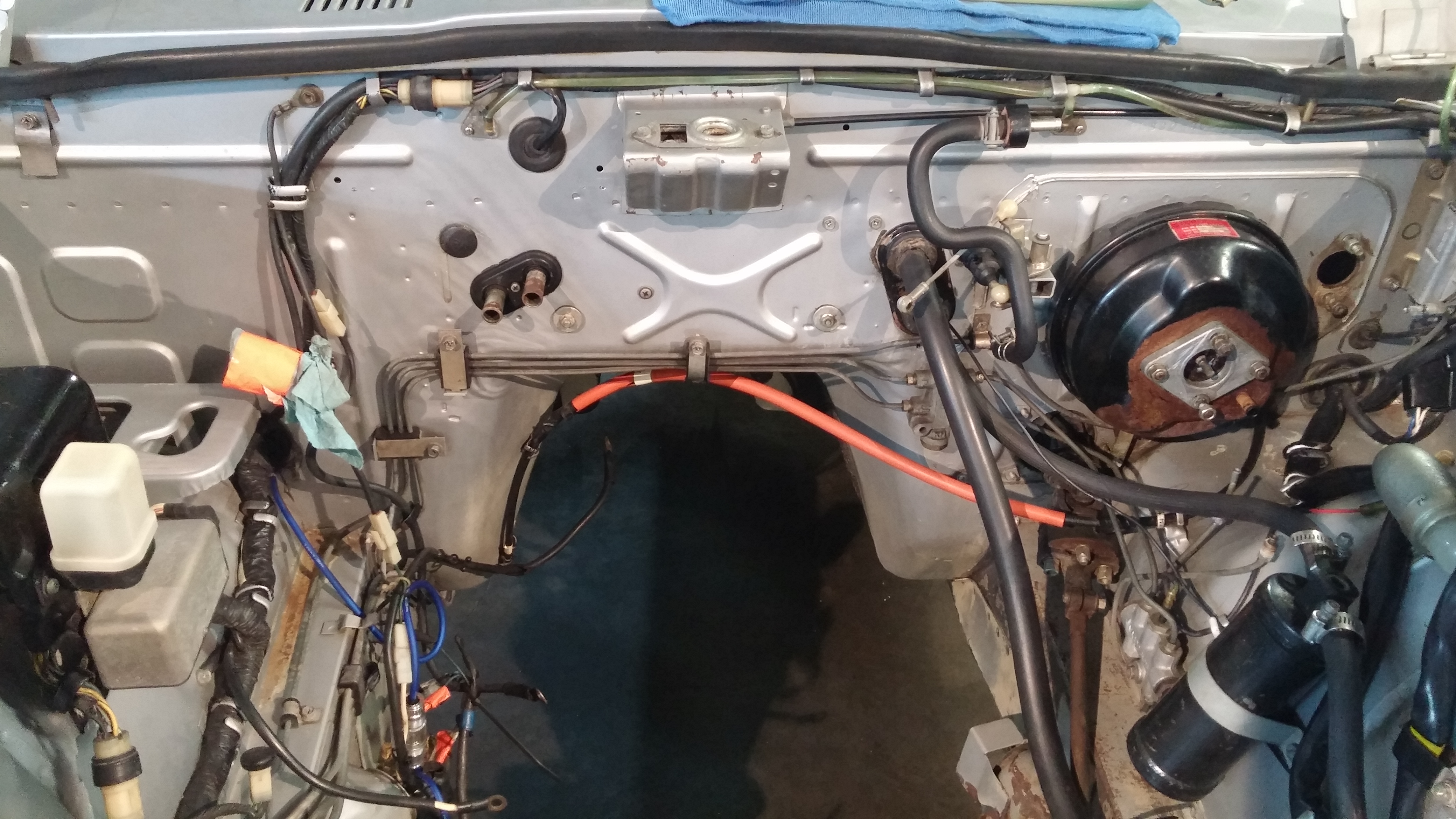

Here are some pics from todays efforts, I should post a picture of my bloody busted knuckles.
Opinions on my drivers side frame rail would be appreciated. I don't know if I should go back silver or black it out. I think silver would look detailed and would be easier to do??
I will detail the bay and components more once its back together and everything is where it belongs.
I don't have anything to add about the suspension work, but from looking at your brake booster, it's clear that you had a master cylinder rear seal failure at some time in the past. And if that's the case, it's likely that you've got old moisture laden brake fluid festering inside the booster eating the paint and rusting the metal bits. The longer it's in there, the worse things will be.
it being dry when you removed the master cylinder means that someone, prior to you, has already replaced the failed master cylinder. That's good. And depending on how quickly they noticed and addressed the issue, your booster may not have sucked in a lot of fluid.
You can check for fluid inside by pulling off the aluminum parallelogram where the master cylinder mounts. Then pry out the vacuum seal and remove the output shaft (the part that pokes the master cylinder). Once you have that output shaft out of the way, you can look inside and see if it's wet. Maybe stick a paper towel in the hole and reach around to see if it mops up anything?
If the paint inside isn't peeling, and the spring is all shiny like, then you're probably OK.
And then you can spent an hour or more trying to fish your reaction disk (which fell out of place when you removed the output shaft) out of the clamshell.
Haha, right you are! Glad to help. Unless you're in a hurry though, I'd suggest you give it a day or so to see if anyone else chimes in with simpler / better ways to check for fluid inside there? Fishing that disk out is a PITA.
