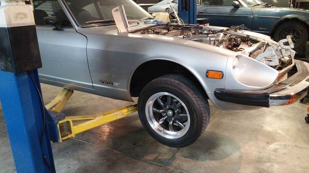

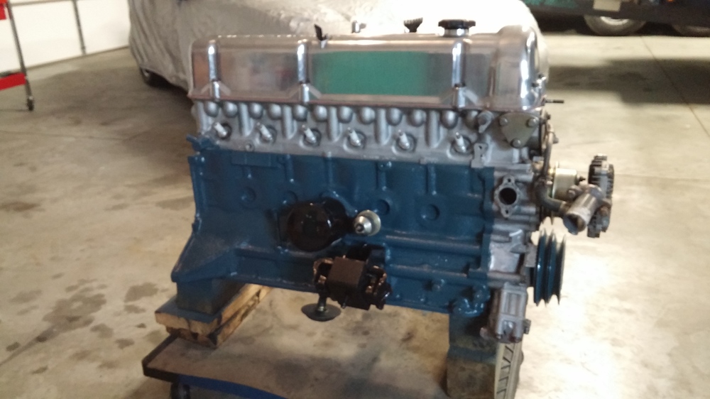

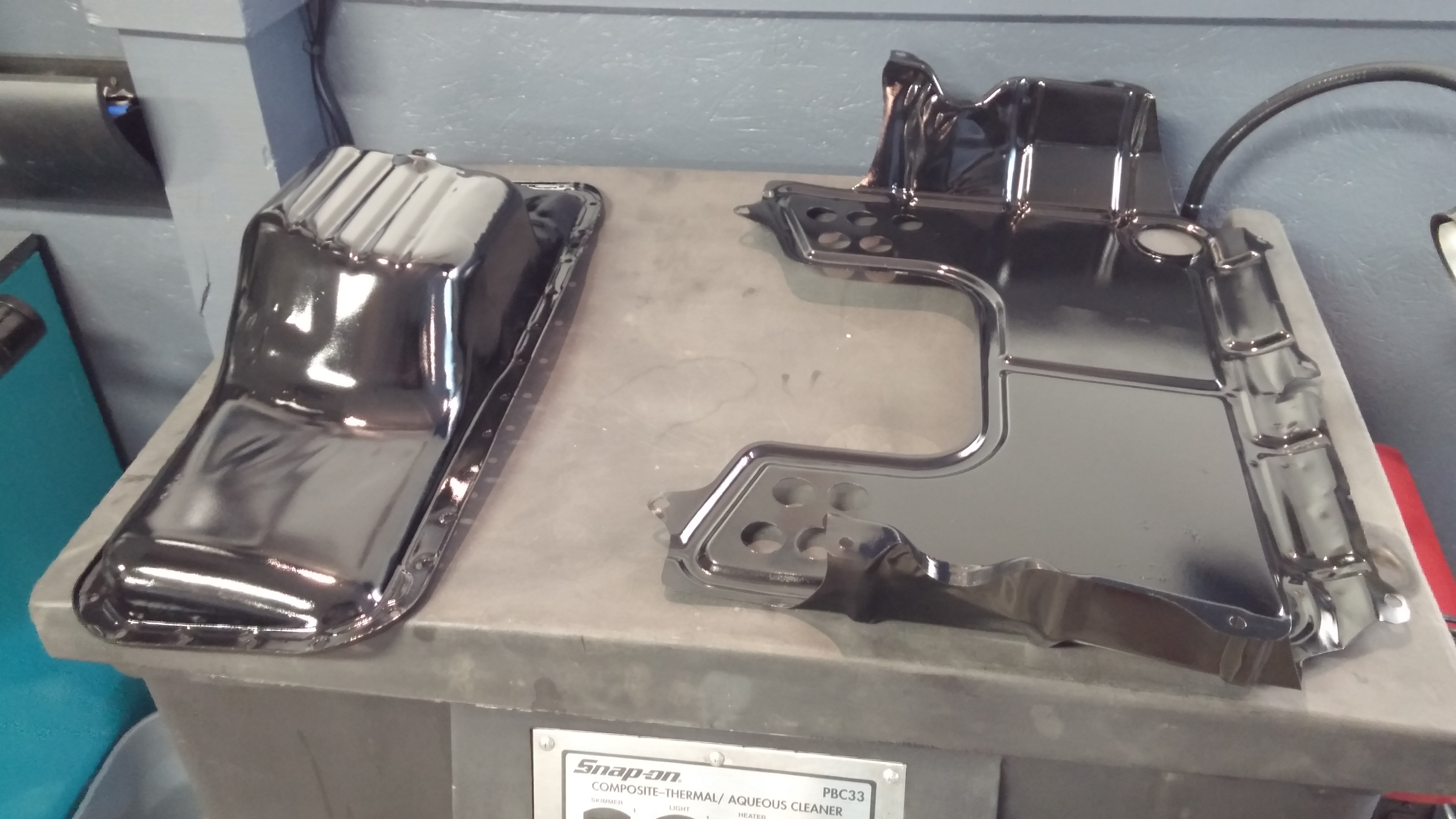

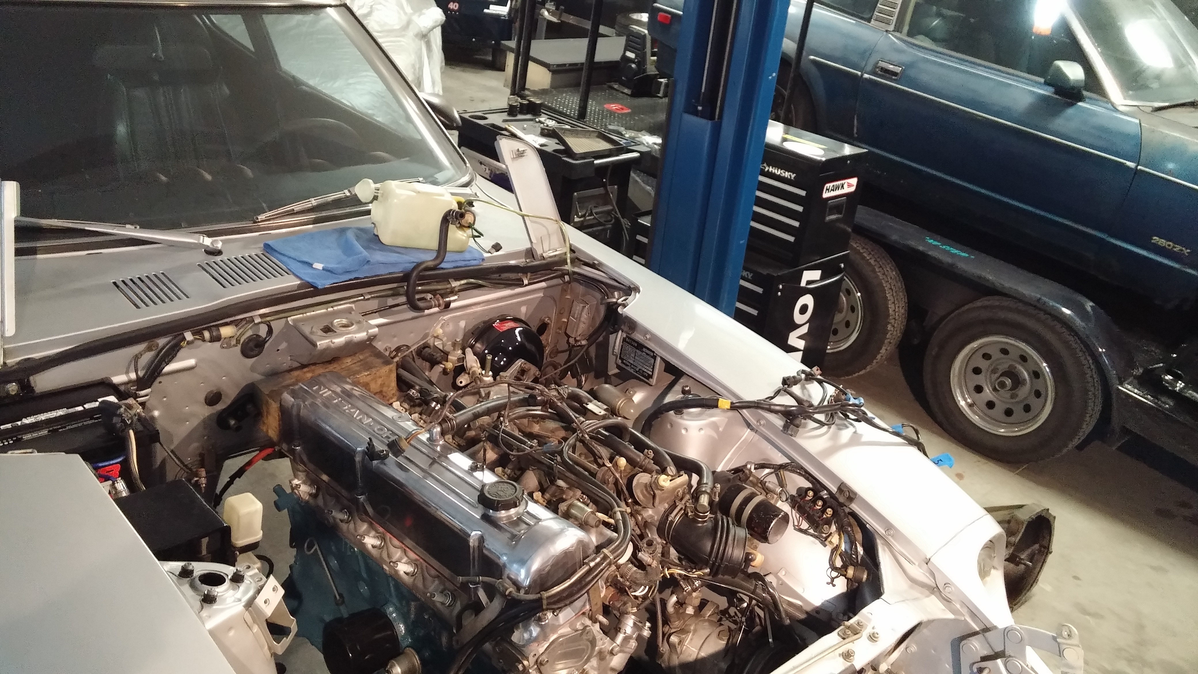

Don't get excited about the oem mustache bar bushings! I have stalled my project 2 wks waiting on them and now I have been informed they are on national back order. I saved a few bucks on the prothane kit on Ebay, but by the time you have to order the rack and pinion bushings from Energy and deal with time lapse and frustration.... not worth it. The Energy suspension rack and pinion bushings fit perfect. Heres the last few times at the shop progress. More cleaning and painting... belly pan, engine, oil pan, headers (baked also). Got intake and headers on before dropping motor in, also hung a new 15" Konig Rewind mounted on Yokos.0209172152.jpg0209172152a.jpg

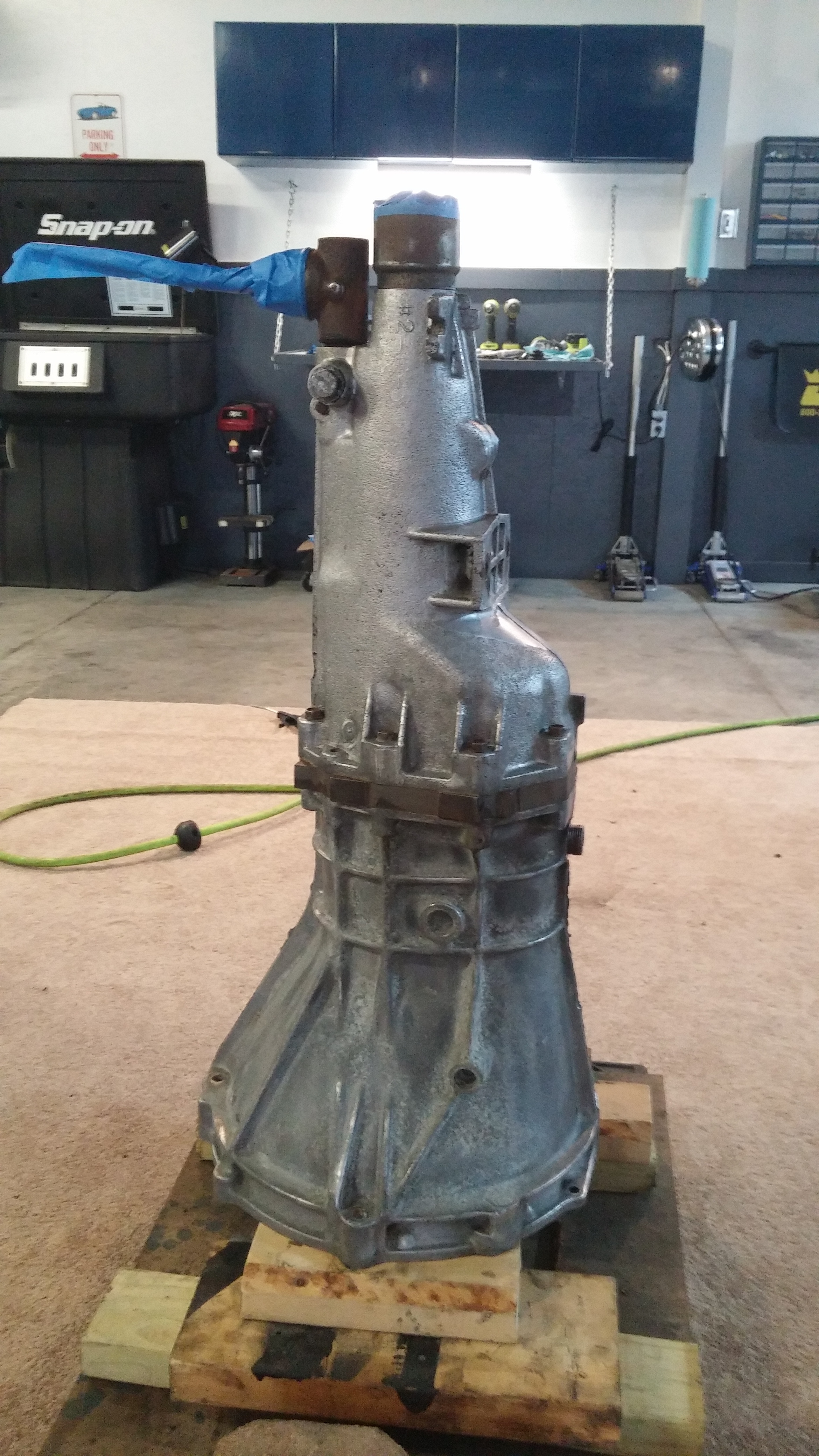

Is the 280 worse for noise and vibration then a 240? I have had the Energy suspension bushings in my 70 for 4 years now with lowering springs and have not found anything more than just a stiffer ride and more bumpy, no diff or tranny noise or vibration though. Would anyone recommend a worn out set of Mustache bar bushings over new urethane? Just wondering. Had a good day or so working on my labor of love. Had to get project off rack and p.o.s 79 on rack for transmission removal, pain. The 79 looks really bad, I hate to think I'm taking a part off this thing and putting it on my build. My buddy assures me the internals are better then the externals. I forgot to take a before picture but the process was as follows. Spray down with Gunk engine cleaner, 10 min later, spray down again, pressure wash trans, dry with torpedo heater, hand clean with degreaser a brush and rag. Next, I used my drill with a wire wheel and went over entire case, blew clean, wiped down with Prep All and put 2 coats of primer on. Turned out really nice and is ready for paint. I am thinking the burnt black coffee crap I drained from the transmission must have been in there 30 plus years. I'm leery but it shifts nicely into all gears including reverse. Oh' I noticed the drain plug had a little bit of shavings stuck to the magnet, I'm sure that's not optimal. I'm going to look around and see about flushing a detergent/cleaner through it, not sure if that's a thing or not?? Threw in the second picture just for kicks, I like pulling in to the shop and seeing Z nostalgia!!
