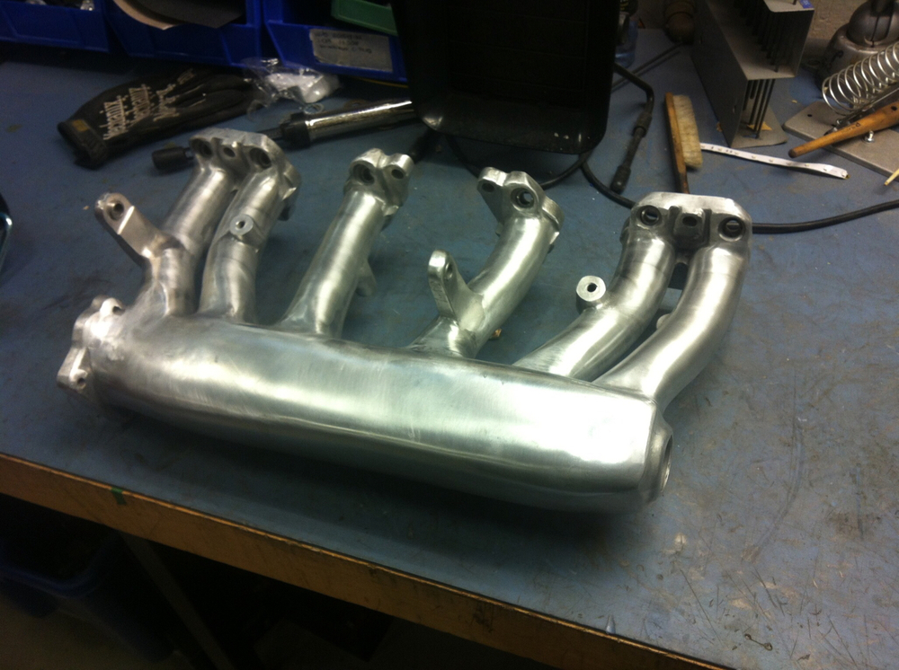

77 still used the three part fuel rail, consider using a 78 or a ZX rail, or aluminum.  Search "heat soak" and/or "hot start" problems before you get too far along.
You might break some thermostat housing bolts also.  They tend to rust in place and break in the middle though.  Injector mount bolts break too.  And exhaust pipe flange studs.  Lots of breaking and stuckness.  Check the manifold surfaces for flatness.
