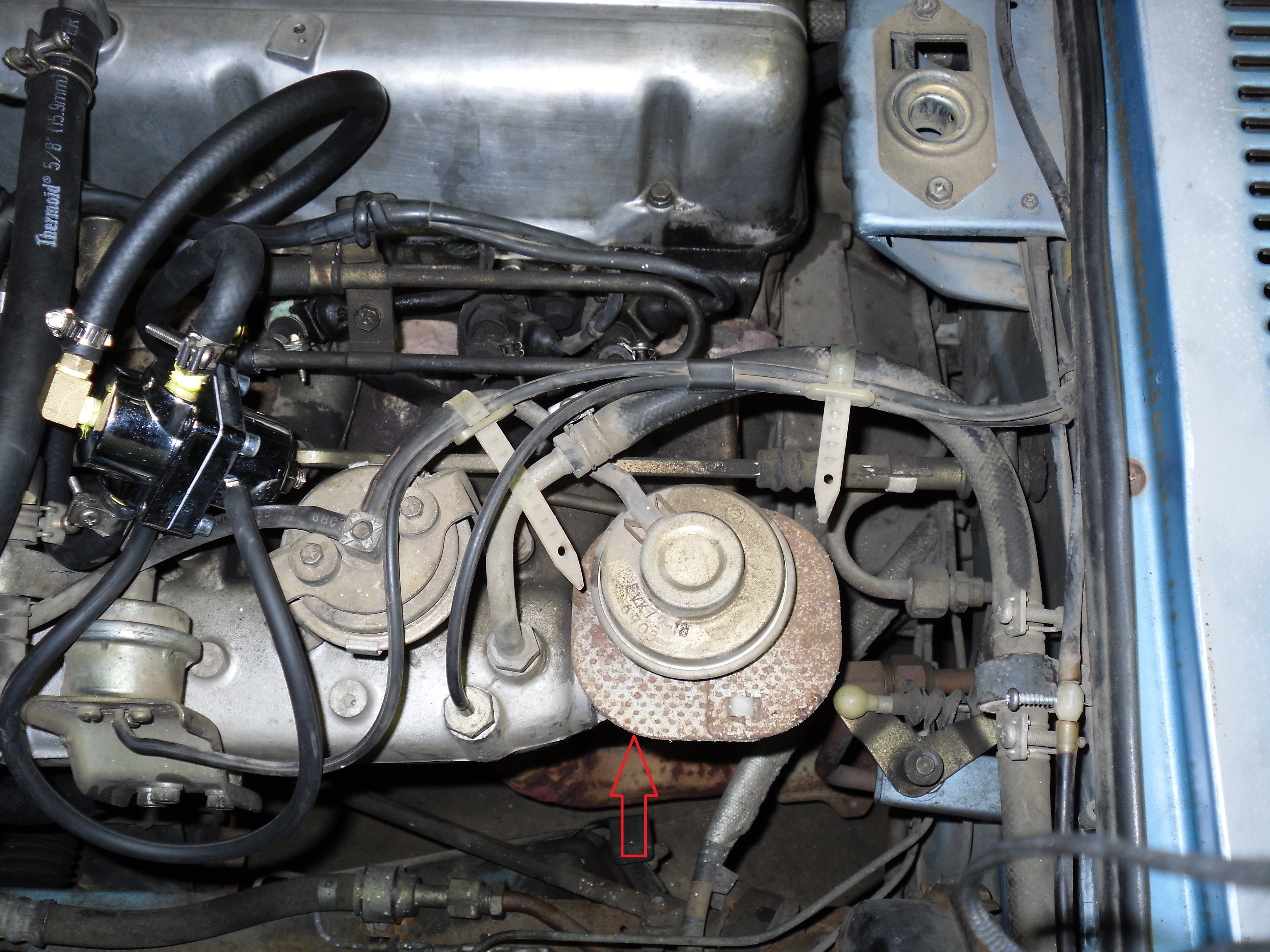

Sounds like a lean condition, a vacuum leak somewhere, if it's popping through the engine compartment.  In 1977 they had a recall on the EGR coupler to the rear of the intake.  If that wasn't fixed, mine was not, the exhaust from the EGR tube will rot out the aluminum intake leaving a hole for unmetered air to enter causing the air/fuel mixture to be lean.  You can borrow a vacuum gauge from a parts store and see what kind of vacuum you're pulling.
http://atlanticz.ca/zclub/techtips/airleaks/index.html

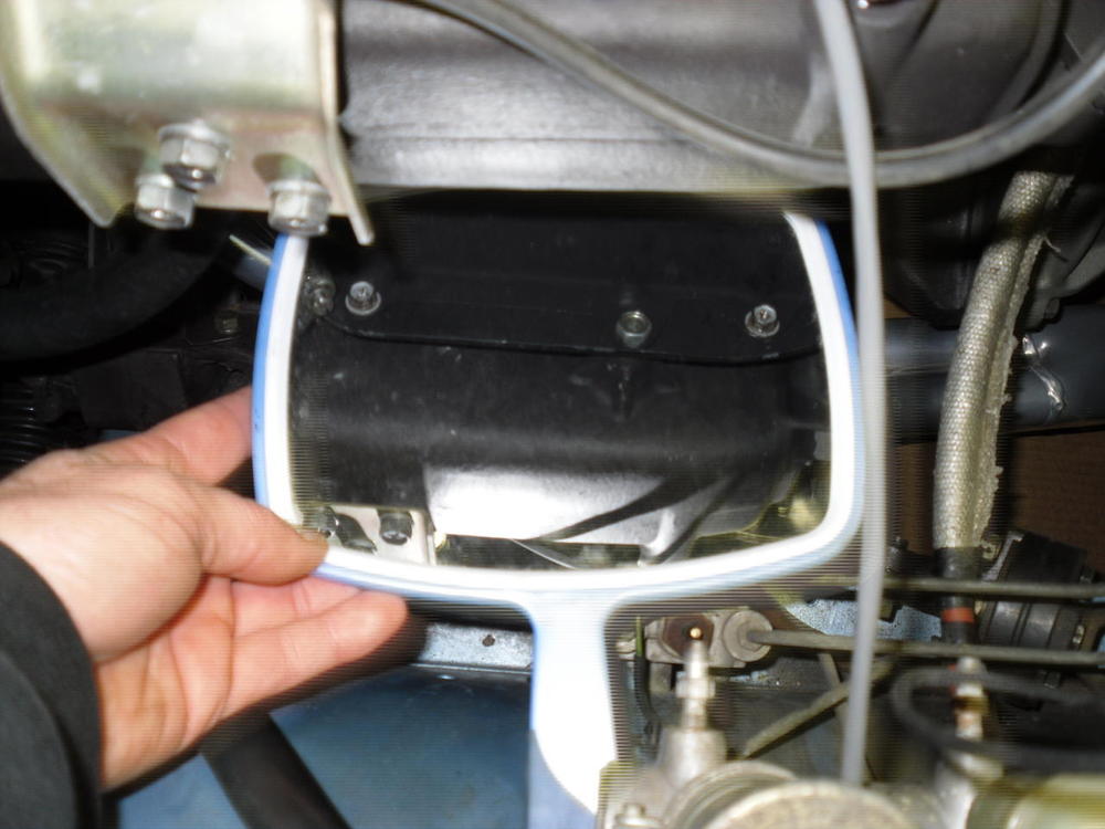

To check the recall area for rotted aluminum hold a mirror under where the red arrow is in my picture, quick and easy to find but a whole can of worms if it's damaged.
