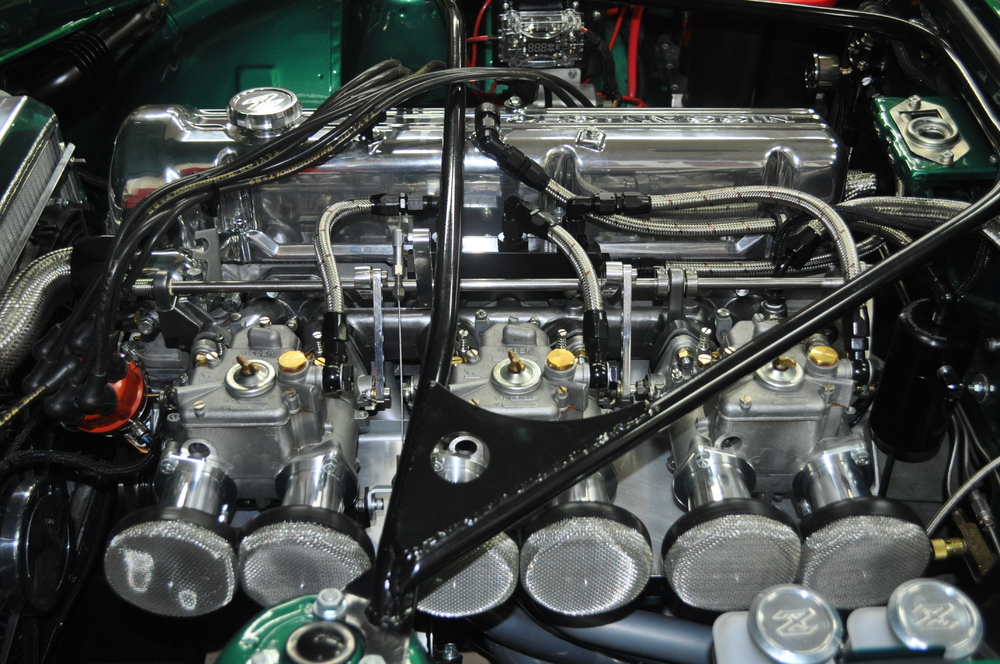

I removed mine completely.  I ran a SS line directly from the electric fuel pump at the back all along the frame rail (where the original fuel hard lines were located), up the firewall on the passenger side and this terminates in a FPR which is mounted to the firewall.  I then run the output of the FPR to a small fuel rail mounted on the side of the head.  I run triple Webers and so your install will likely be a little different, but I have had no unusual side effects with removing the canister.  I also had the canister bracket removed and the attach points welded up before I had the engine bay painted.  This really helped to clean up the engine bay a lot.  Also did the same thing with the vacuum canister.

There are two ways to do this.  I chose to deadhead my installation meaning that the FPR is before the fuel rail and I do not use a return.  The return line is removed and blocked off at the tank.  The alternative is to use a return line with the FPR after the fuel rail.  If you choose to go this way you need to make sure that you source a FPR that was intended to be used with a return.
Either way should work.  I have had zero issues with the setup I have now.  I've attached a picture so you can see my setup with the small fuel rail in the center.  If you look over at the passenger side firewall you can see the side of the fuel pressure gauge which is attached to the FPR.
