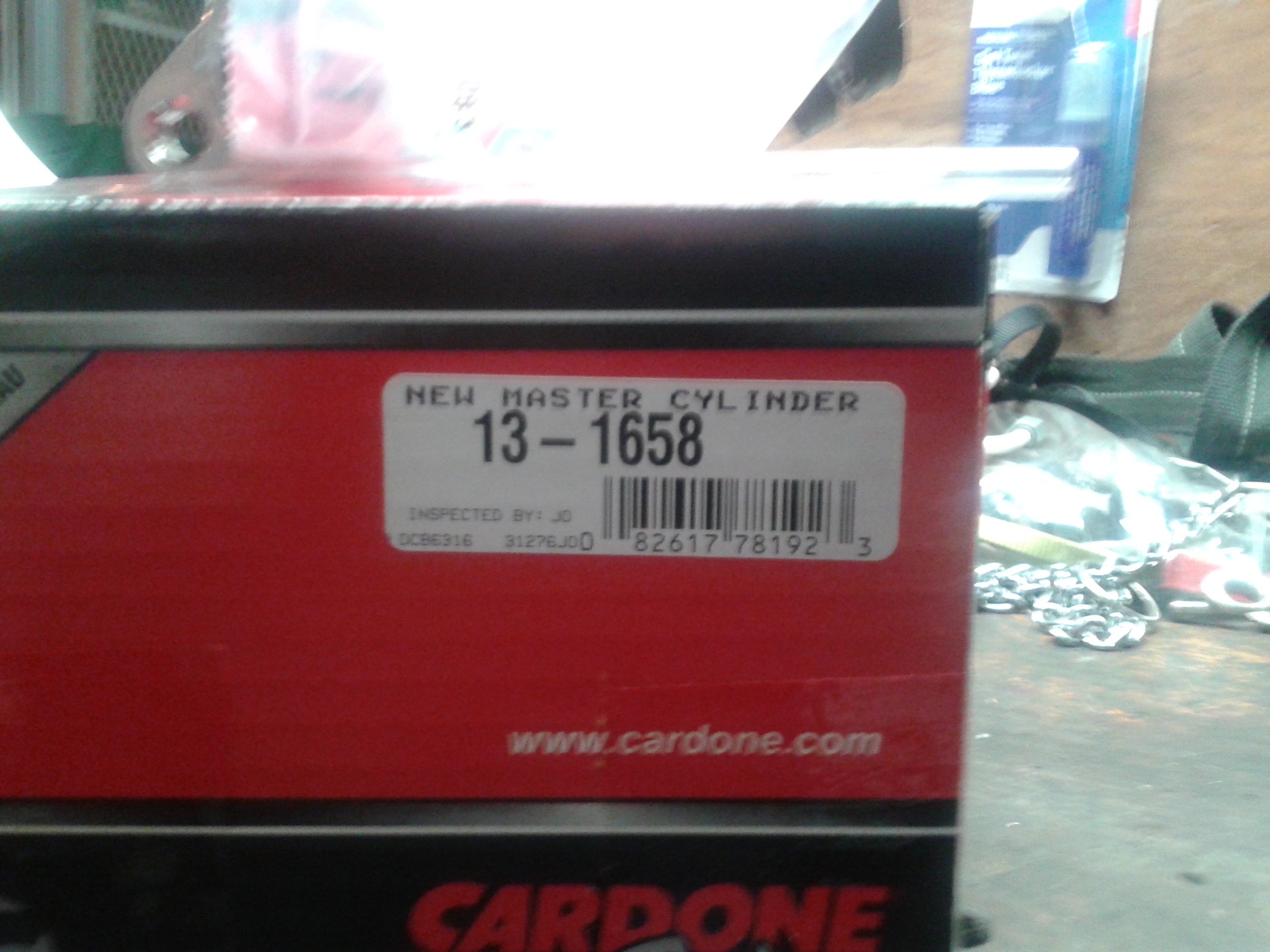

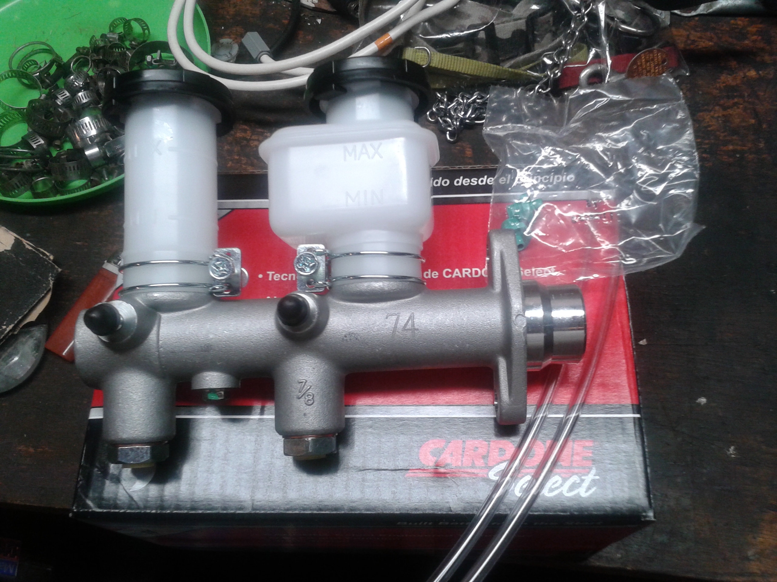

I just bought, it's on the truck for delivery today, a MC from rockauto.com.  $47 delivered.  It is a Cardone #1368 maybe?
found it, along with the booster.  I'll probably need both.  good to have another option, MSA wants to charge an arm and a leg plus hefty core charge

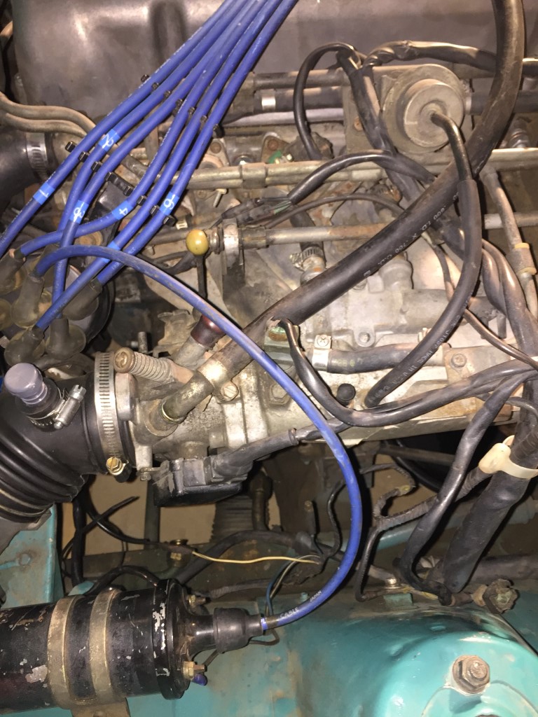

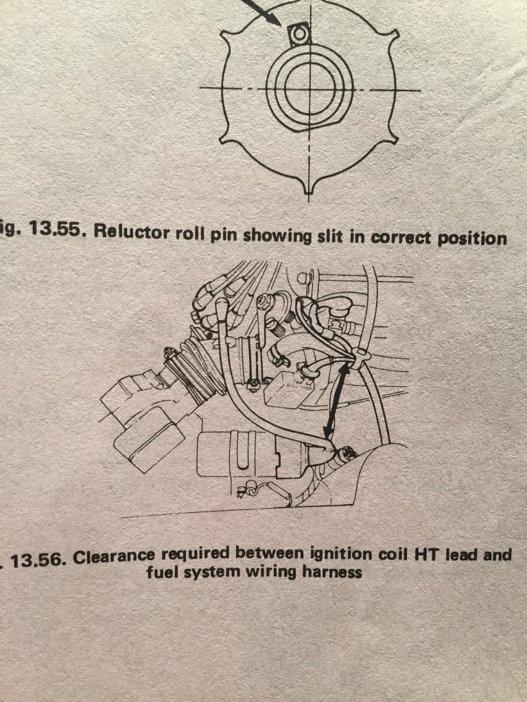

my next question - is the routing of my ignition coil wire close to the EFI harness and CSV an issue?  next i'd like to temporarily re-route it and try firing it up

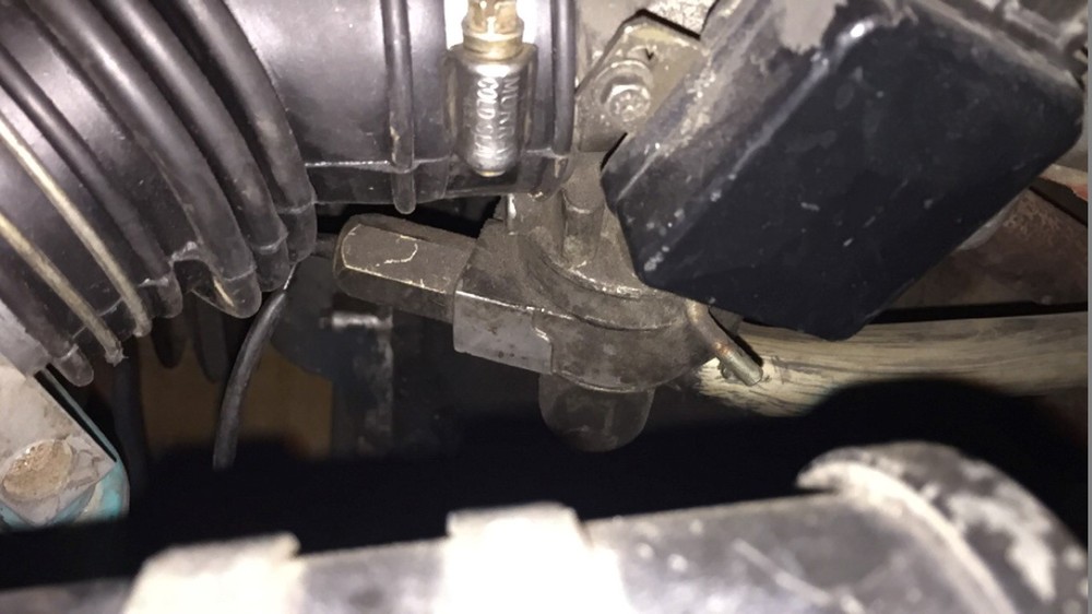

If you feel underneath the throttle body the large cone shapped device is the BCDD. That is gone completely or or are the lines just capped and the wire removed.
Funny, I've only seen the philips head in the TB as the adjusment screw. I recall seeing it as a flat head in the FSM though.

Couple comments:
That throttle speed screw looks like everyone I've ever seen.
If that pic is recent, you still have a BCDD. I can see the wire is still connected.
I assume you capped the AAR port on the top of the TB? Looks like it's open in the pic.
