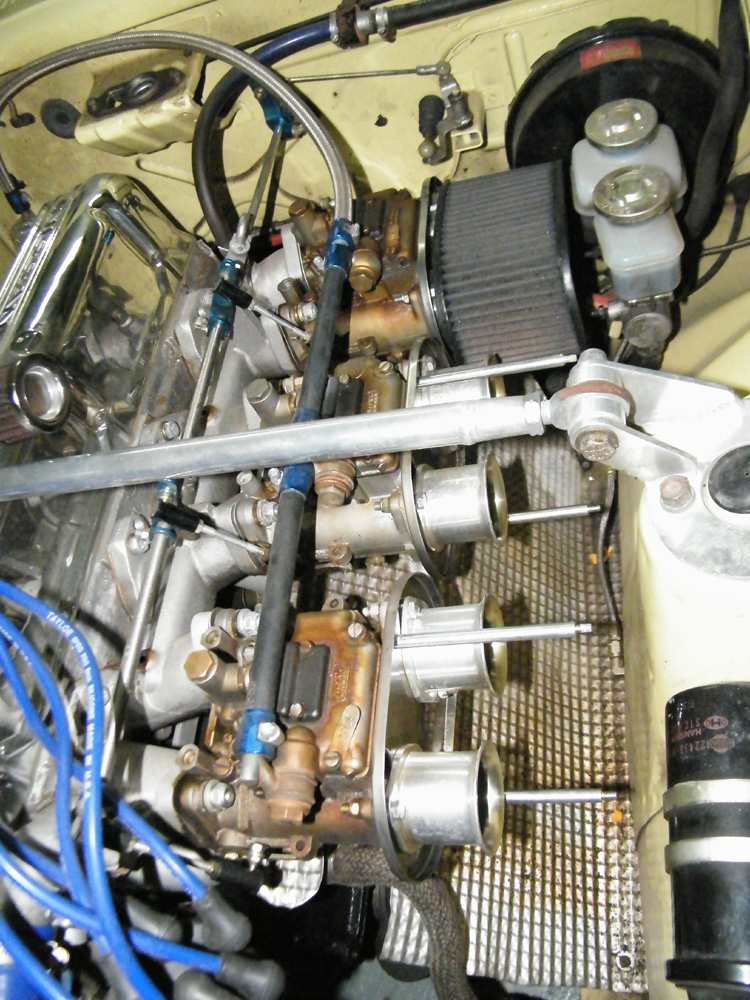

Spirit Garage header to tailpipe system is on the car.  I decided to replace all the head studs so that slowed be down a bit, the MSA kit I used previously I was not overly happy with so I went to Nissan, all good to go.  In my case the header's first primary did indeed contact the steering shaft so it had to be worked for clearance, it is likely designed for a RH drive car, understandably.  The crankcase breather has to be cut down and tapered for the header to fit or you can use one off a 280.  The rest of the kit's fit an finish is awesome and it is tucked up nicely.  I have an '87 Turbo CLSD R200 and the pipes fit around it without any issue.
One thing I haven't resolved yet is a heat shield for my SU's...the stock heat shield was already cut in one spot to fit the Stahl and unless someone can direct me to a better solution, it seems I will have to so a bunch more cutting and bending again so I am open to any suggestions.  I have searched and searched but all that seems to be out there are ones for triples...thanks guys.
Edited by ollie
Nice update - thanks.
This stuff works very well from top to bottom : https://www.demon-tweeks.co.uk/motorsport/heat-shielding-protection/nimbus-gii-heat-shield ok, it'll hide your new, shiny header but what counts is that all works well together. The next step forwards for more performance is to completely isolate the intake side from the radiator pushing hot air into that side !
