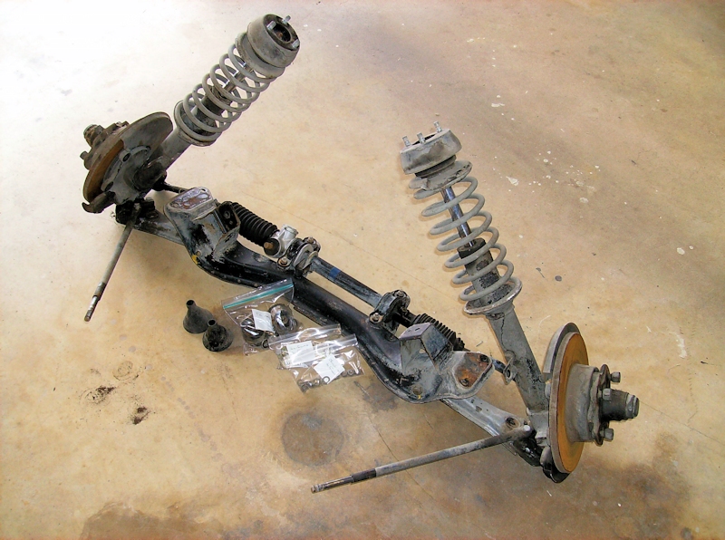

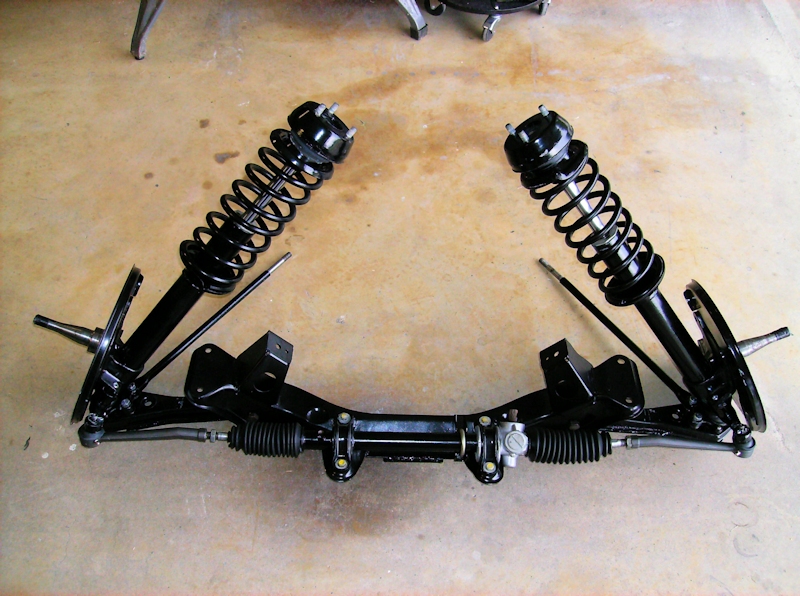

If you support the engine (not directly on the pan), the front suspension easily comes out as a unit and goes back in easy-peasy.  These pics were taken with my engine and transmission already out but the principle is the same.  Some long blocks under the edges of the pan would work, or an engine hoist to lift it just a bit would likely be the best approach.
Don't bother cleaning and painting. Take everything apart and take it to Coating Concepts in Carlisle to have it blasted and powder coated. They did my race car suspension and ceramic coated my header 5 years ago and it all still looks great.
